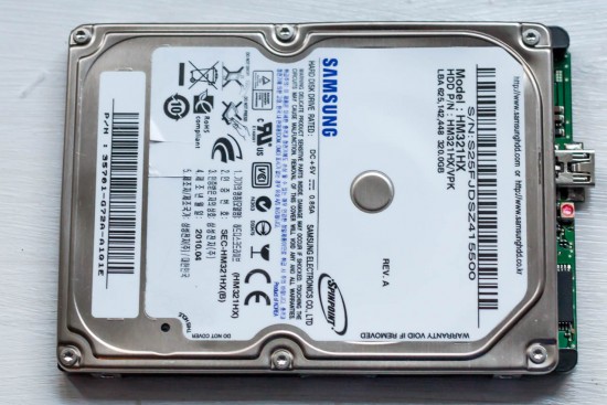

I have not working disk Samsung HM321HX. This is USB 2.0 disk. At the moment disk not working, only hear strange noise, disk not spining, diode blininkg. First I think, that head part on the plater, but after open disk in clear room, head parked normally.
On this link I record noise from disk:
https://www.youtube.com/watch?v=QYatGX5wmsA&feature=youtu.be
Could you help, what could be a problem?

It's look like hdd cap is bent into drive and it keep spindle from spin up.

Did you try turning the platter by hand?

Yes I tried. Platter spin without any problem. But In fact cover disk is a little bent.

After when I straighten cover disk start spining. So the problem was with cover which brake motor.
