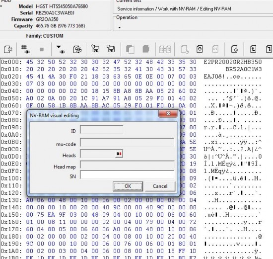

I seem to be getting a few of the same issues with these drive, ie not reading the PSHT and not being able to load it into the RAM. However I can normally edit the NV-RAM. This drive is a little different. I can open the NV-RAM through Service Information Objects in PC3K but cannot edit it. Is this normal or am I missing something obvious?

Why custom? Choose 5450A7 and detect super on. Under custom it would be like this.
 Post subject: Re: HGST HTS545050A7E680
PostPosted: September 24th, 2016, 19:27
Posts: 1777
Location: Phoenix, AZ USA
Didn't notice that. Thanks.
