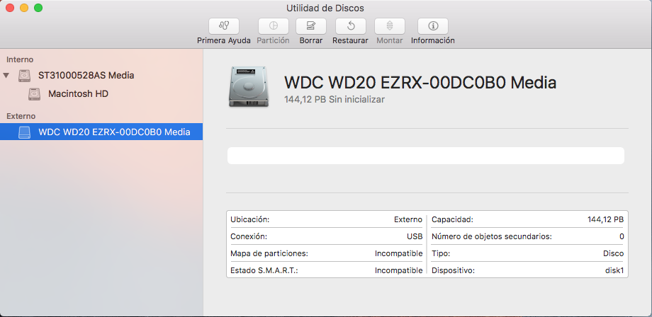

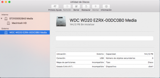

 Post subject: Re: WD20EZRX-00DC0B0 recover?
PostPosted: January 10th, 2019, 8:16
Joined: January 9th, 2019, 8:49
Posts: 6
Location: Spain
And this is how it shows from MacOS disk utility.
144 PetaBytes and won't initalize anyway.
Thanks!!
PostPosted: January 12th, 2019, 7:58
How is it detected in BIOS?
Correct capacity?
PostPosted: January 12th, 2019, 14:18
Posts: 6
Location: Spain
No problem. HDD does not contain important data.
It cames from a WD myBook Studio II raid 1 enclosure. It is the A disk.
Thanks!
PostPosted: January 12th, 2019, 15:18
Posts: 6
Location: Spain
Noooo SD RAID software mark it as defective and it is wrong-recognized attached directly to SATA cable or through USB box to Win or Mac system.
System detects a 144 PetaBytes disk. ????
I'am considering a broken head or other hw issue.
Thanks!!
PostPosted: January 12th, 2019, 22:18
Posts: 291
Location: españa
Well, this would be expected.
Then, throw it in the trash and if you need the data, recover from the other RAID 1 disk
