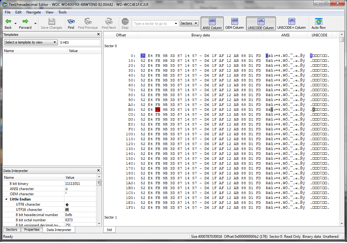

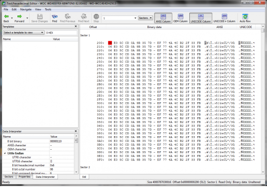

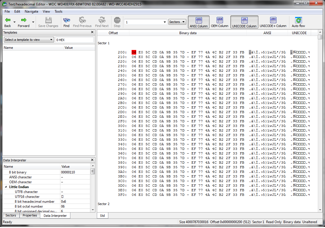

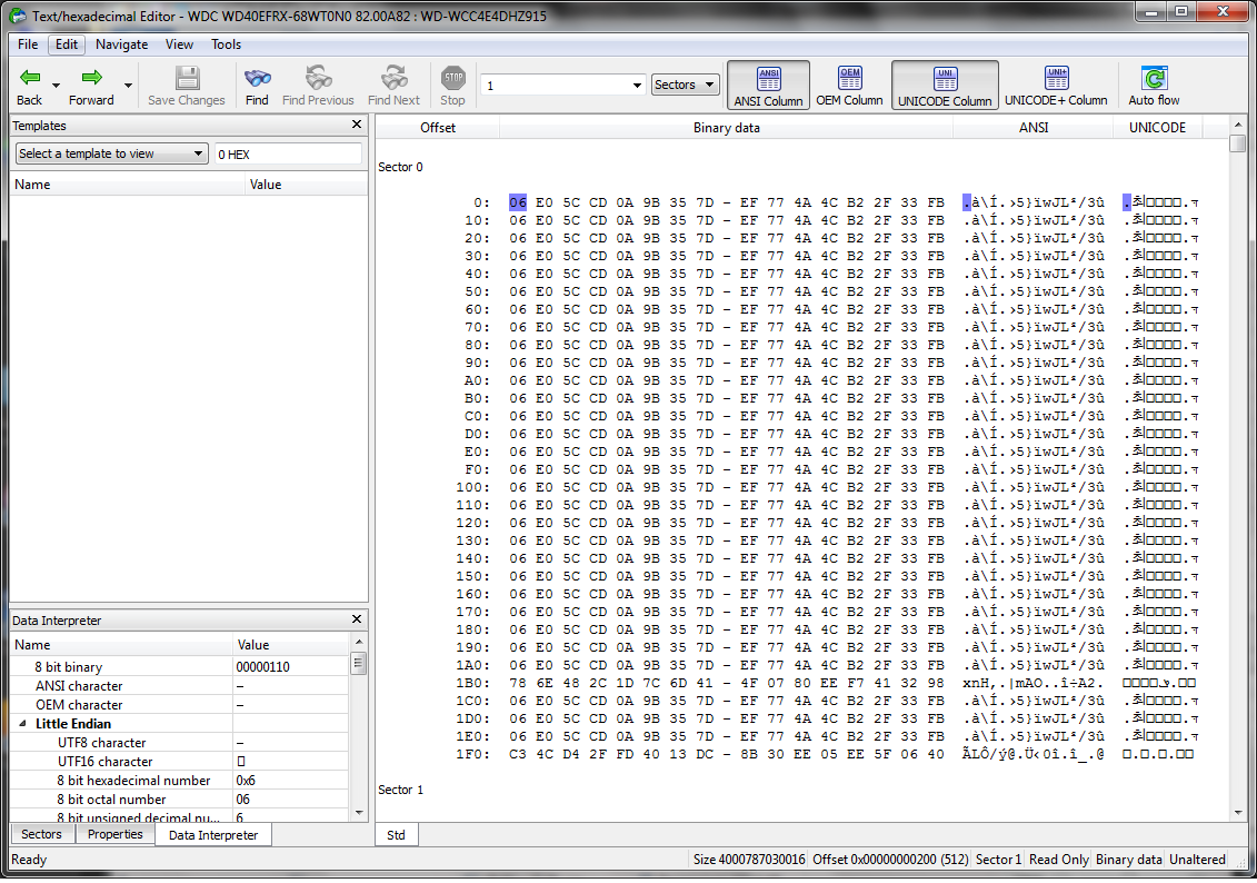

I have a WD My Book Duo WDBLWE0080JCH with 2 x 4TB Red Drive. It's original configured in RAID1 but for a mistake i force reconfigure it (again to RAID1) from WD Utility. After 20 second configuration complete but data partition is empty. Ok, i try with R-studio like other disk after formatting but absolute nothing is found. Check with hex editor seem that is all garbage on it except first some and end sector, take apart disk garbage is identical on both disk. Is encrypted but with different key? I try to put 2 new blank disk inside MyBook and load some sample data, every time i reconfigure raid and write sample data again is written different, is possible that encryption key change every time ? there is no unique key stored in firmware ? there is any chance to recover original data or is all lost?

Can you please show us sector 0 and sector 1?
 Post subject: Re: Recover From My Book Duo
PostPosted: September 23rd, 2016, 3:03
Joined: September 23rd, 2015, 9:25
Posts: 47
Location: Italy

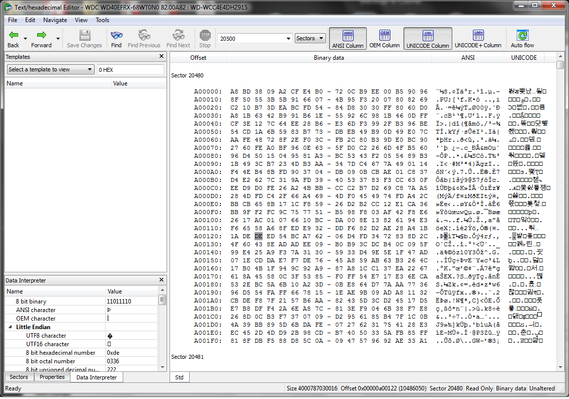

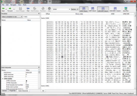

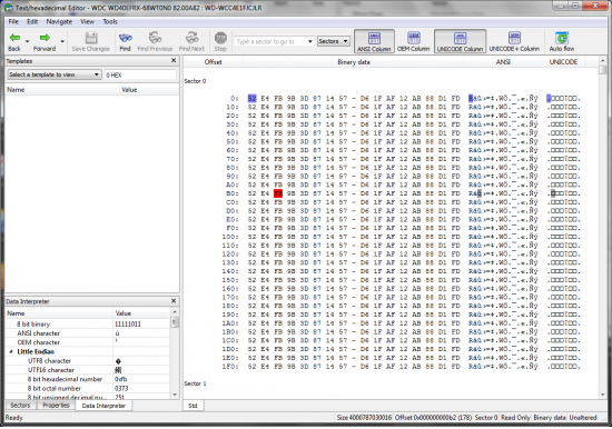

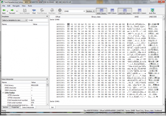

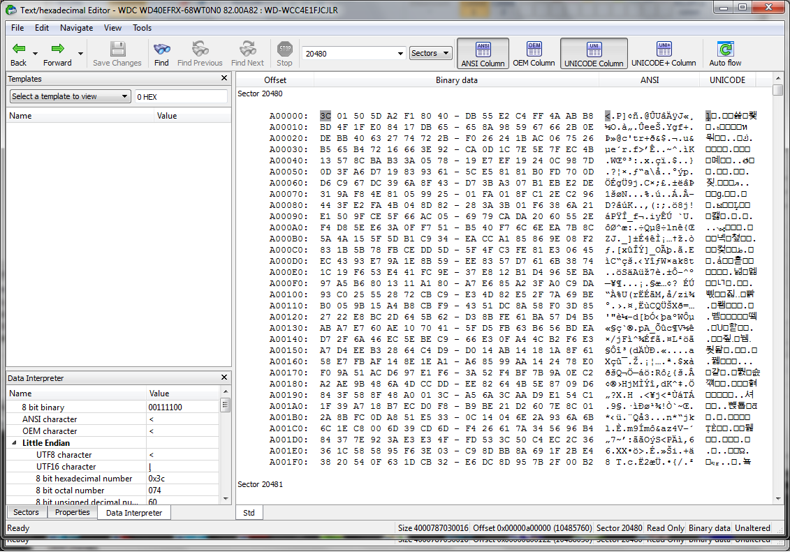

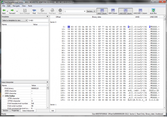

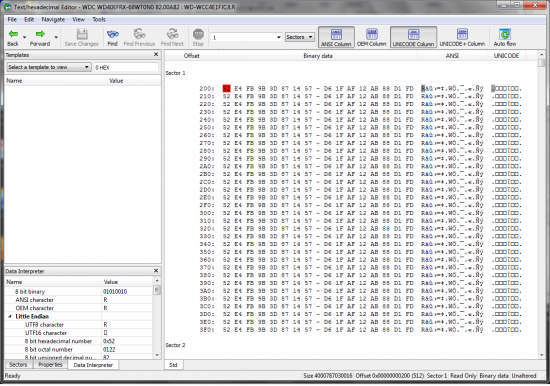

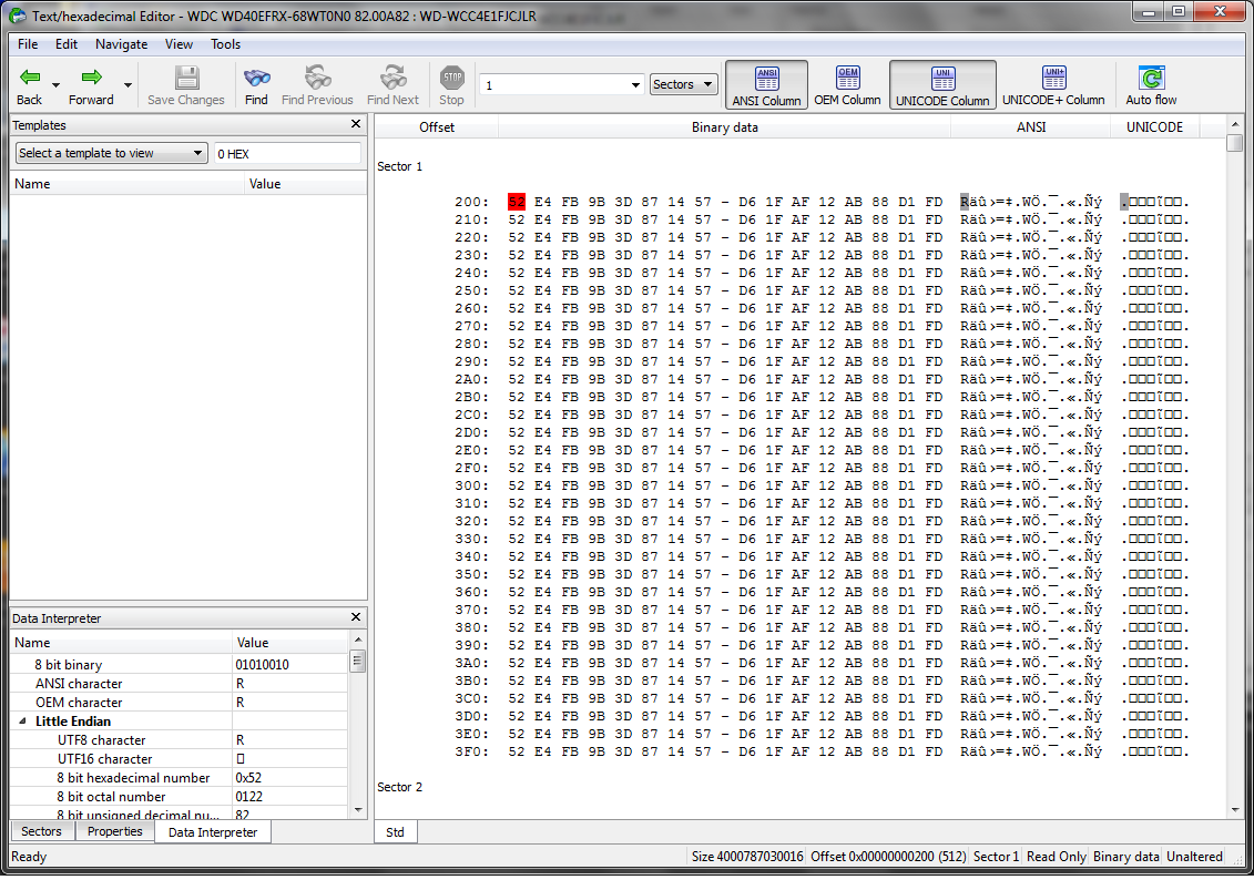

sure, this is sector 0 and sector 1 plus sector 20480 the first seem contains data
File comment: Hdd 1 Sector 20480
File comment: Hdd 1 Sector 1
File comment: Hdd 1 Sector 0
File comment: Hdd 0 Sector 20480
File comment: Hdd 0 Sector 1
File comment: Hdd 0 Sector 0
PostPosted: September 23rd, 2016, 3:15
Posts: 1091
Location: Angel Data Recovery
Once you reconfigured hash changed , and it is now encrypted different way. There is a chance if you saved SA from one of two drives before doing reconfiguration. Did you?

maxisvk wrote:
no, not save. from actual data on disk there is no way right, maybe also to prefessional service ?
If you're lucky there could be a way from actual data only.
Can you please search for the following signatures (in Hex Format) at the end of the drives:
First: 57 44 76 31
Second: 53 59 4D 57
3rd: 53 49 6E 45
4th: 57 44 01 14

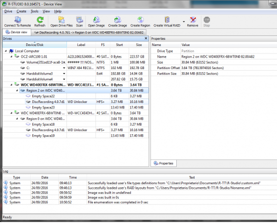

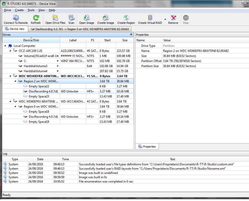

not found this string, at end of disk i found wd unlock partition
The HEX-String must be there somewhere (in my opinion) but maybe I'm wrong.
I see that 4 TB are a large space for searching... but the signatures should be there.
Did you search them as a hex values?
If you cannot find them... you could try to save all modules with hddsupertool.
You need a HEX-Editor... the sector view should look similar to the pictures of sector 0 and 1 you have uploaded.
Not like the picture of R-Studio you have shown.
Then you have to go nearly to the end of the drive (>90%) and search for the mentioned hex values.
Maybe someone here knows the exact locations of the key sector on a 4 TB model.
So you would not have to search for the signatures, you could jump to the correct sector straight forward.
You only need to show the correct sector, like you showed sector 0 and sector 1.
But this time the sector number is much higher than 0 or 1, it should be 7730941132 or higher.
I hope I have explained it simple and understandable :)

PostPosted: September 26th, 2016, 16:13
Posts: 17323
Why not begin at sector 7813974016 and save all the sectors from this point until the end of the drive? Then upload the BIN file as a ZIP. Hopefully the BIN will contain the key sector, if it exists.
PostPosted: September 27th, 2016, 9:32
That looks to me like it's just the SmartWare partition. Is the drive direct SATA connected?
