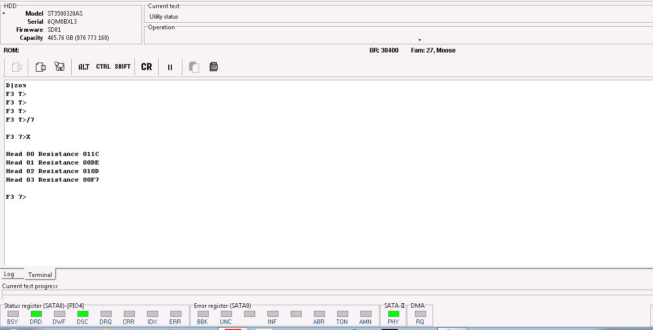

HDD is old faithful 7200.11 MOOSE
. Its FW seems to be almost 100% OK

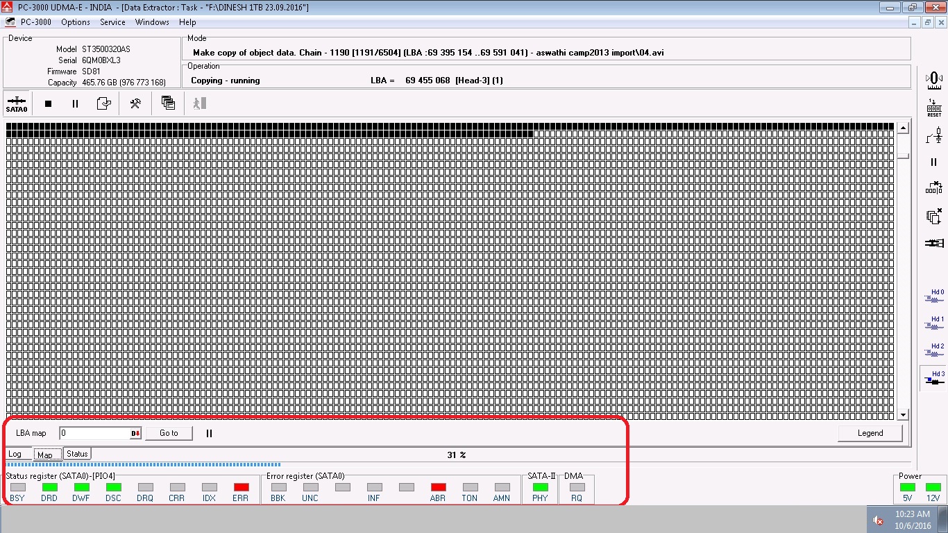

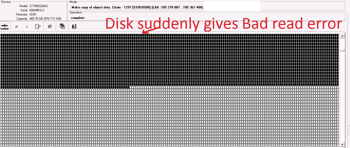

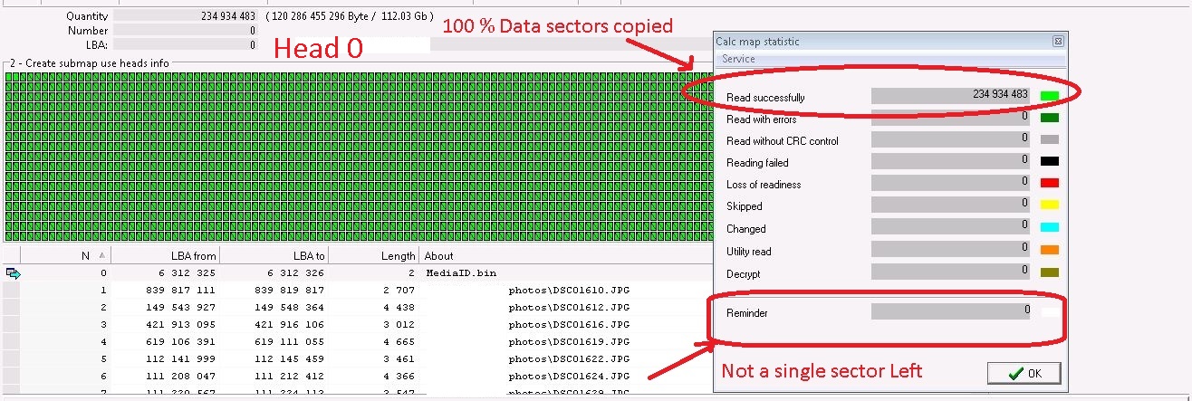

Customer was unaware how disks work and they are going to die one day. He has backed up all family photos videos in this external usb disk which is crashed.

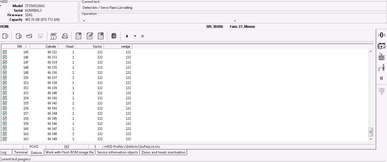

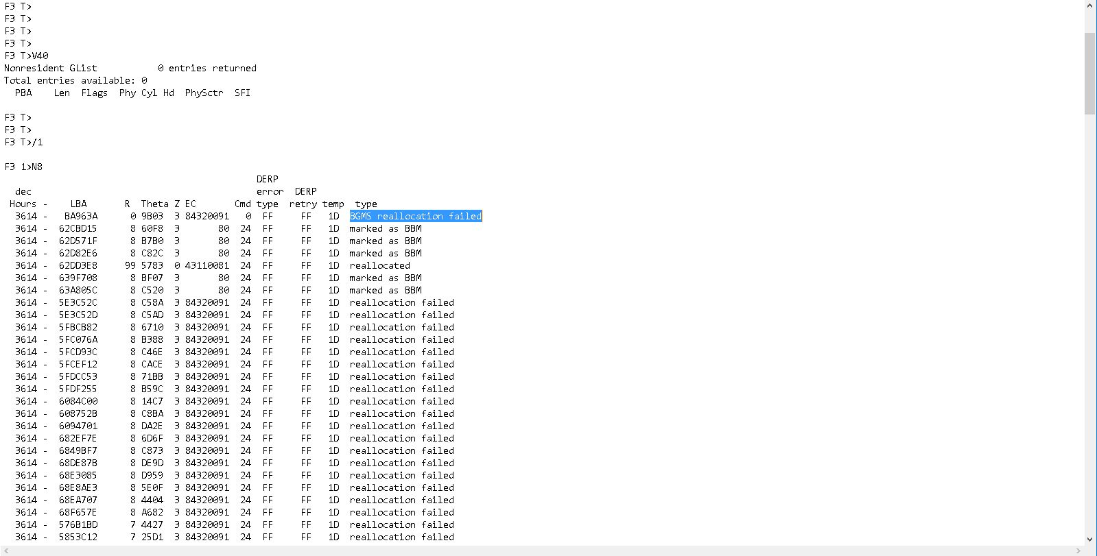

It has 4 heads out of which I have imaged 3 heads without any errors. However while copying from Head 3 I am getting errors.

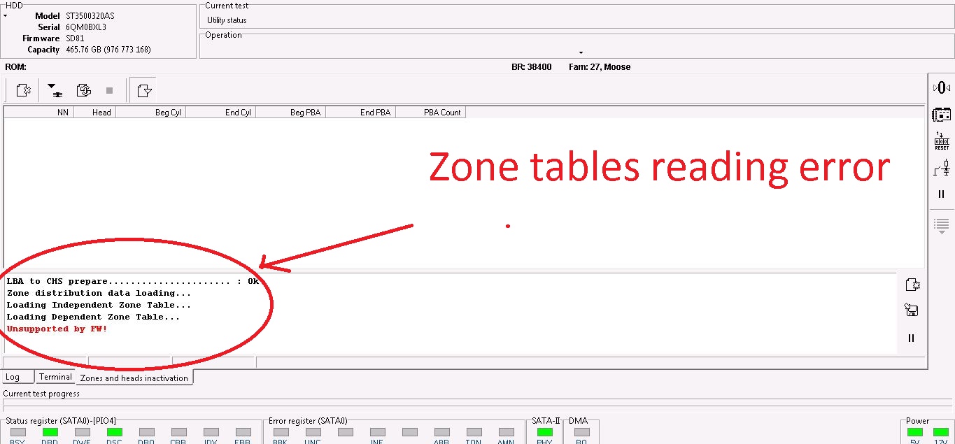

I could copy data using head 3 but it is very slow and with bad sectors. If I skipped file then it runs smoothly for some time. Then suddenly it starts giving bad sectors ( all sectors bad then & I am forced to power off/on)

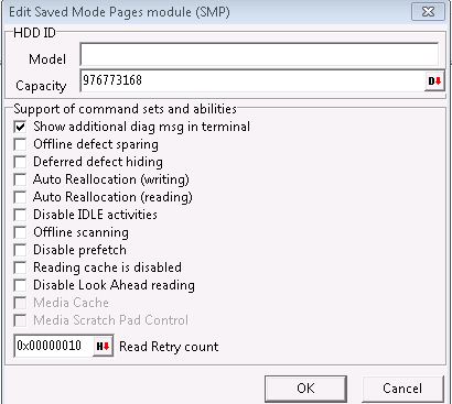

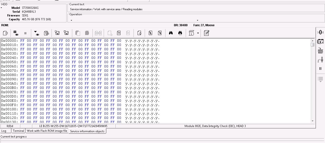

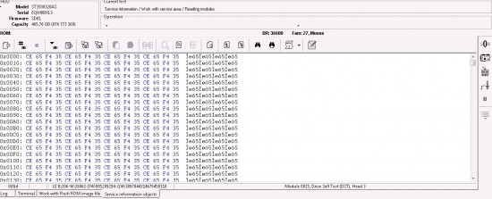

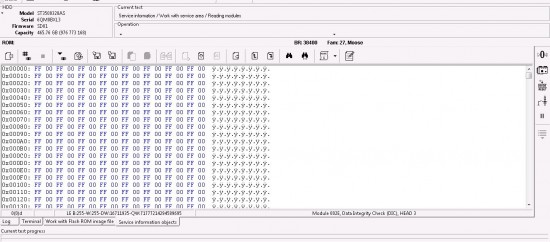

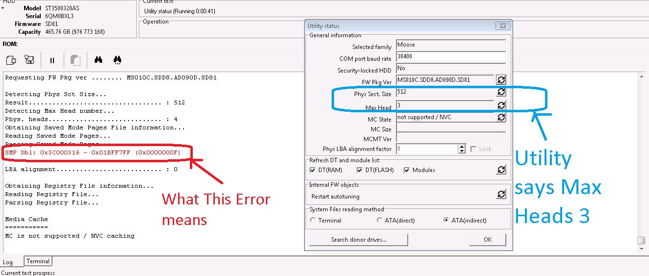

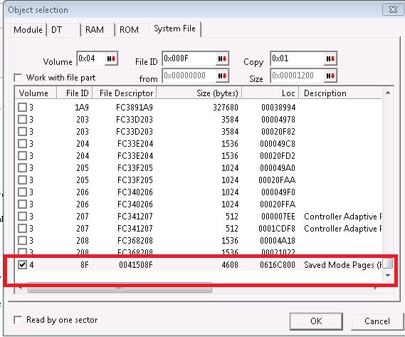

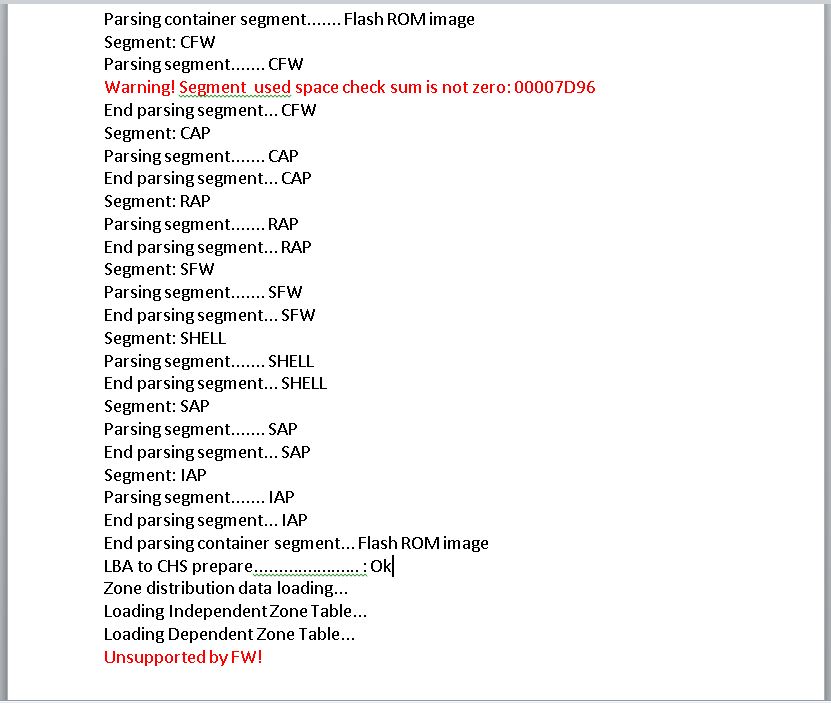

I have cleared SMP flags assuming this is system file issue but that has not given any respite.

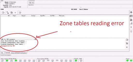

Head does not seems to be dead but either weak or some Head 3 related firmware file is having issue.
Can someone pls. guide me ? I am using PC3000 UDMA express Red card

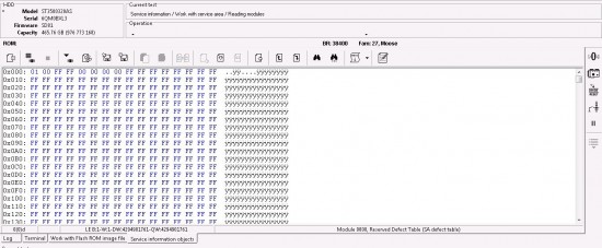

FW backup & module checking ---
amily ID: 27
Selected family......................... : 27, Moose
Model by ID............................. : ST3500320AS
Loading default settings!

Detecting Max Head number...

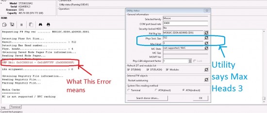

Phys. heads............................. : 4
Obtaining Saved Mode Pages File information...
Reading Saved Mode Pages...
Parsing Saved Mode Pages...
SMP Dbl: 0x3C000316 - 0x01BFF7FF (0x0000000F)

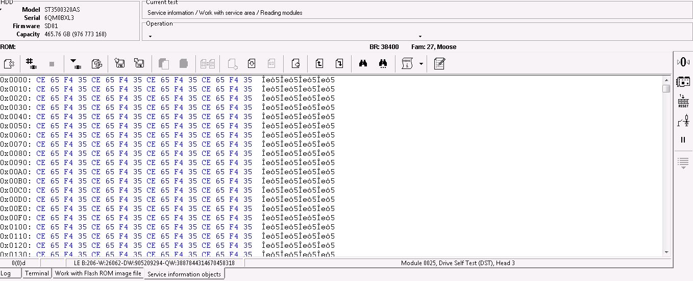

22 80 Drive Self Test (DST), Head 0
23 80 Drive Self Test (DST), Head 1
24 80 Drive Self Test (DST), Head 2
25 80 Drive Self Test (DST), Head 3
2A 9 Saved Mode Pages (HDD settings)
2B 579 R/W Operating Parameters (translator, etc)
2C 432 Data Integrity Check (DIC), HEAD 1
2D 432 Data Integrity Check (DIC), HEAD 2
2E 432 Data Integrity Check (DIC), HEAD 3

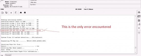

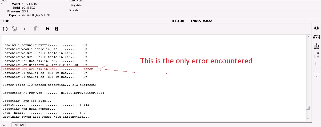

Reading autotuning buffer............... Ok
Searching module table in RAM... ....... Ok
Searching volume 3 file table in RAM.... Ok
Searching volume 0 file table in RAM.... Ok
Searching SMP RAM FID in RAM............ Ok
Searching Non Resident G-List FID in RAM Ok
Searching CFW OVL FID in RAM............ Error
Searching DT table(RAM, WR) in RAM...... Ok
Searching DT table(RAM, RD) in RAM...... Ok
System Files I/O method detection... ATA(indirect)

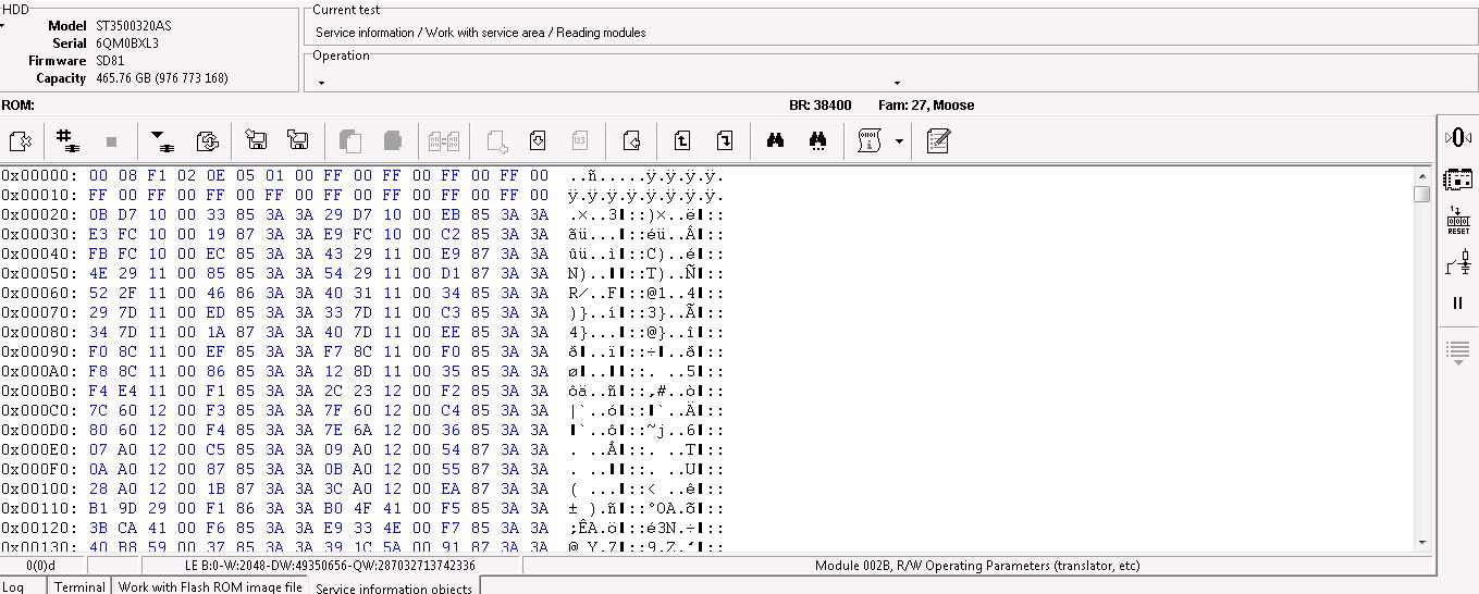

Test : HDD resources backup
Folder: C:\Program Files\ACE Lab\PC-3000\Bin\!Profiles\SgF3\Moose\ST3500320AS-SD81-6QM0BXL3 NEW\Data\SABackup\
Reading ROM to profile folder
Folder: C:\Program Files\ACE Lab\PC-3000\Bin\!Profiles\SgF3\Moose\ST3500320AS-SD81-6QM0BXL3 NEW\Data\SABackup\ROM\
Result.................................. : Ok
Reading DT to profile folder
Folder: C:\Program Files\ACE Lab\PC-3000\Bin\!Profiles\SgF3\Moose\ST3500320AS-SD81-6QM0BXL3 NEW\Data\SABackup\CPDir\
DT 0000 (Flash ROM), Read Adaptive Parameters File (RAP).............. : Ok
DT 0001 (Flash ROM), Controller Adaptive Parameters File (CAP)........ : Ok
DT 0004 (Flash ROM), Servo Adaptive Parameter File (SAP).............. : Ok
DT 0005 (Flash ROM), Servo Firmware Table............................. : Ok
DT 000A (Flash ROM), Seek Profile..................................... : Ok
DT 0013 (Flash ROM), Dependent Zone Table for User Area............... : Ok
DT 0014 (Flash ROM), Dependent Zone Table for System Area............. : Ok
DT 0015 (Flash ROM), Flash ROM........................................ : Ok
DT 001B (Flash ROM), Dependent Zone Group Tables for User Area........ : Ok
DT 001C (Flash ROM), Dependent Zone Group Tables for System Area...... : Ok
DT 001D (Flash ROM), VBAR Configuration File.......................... : Ok
DT 001E (Flash ROM), Zone Format Parameters File...................... : Ok
DT 0000 (RAM), Read Adaptive Parameters File (RAP).................... : Ok
DT 0001 (RAM), Controller Adaptive Parameters File (CAP).............. : Ok
DT 0002 (RAM), Zone Table............................................. : Ok
DT 0004 (RAM), Servo Adaptive Parameter File (SAP).................... : Ok
DT 0005 (RAM), Servo Firmware Table................................... : Ok
DT 0006 (RAM), Servo Flaw Table....................................... : Ok
DT 000A (RAM), Seek Profile........................................... : Ok
DT 0013 (RAM), Dependent Zone Table for User Area..................... : Ok
DT 0014 (RAM), Dependent Zone Table for System Area................... : Ok
DT 0015 (RAM), Flash ROM.............................................. : Ok
DT 0016 (RAM), Drive Configuration Table.............................. : Ok
DT 0017 (RAM), Temperature Control Configuration...................... : Ok
DT 001B (RAM), Dependent Zone Group Tables for User Area.............. : Ok
DT 001C (RAM), Dependent Zone Group Tables for System Area............ : Ok
DT 001D (RAM), VBAR Configuration File................................ : Ok
DT 001E (RAM), Zone Format Parameters File............................ : Ok
DT 001F (RAM), RW working user preamp table........................... : Ok
DT 0020 (RAM), RW working system preamp table......................... : Ok
DT reading process completed

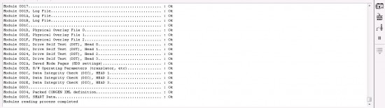

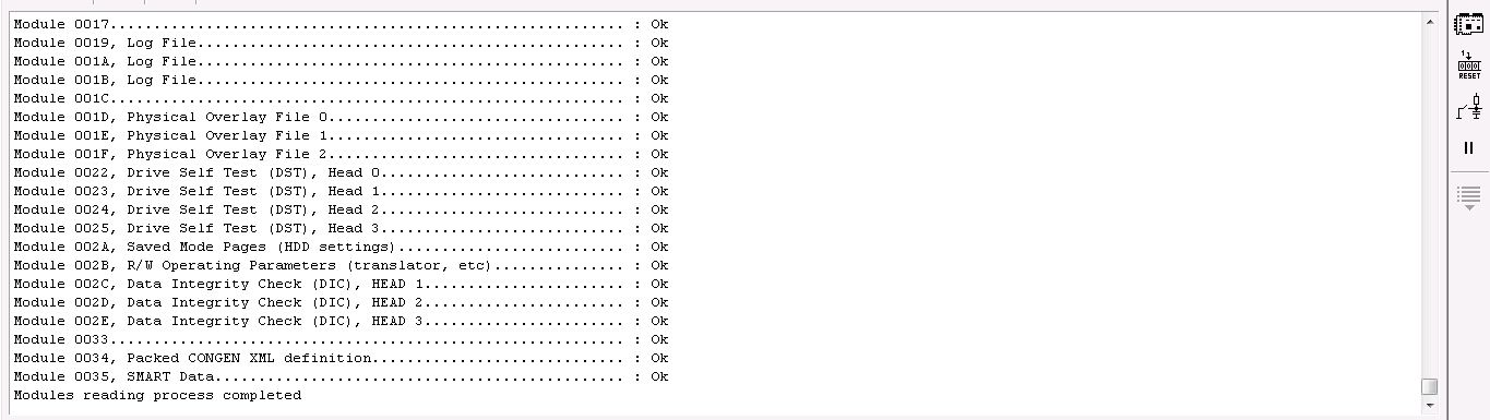

Reading modules to profile folder
Folder: C:\Program Files\ACE Lab\PC-3000\Bin\!Profiles\SgF3\Moose\ST3500320AS-SD81-6QM0BXL3 NEW\Data\SABackup\ModDir\
Will be skipped : 000C, 000E, 000F, 0022, 0023, 0024, 0025, 002C, 002D, 002E

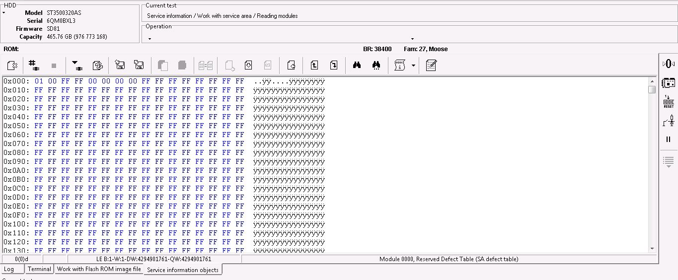

Module 0000, Reserved Defect Table (SA defect table).................. : Ok
Module 0001, Drive Information File (DIF)............................. : Ok
Module 0002, Performance Parameter File (PPF)......................... : Ok
Module 0003, Primary Defect File (P-List))............................ : Ok
Module 0004, Servo Adaptive Parameter File (SAP)...................... : Ok
Module 0005, Manufacturing Information File (MIF)..................... : Ok
Module 0006, Read Adaptive Parameters File (RAP)...................... : Ok
Module 0007, Controller Adaptive Parameters File (CAP)................ : Ok
Module 0008........................................................... : Ok
Module 0009, SMART Configuration File................................. : Ok
Module 000A, SMART Data File.......................................... : Ok
Module 000B........................................................... : Ok
Module 000D........................................................... : Ok
Module 0013, Disc Registry File (settings, security, etc)............. : Ok
Module 0015, BGMS File (Directed Offline Scan)........................ : Ok
Module 0016........................................................... : Ok
Module 0017........................................................... : Ok
Module 0019, Log File................................................. : Ok
Module 001A, Log File................................................. : Ok
Module 001B, Log File................................................. : Ok
Module 001C........................................................... : Ok
Module 001D, Physical Overlay File 0.................................. : Ok
Module 001E, Physical Overlay File 1.................................. : Ok
Module 001F, Physical Overlay File 2.................................. : Ok
Module 002A, Saved Mode Pages (HDD settings).......................... : Ok
Module 002B, R/W Operating Parameters (translator, etc)............... : Ok
Module 0033........................................................... : Ok
Module 0034, Packed CONGEN XML definition............................. : Ok
Module 0035, SMART Data............................................... : Ok
Modules reading process completed

 Post subject: Re: Heads or firmware
PostPosted: October 5th, 2016, 12:20
Posts: 847
Location: Pakistan
can we see head resistance ??
Data Recovery Pakistan
PostPosted: October 5th, 2016, 12:23
Joined: November 26th, 2014, 11:55
Posts: 78
Location: Earth
Did you try to read from PC3K utility?
PostPosted: October 5th, 2016, 22:22
Posts: 3551
Does DWF flash when it stops reading?
PostPosted: October 6th, 2016, 1:13
Joined: May 30th, 2014, 0:54
Posts: 153
Location: Universe
WO WO WO :D
Thank you so much Guys I am sure now I will be able to find true cause of this issue & give all videos to poor family.
Hi MindMergepk I have checked Head resistance , attached is snap.
Hyuce -- Yes I have tried to read from PC3K utility I could read with same bad sectors and slow speed.
Yes Northwind you are right all three registers alongwith ERR and ABR glows when disk suddenly starts giving read errors. - I have attached its snap also.
I have observed one strange thing -- while initializing utility says default family settings loaded and it shows disk has 3 heads ,but actually disk has 4 heads
Is this reason that due to some reason PC3K is unable to identify head 3 and so giving all this errors.
It is highly unlikely that 75% disk sectors are not having any bad sectors and only sectors covered by Head 3 are bad.

Hi Thanks to all guys
I have rechecked disk again as suggested by all of you and have following observation --
1) I can read flawlessly by 3 heads and by head 3 till it starts giving read errors
2) I have checked all modules overlays they are good
2)SA defects also ruled out. besides SA is read by Head 0 which in itself is fine.
3) I checked DIC-- Data Integrity check Head 3 & DST -- Drive Self Test head 3 both are ok
4) Head resistance is not changed -- head 3 seems to be in reasonably good condition. Though Head test and resistance are not absolute benchmarks for heads tests
5) I have checked Servo Flaws list -- it has 162 entries and all by Head 0 and 1 only so degradation of platter is ruled out.
6) Since we have been able to image 75 & disk any issue in PCB also ruled out
7) Is it that pc3k is not fully supporting firmware SD81 as it shows only 3 heads in utility status /Unable to read independent zone table
8) Module 002B -- read write operating parameters -like translator is OK
9) As Sean has said this could be translator - need to check this , how can I check status of translator?
10) N8 shows lots of reallocation issues --
a)BGMS reallocation failed
b)Reallocation Failed
c)Marked as BBM
d)reallocated
I this this is root cause of the issue.

I have been able to image 30% sectors on head 3. But now disk is not reading from this head at all. It starts to throw all bad sectors since start.
surprisingly head resistance for head 3 is same and is not altered
