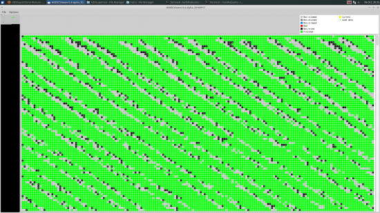

First, this is just an informational question, as I am trying to understand information about a drive that is not in my possession.
I have been talking with someone that has a Maxtor 6L200R0 that is failing, and the ddrescue log provided looks like it has 6 heads with 2 heads failing (see the image). It was hard to see at first because it looks like this drive has about 1MB read size per head. I had to max out the settings on my viewing tool to see it the pattern. Does this sound correct for this drive? I am used to seeing 50-100MB size reads per head. I think I figured my head skipping algorithm could handle down to 20MB read size per head with the default settings. A drive like this would not work well with the default settings for my head skipping algorithm, and trying to explain how to know what to change the settings to would be about impossible to explain to a novice :(

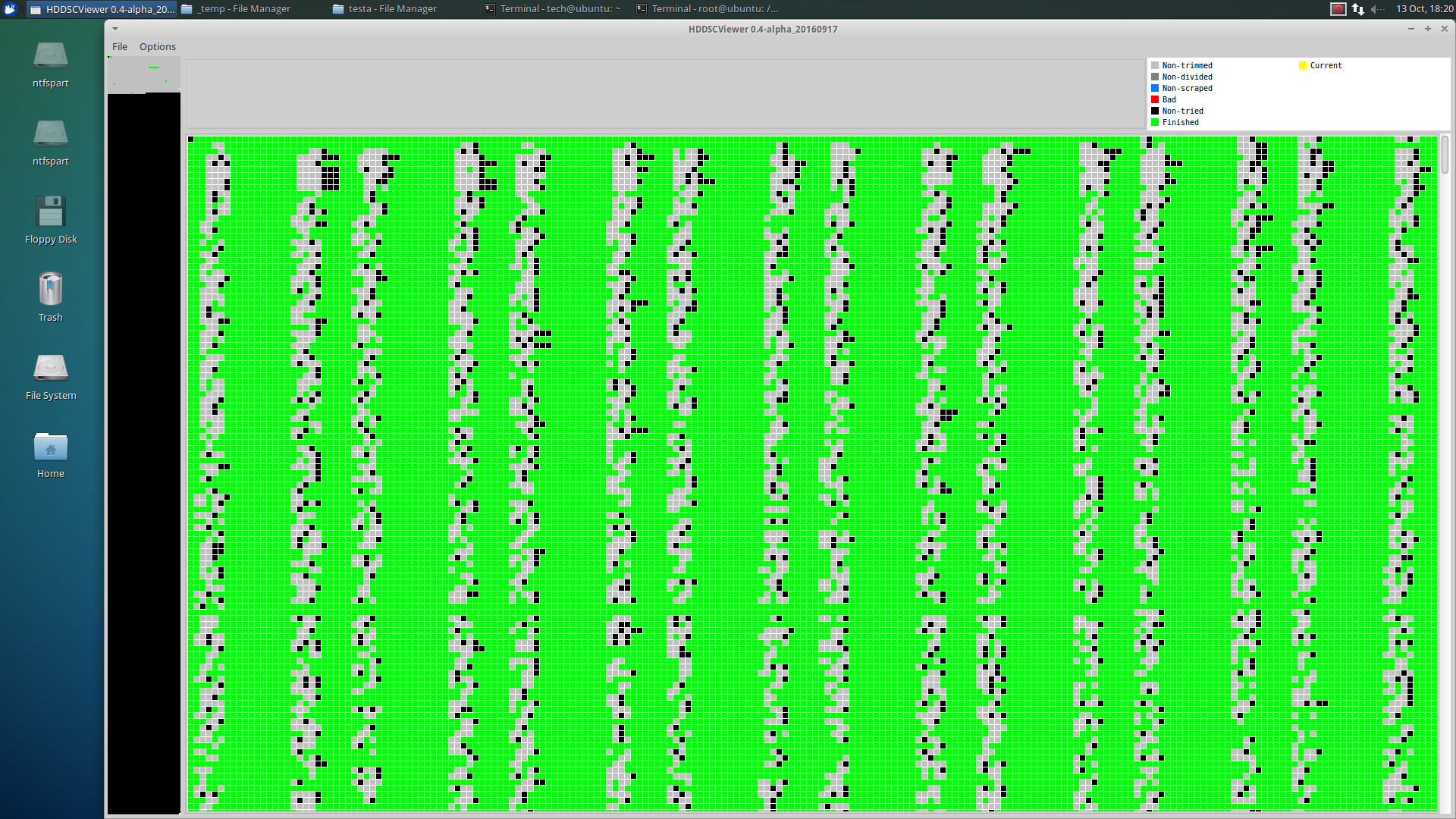

drHDD wrote:
5 heads
I have adjusted the display on the viewer to get the pattern lined up better, and I think 5 heads does match the pattern (2 heads are weak). That would confirm that the read size per head is a little over 1MB, according to calculations from the log file. The default skip size for the head skipping algorithm of HDDSuperClone would not work well for a drive like this. It would induce runaway skipping which would cause skip resets, although it is stated in the manual that if there are skip resets then the settings may need to be changed.
