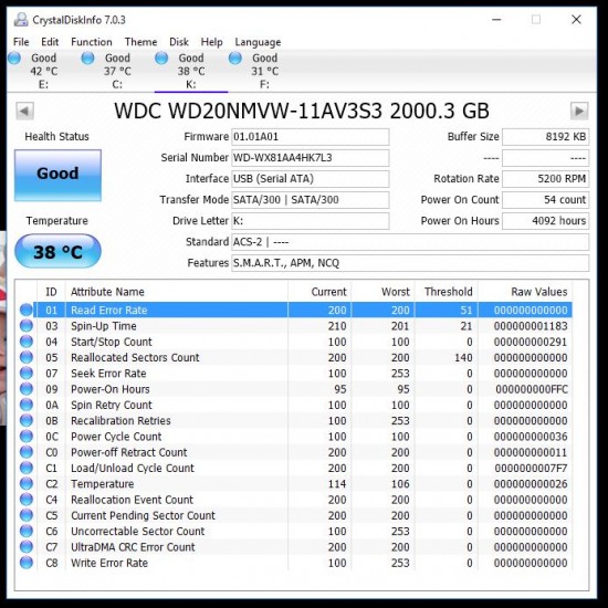

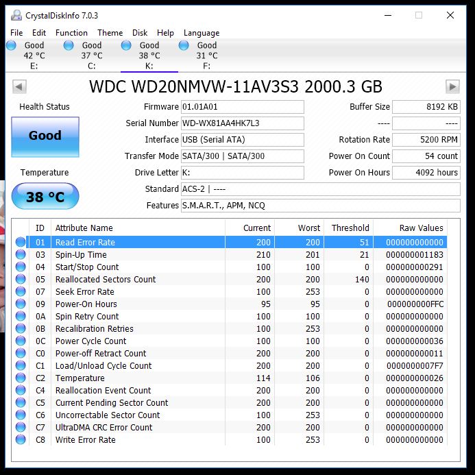

@pcn - I ran crystal disk info (see attached screen grab)

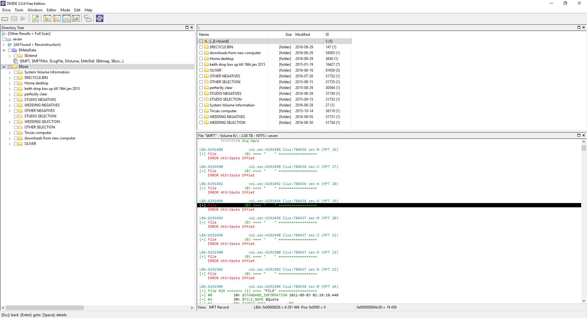

here is another screen grab from DMDE

Which two folders are the problematic ones?
 Post subject: Re: 2 folders that were full are now empty on external HDD
PostPosted: October 1st, 2016, 8:12
Joined: September 29th, 2016, 8:57
Posts: 10

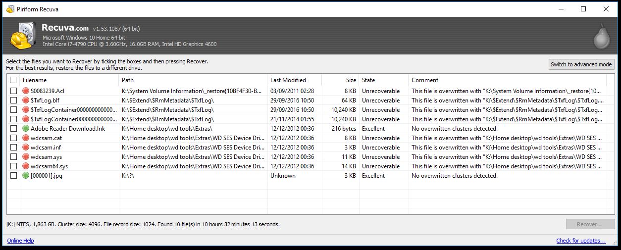

Hi @fzabkar the 2 that are empty are "other selection" and "studio selection". They are slightly shaded out meaning "folder contains no files"
Here is a screen grab of Recuva scan

Agree. The smart data in the earlier post shows no reallocated or pending sectors, indicating a logical issue. Most free software such as testdisk will only list files as it finds them in the directories. If a directory entry gets corrupted then the contents will not show. However, as long as the actual file entries are still intact in the MFT (assuming you have not ran checkdisk and caused further damage) they can be found by better software, and even know what folder they were in. I am not sure how DMDE does it as I do not have experience with it. Also, those MFT errors in the screenshot from DMDE are of inodes 16-24, which are reserved and do not have data in them.
With that being said, it is still safer to make a clone/image of the drive and work with that. If you work with the original any changes made are permanent and irreversible.

First, I am basing my answers on the fact that both the reallocated sector count and pending sector count raw values are both zero, indicating that it does not appear that the drive has physical media damage. If either of those was anything other than 0 or changes to something other than 0 then I would tell you to seek professional recovery immediately. Just understand that there is always the slight possibility that the smart data is not telling the whole story, but based on the current data it would appear that the drive is still healthy.

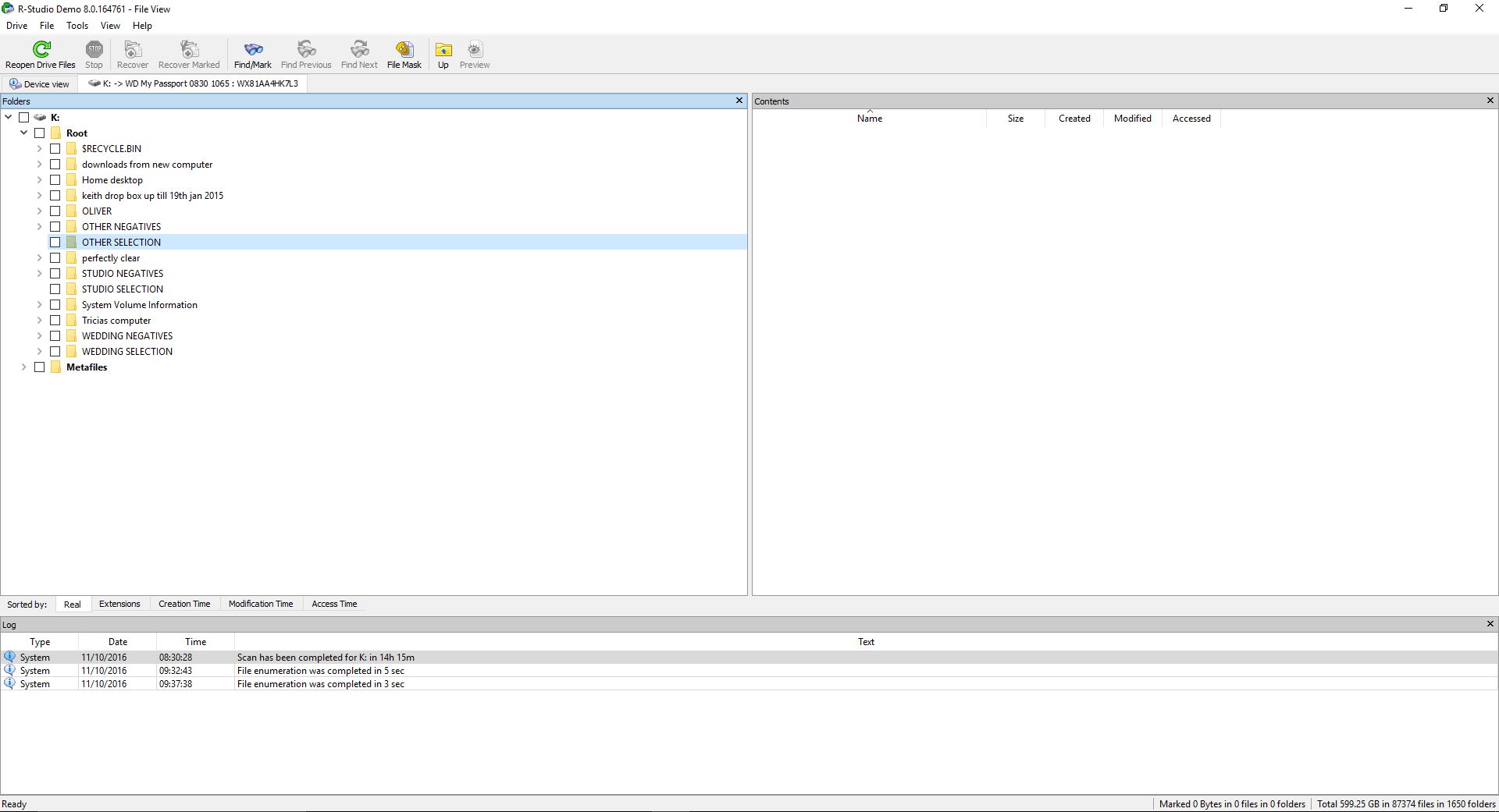

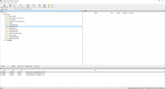

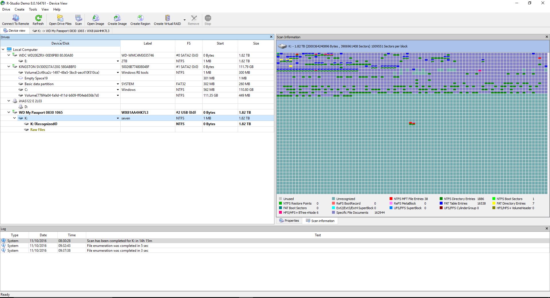

Hi All,
I figured out how to use R-studio
Both folders "OTHER SELECTION and STUDIO SELECTION" still appear empty.
Screen shots attached .
Is there anything else R-Studio can do to locate the files as nothing appears missing ?
