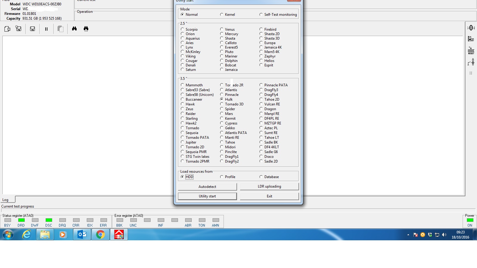

hello everyone,
I have this WD hard drive. It comes ready position on PC3000 , id and capacity is okay. i can backup all the modules and rom without any problem
however, when i try to clone this drive onto another hard drive it doesnt read any data and keep software resetting and clicking
tried translator regeneration but it wont complete ,
tried another pcb but same behaviour
anyone could give any idea or some one had similar issue
cheers

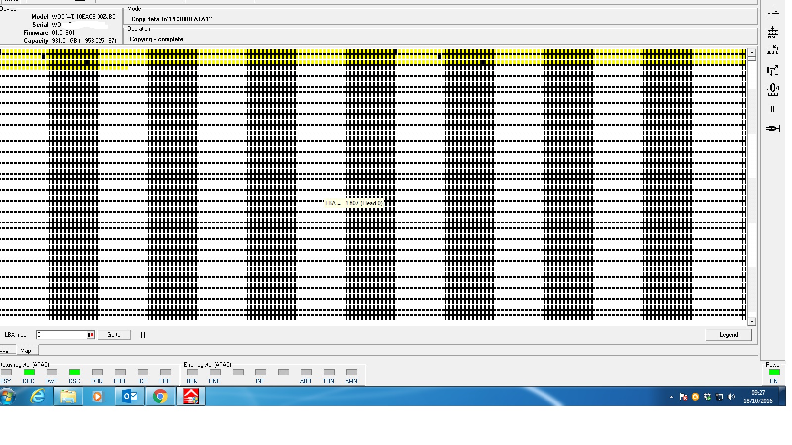

ibcho wrote:tried translator regeneration but it wont complete ,
it explains that problem is probably with heads, have you test heads ??
Re: Western digital WD10EACS-00ZJB0 Not Reading Anything
October 18th, 2016, 7:49
Do a heads test in utility.
October 18th, 2016, 10:31
You van edit head map in RAM. Start first with heads 0 or 1, then you can make adjustment and add good heads. Isolate bad one.
October 18th, 2016, 14:24
Kum Ruzvelt wrote:You van edit head map in RAM. Start first with heads 0 or 1, then you can make adjustment and add good heads. Isolate bad one.
Good advice!
