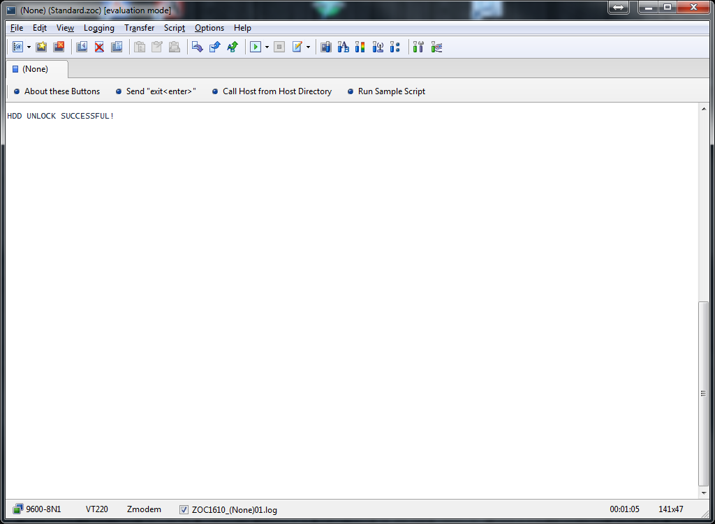

Could you help me unlock Seagate ST3250312CS Pipeline HD.2 with ATA password? At the moment I have only available terminal cabel.
In MHDD I have status PWD, Warning: this drive is locked by ata password.

Thank you Spildit for this link. I will tried this method but I can't unlock this disk.
So I used this script two times one time I start initial buffer from 0B00 and second time by default 0A30. Genarated file are different.
From both time script created on my computer file __PWD.bin.
Next I tried unlock drive using Victoria.
13:35:18 : Open file: C:\_DUMPS\__PWD.BIN
13:35:25 : Reset OK
13:35:25 : Get passport... Timeout
13:35:25 : Get drive passport: Drive error!
Unfortuatly disk still have the password.

Maybe the OP could temporarily reconfigure the SATA controller in BIOS for IDE or compatibility mode.

I unlocked this drive using this script!
13:30:27 : This drive locked by ATA password!
13:30:27 : Model: ST3250312CS; Capacity: 488397168 LBAs; SN: 9VT01GNL; FW: SC13
13:31:20 : Open file: F:\vvv\_DUMPS\__PWD.BIN
13:31:27 : Reset OK
13:31:27 : Waiting of readiness... Drive is ready
13:31:27 : Get passport... OK
13:31:27 : This drive locked by ATA password!
13:31:27 : Send password from file: __PWD.BIN. Type: USER, level: HIGH
13:31:27 : Unlock complete
13:31:27 : PWD removing complete
13:31:27 : Reset OK
I used another PC becuase Victoria didn't saw disk during my fist attampt. And using Victoria I sent password to drive.
Thank you Spildit and fzabkar for your help.

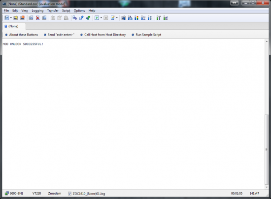

Thanks boys
