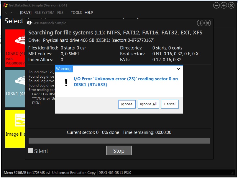

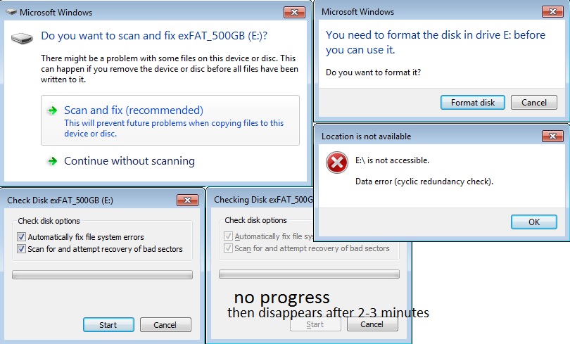

Pictures... only Win7 (OS X shows that used space = max space
File comment: GetDataBack Simple notification

File comment: Win7 behaviour and notifications

Electronics it's not the fault.
You might have a bad head or media damage.
If data is really needed, you should stop working with it and send it to someone who can image it before it completely fails.
