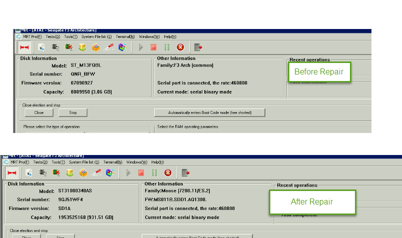

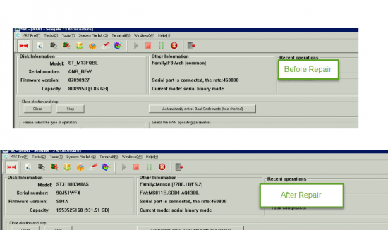

and just repair same issue in my lap now and i make full video to break your 99% percent that you talk about it and i attach picture before and after repair

 Post subject: Re: Seagate HDD not working - mixed test results
PostPosted: November 12th, 2016, 18:53
Joined: July 7th, 2015, 11:05
Location: Serbia
Yes, its FW problem, not heads.
