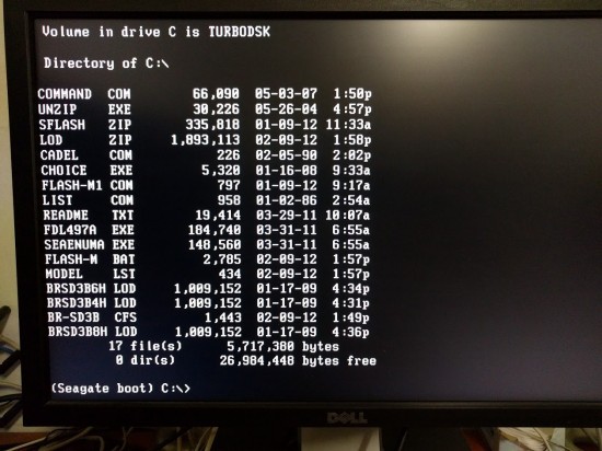

I have the following drive attached to my SATA controller (extracted from FreeAgent Desk):
Seagate Barracuda 7200.11
ST31000333AS
Firmware: SD35
The device is working properly and the (short) self test passes.
Typing the serial number into the Seagate Download Finder directed me to the SD3B ISO (Barracuda11-ALL-BRSD3B.ISO). So I burnt the ISO and booted from it. I then double checked that the ST31000333AS was indeed included in the list of supported modules as reported by the bootable flash software. Alas, trying to "download firmware to supported models" resulted in a big red FAILED message.
I suspect some manual flashing procedure is required, similar to to the one described here, but that thread was for a different model so I'm a bit reluctant to try the exact same command. I've attached a screenshot of the files I have in the FreeDOS prompt.
Thanks!

From the configuration file ...
#BRINKS SDD3 BRANCH 6 HEAD
ST31000333AS;BR120B.SDD3.BL0C0A.SD34.B09E;BRSD3B6H.LOD;BR120B.SDD3.BX0R0A.SD3B.B0C4
ST31000333AS;BR120B.SDD3.BP070A.SD35.B09E;BRSD3B6H.LOD;BR120B.SDD3.BX0R0A.SD3B.B0C4
ST31000333AS;BR120B.SDD3.BP0P0A.SD35.B0A3;BRSD3B6H.LOD;BR120B.SDD3.BX0R0A.SD3B.B0C4
ST31000333AS;BR120B.SDD3.BP0V0A.SD35.B0A8;BRSD3B6H.LOD;BR120B.SDD3.BX0R0A.SD3B.B0C4
ST31000333AS;BR120B.SDD3.BQ050A.SD34.B09E;BRSD3B6H.LOD;BR120B.SDD3.BX0R0A.SD3B.B0C4
I take no responsibility for the outcome, but the following command line should apply the firmware update.
    FDL497A -m BRINKS -f BRSD3B6H.LOD -i ST31000333AS -s -x -b -v -a 20
Note that the above configuration file screens out unsuitable candidates. You will now be forcing the update to go ahead.

The flash-m.bat file tests for the following errors:
    Disk drive already has this firmware version.
    Error: Specific model not found. %model% expected.
    Model matched but firmware version is not compatible.
    No disk drive detected. Drive not found. Drive not ready.
I don't know why your error message is not one of these. :?

Forgive me, I didn't realize the error was reported only after pressing 'c' to return to the original OS.
I'm getting the last error you mentioned:
Does this change anything?

So, to sum up - our current theory is that it's not a configuration mismatch issue, rather the fact that the flasher can't even see the drive?
To test that assumption, I could try the command-line you gave me to forcefully update the firmware, which we expect will fail for the same reason - correct?
BTW I was able to update a Samsung SpinPoint F3 firmware from FreeDOS, if that's relevant (http://knowledge.seagate.com/articles/e ... Q/223631en).
 Post subject: Re: Cannot update ST31000333AS to SD3B
PostPosted: October 31st, 2016, 18:19
Posts: 17325
Yes, you could try the command line.
If you examine flash-m.bat, you will see that the command that scans for available HDDs is seaenuma. However, the command that executes the update is fdl497a.exe. I suspect that the former is able to communicate with your SATA controller whereas the latter cannot.

Actually, it looks like neither one can communicate with the drive :)
The command-line failed as we expected, but even seaenuma reported "no controllers".
Well, mystery solved. Thanks a lot for all your help!!

Well, I connected the hard drive to my sister's ancient motherboard which doesn't even have AHCI and sure enough, the upgrade proceeded without hickup!
Yet another satisfied fzabkar customer 8)
