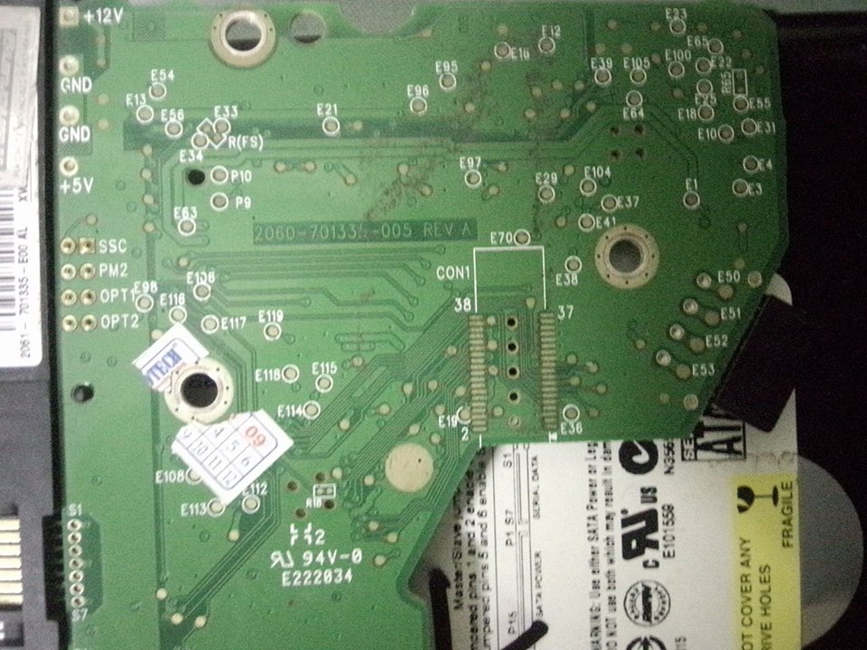

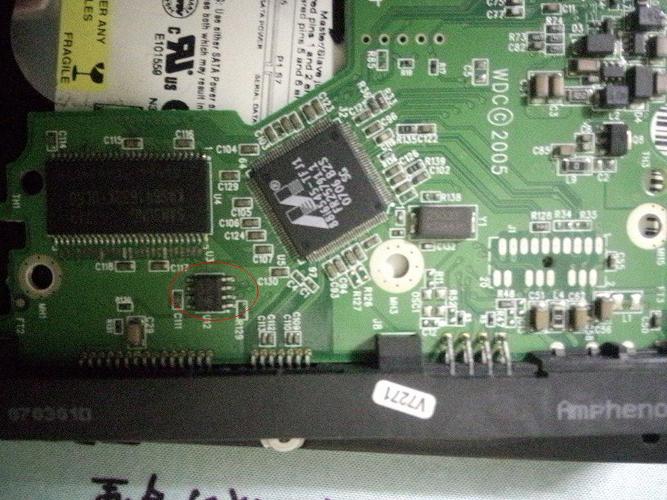

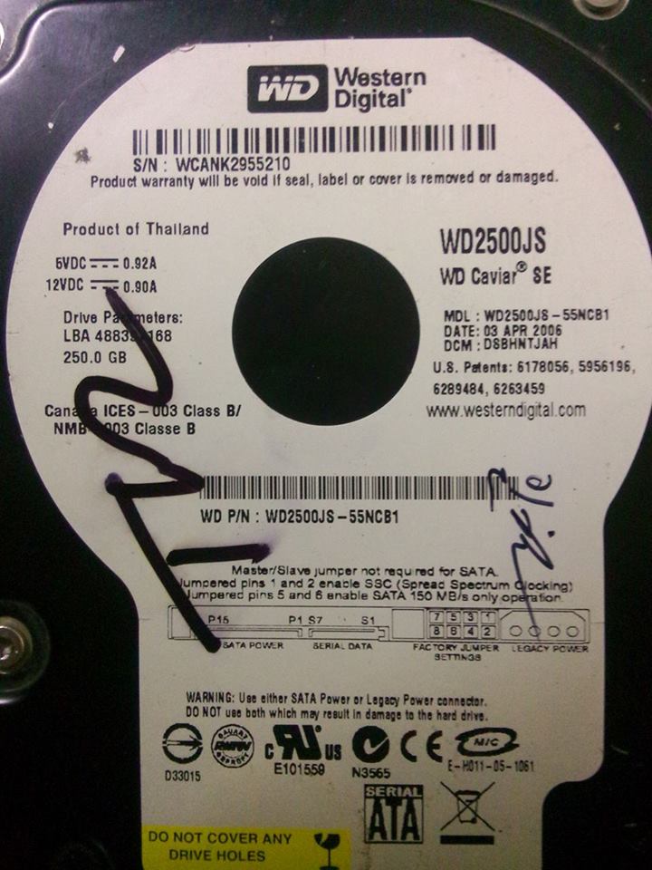

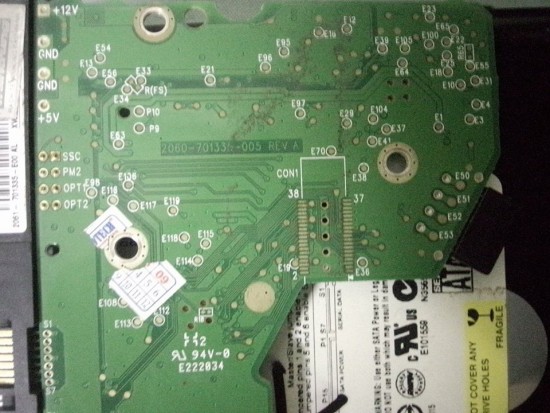

My hard drive die wd250js ROM.
I need to recover data, give me this hard drive ROM original
Looking forward to your help
Thank you

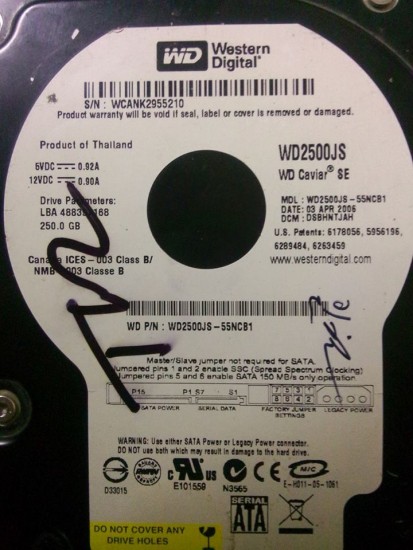

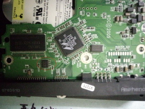

I exchanged PCB hard drive spinning up normally
I exchanged ROM chip on the hard drive does not spin
You help me

Have you checked the ROM solder joints to make sure it's been put on correctly.

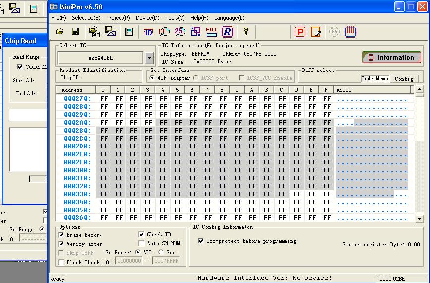

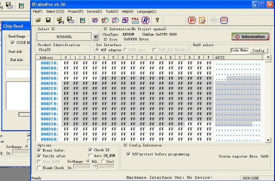

Do you have any way to READ ROM on the CHIP (external programmer) ?
DUMP the ROM with something like this : - http://www.hddoracle.com/viewtopic.php?f=117&t=865
If it doesn't work try to move ROM back to the other PCB. Do you have access to SA with non-native ROM + donnor overlay 11 ?
I have used the external ROM programming
I have used the external ROM programming, because the original ROM White , you have ROM help me

if hdd spin normally with other pcb
this mean recover data is very easy in this case
but clarifiy these points
1- can you read SA modules by new pcb
if not then write any good rom so you can access SA modules
read them all
and i have very good way to recover data in these old L-shapped even with no original rom
but Extract modules or at least key modules from SA
http://www.hpwlab.com

I can't stress enough, if you are not used to changing ROM chips, check the solder joints first.

Are these close enough?
You may need to edit the head map for the 160GB ROM.
WDxx00JS-xxNCB1.7z [255.82 KiB]
Downloaded 457 times
