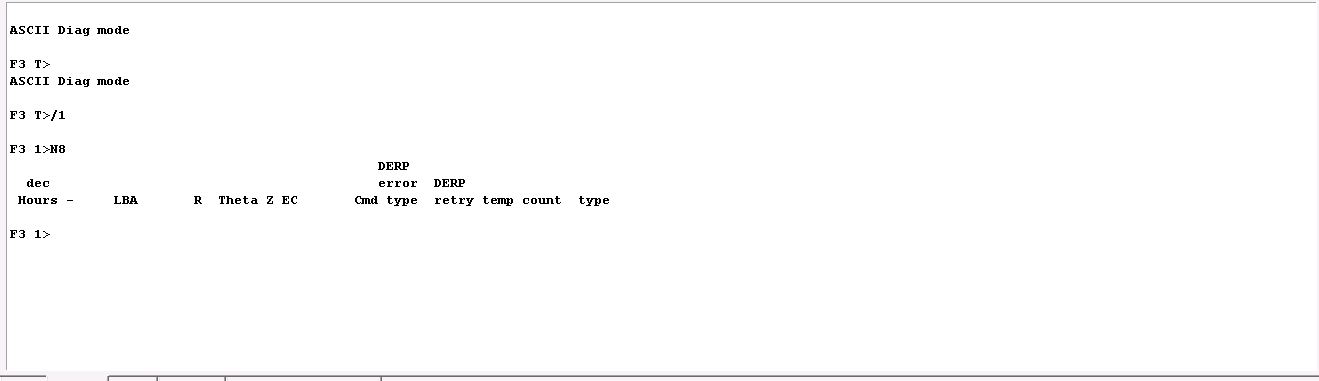

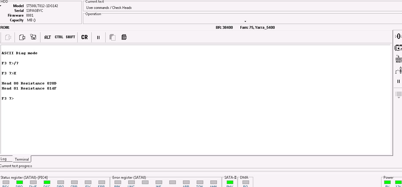

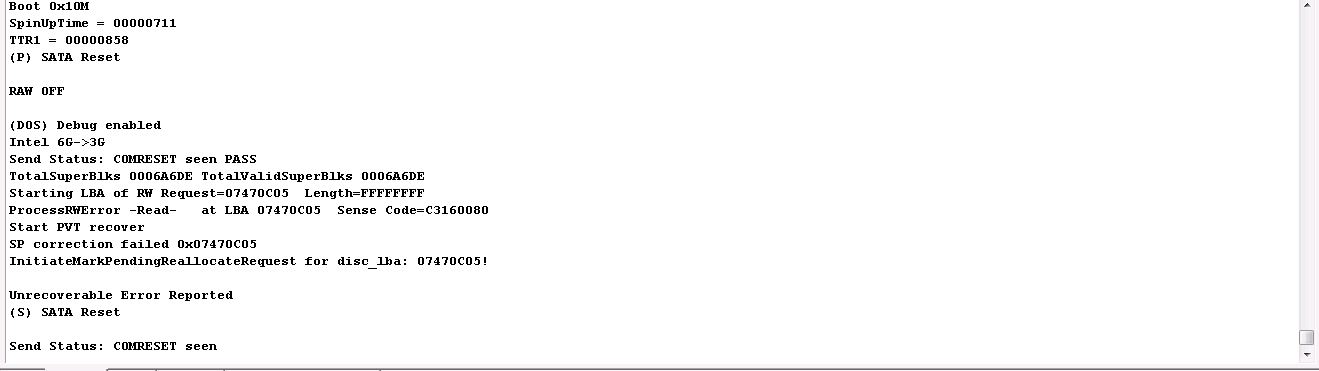

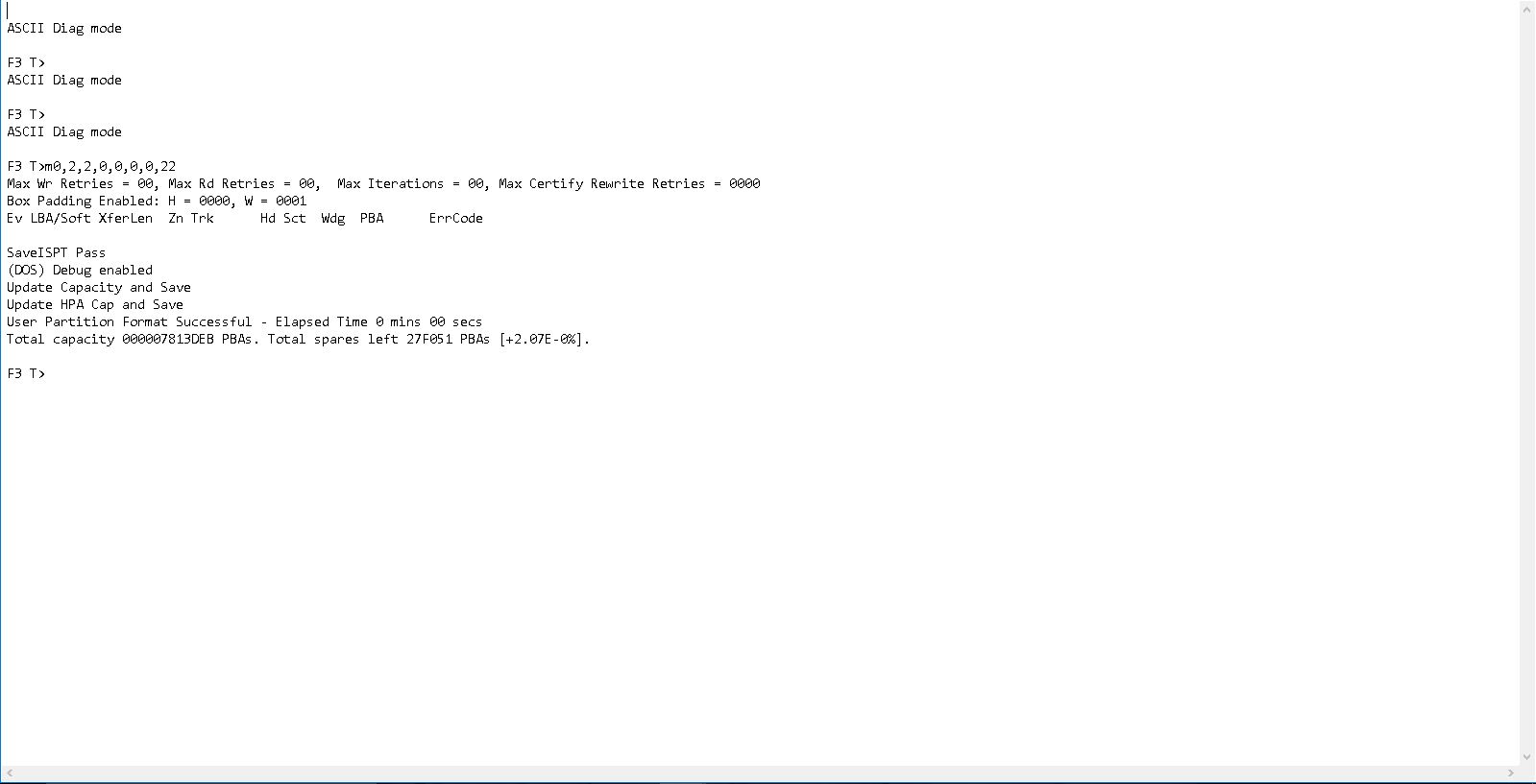

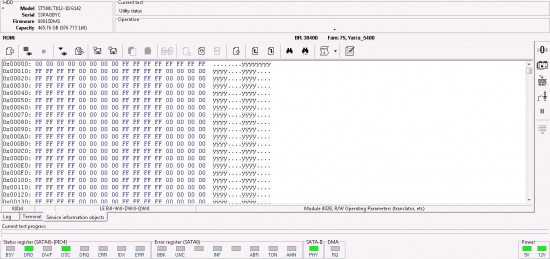

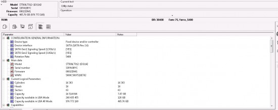

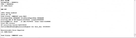

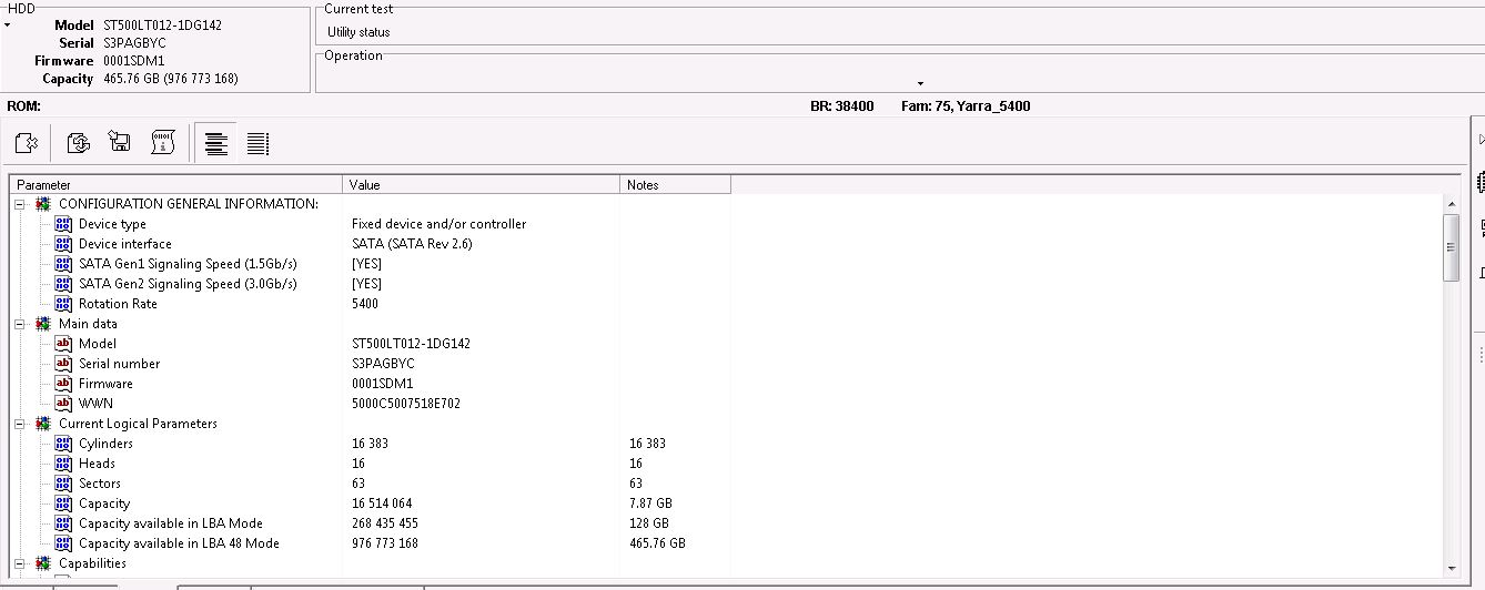

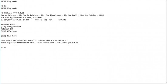

It was Seagate Momentus Thin ST500LT012 Firmware 0001 ( Yarra 5400)
When I got disk it was detected in UDMA with 0mb capacity .

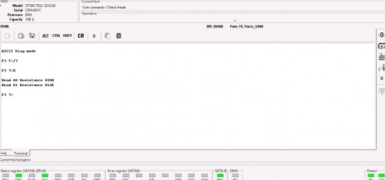

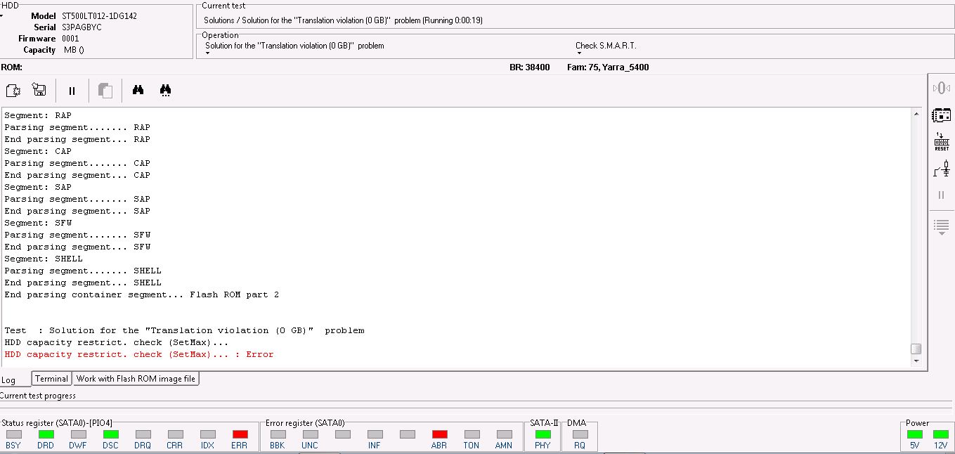

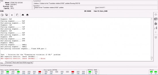

I tried 0mb solution in udma but got error HDD capacity restrict , I checked head resistance as well.
So I decided to use magic spell ( m0,2,2,0,0,0,0,22) and Lo & Behold drive was showing full capacity, :D

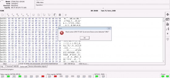

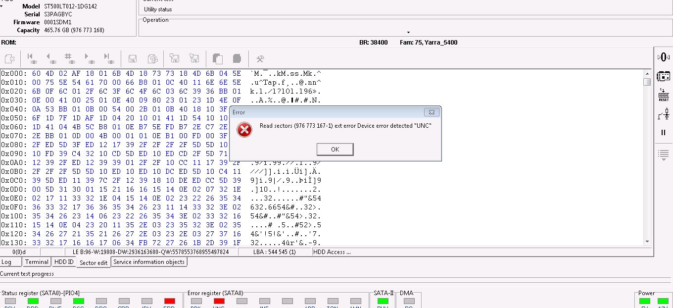

All firmware modules can be read without errors.
but while accessing data I am getting read errors.
What should I do now ?

 Post subject: Re: Seagate Momentus Revival
PostPosted: November 2nd, 2016, 11:02
Posts: 219
Did you save original SA before these operations?

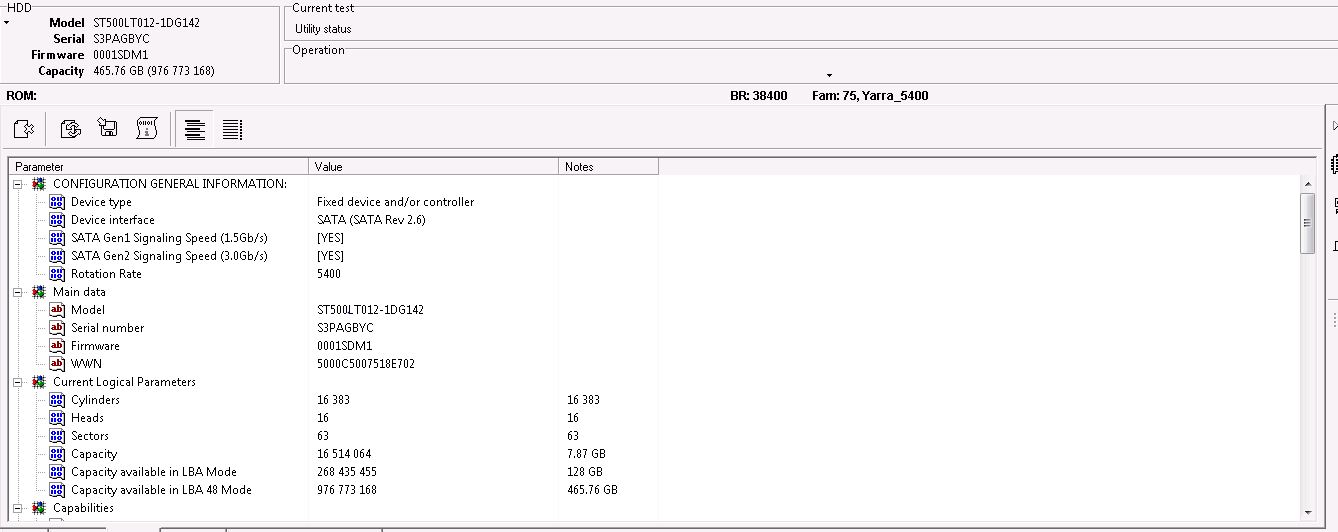

PostPosted: November 2nd, 2016, 11:05
Joined: May 21st, 2007, 16:10
Posts: 1592
Location: Gothenburg/ Sweden
I can't see full capacity on either photos...
If you have drive showing the full model, firmware and capacity....and you can't read user area, my first search should be on translator.
PostPosted: November 3rd, 2016, 5:33
Posts: 219
BTW, on the pictures I see no full capacity. Drive isn't initialized completely. What about ctrl+x?
PostPosted: November 3rd, 2016, 9:36
Posts: 548
Location: brisbane
Hi thanks all of you for valuable suggestions.
Yes martin I always take backup before doing any changes.

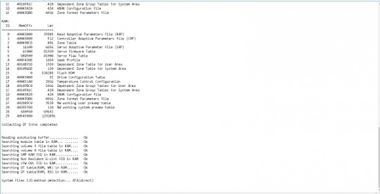

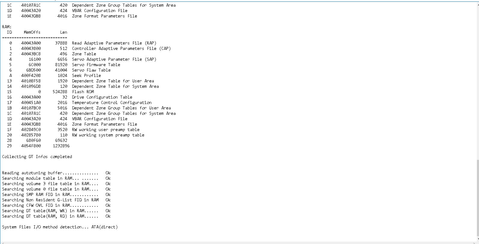

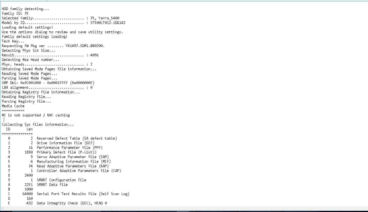

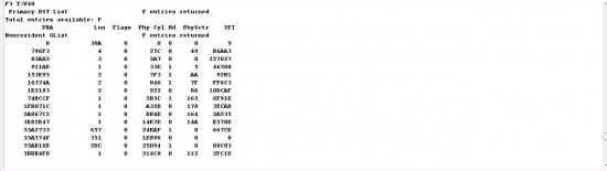

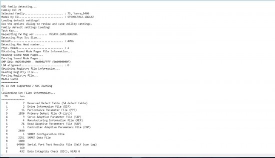

Terminal messages show translator related issue ,but all modules can be read perfectly.
As model /capacity was not visible ,I have taken few snaps of terminal and other tests.

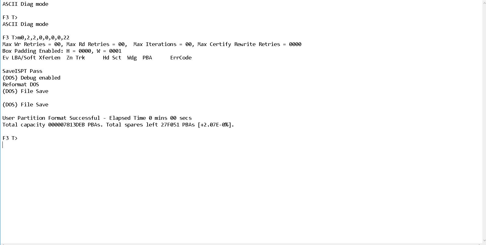

PostPosted: November 3rd, 2016, 13:23
Posts: 306
Location: Manchester, UK

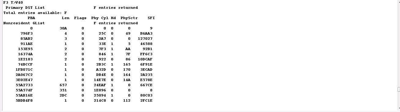

m0,2,2 etc command does not take into account information in the defect lists; not a good option for modern Seagate disks unless there is no other option. It is necessary to now rebuild the translator as I presume that data after a certain LBA value is no longer readable? If you have a full backup of the SA before m0,2,2 was run then it will help. What version of PC3000 are you using?
0161 408 4857
PostPosted: November 4th, 2016, 1:02
Posts: 548
Location: brisbane
:( :( :( DR is such complex thing :( :( :(
even erasing alt list is dangerous as not all sectors are added in translator, whatever you do in ultimate technical sense ( from guru's eyes) its not correct . :(
as cheadledatarecovery has suggested I will restore SA backup first. But then detection will also go and again disk will become busy.
what should I do now ? :(
PostPosted: November 4th, 2016, 3:01
Posts: 3551
Did you look at V40 before m0,2,2? Look at your backups if NRG has entries. Or Restore everything and check V40. Then run m0,6,3 instead.
PostPosted: November 4th, 2016, 8:11
Posts: 219
Was anybody working with this drive before you? If you save all original modules, so just write back original ~002B module (FID 28).
PostPosted: November 9th, 2016, 2:15
Posts: 548
Location: brisbane
Hi Martin
I have confirmed no one has worked on the drive,
I have restored backed up modules then drive again lost drd dsc and become busy.
I tried to recover translator from LBA 0 , process continued till few thousand sectors were left. But disk gave FORK errors and reading was by single sector.
So I stopped this process.
After that disk again got detection with full capacity , but still disk was giving read errors.
So I tried regenerate translator instead of recover translator. Still no normal access to sectors is established.
Somehow this has something to do with translator.
Now I will run m0,6,3 and report outcome.
PostPosted: November 9th, 2016, 9:19
Posts: 219

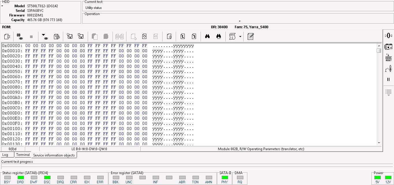

Write back original module 2B, after that T>F,,22, power off - power on, ctrl+x and bring report here.
PostPosted: November 15th, 2016, 7:10
Posts: 548
Location: brisbane
Thanks Martin your diagnostics & suggestions were right. I did as you suggested ,( I just opened Module 2 B and saved it.
Then I run m0,22 & disk gave smooth access.
I was able to recover 13.3GB photos of customers daughter , I did not charged customer for this recovery.
All credit goes to Martin . A big Thank you :D
