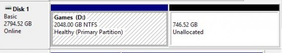

Soo, I hope this is an easy question for you guys to answer buuuut, I have a 3TB HDD from Toshiba, which is supposed to be exactly 3TB's. BUUUUT, it shows me this in Computer Management, in Windows 10...
File comment: what the heck toshiba
I can't even create a partition using that unallocated space. The options are just GREYED OUT!.
Should I send this one back or am I doing something wrong?. Thanks bros!.

you need to initialize the disk as GPT (GUID Partition Table).
read here:
https://support.microsoft.com/en-us/kb/2581408

backup data on the drive
go to Disk Manager
right click on Disk1 and select Convert to GPT Disk

I suspect that DMDE (freeware disc editor) may be able to convert between MBR and GPT non-destructively, but it requires a little knowledge and manual manipulation.

It is better to delete old one and create new.
