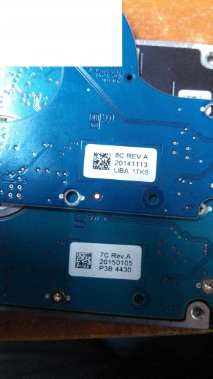

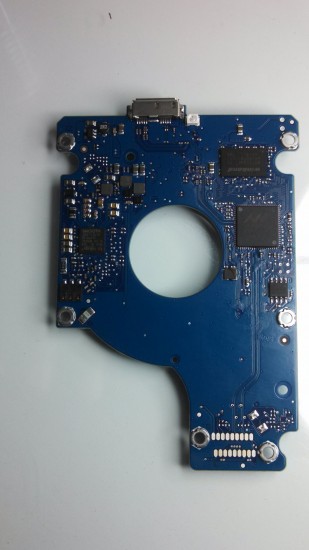

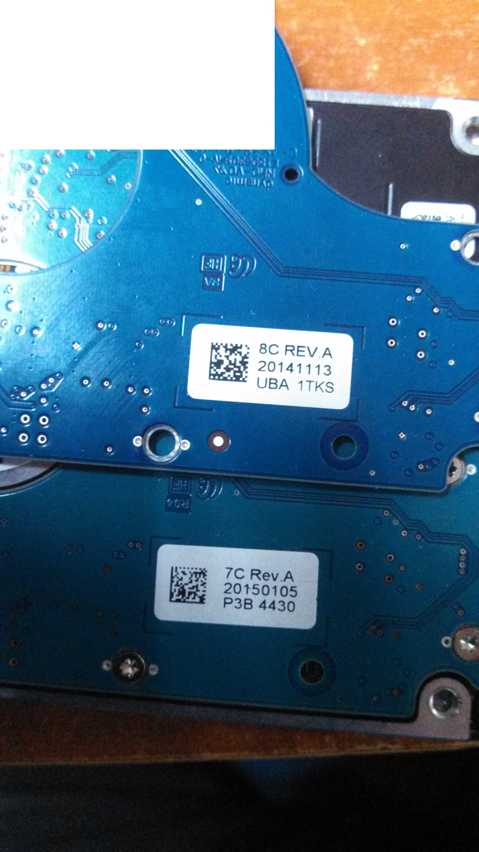

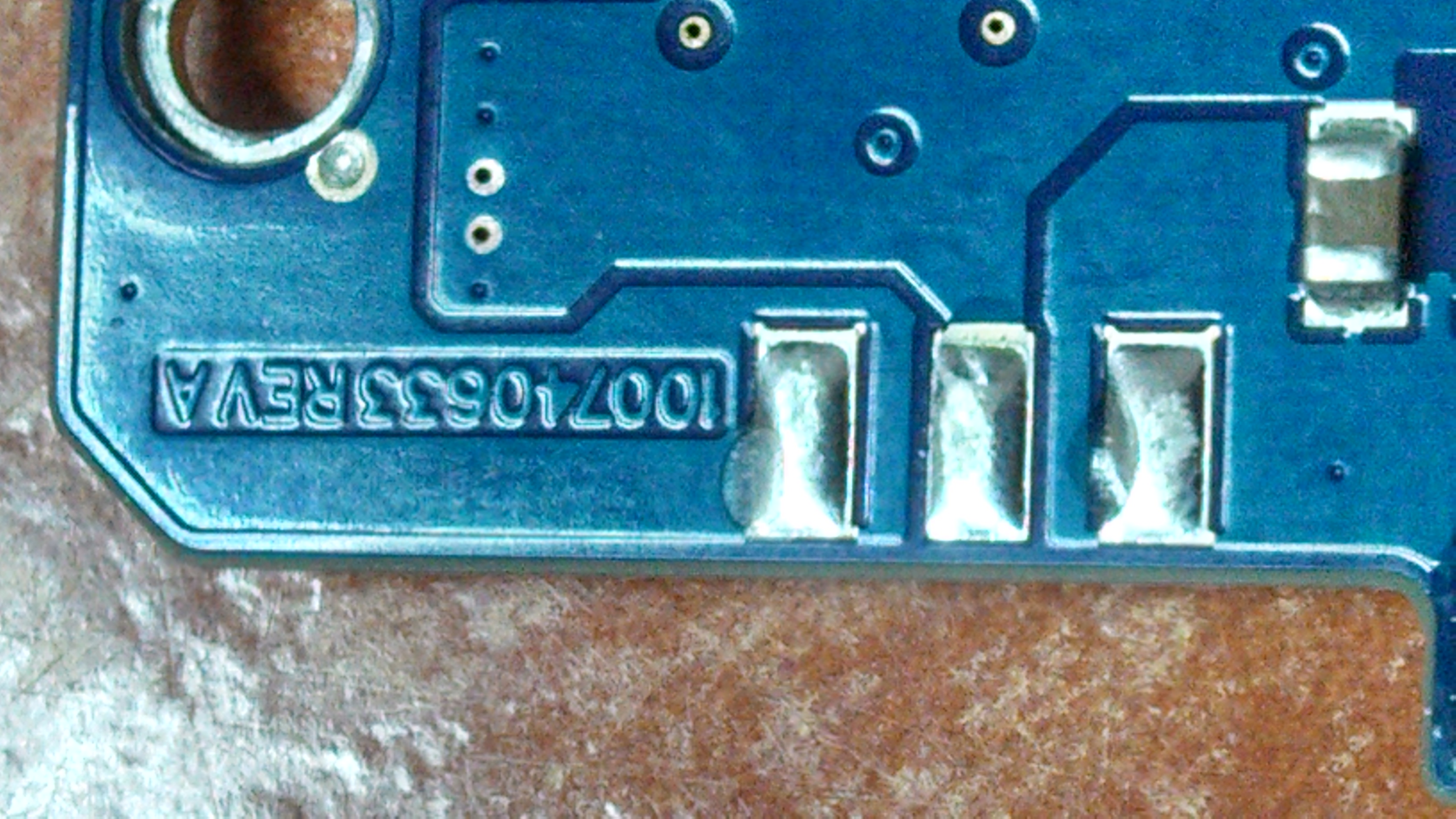

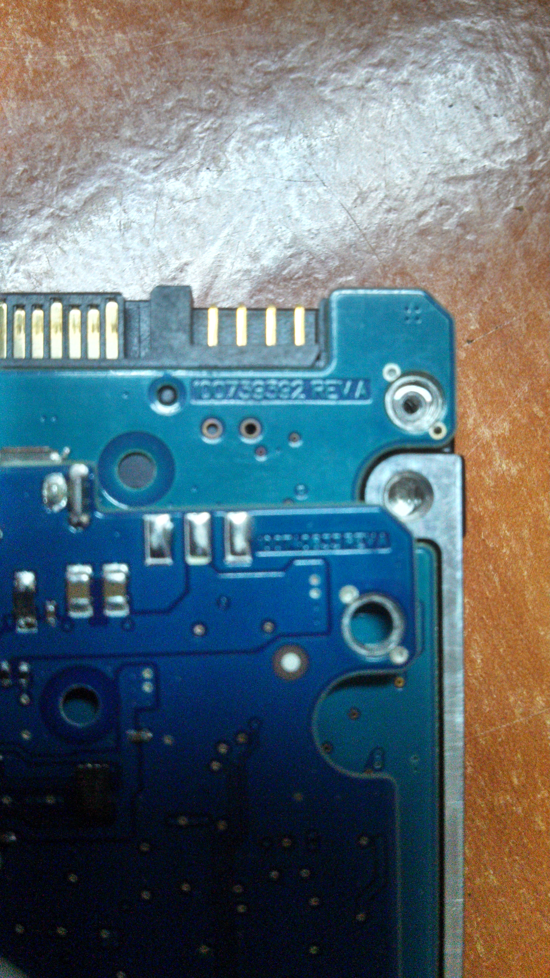

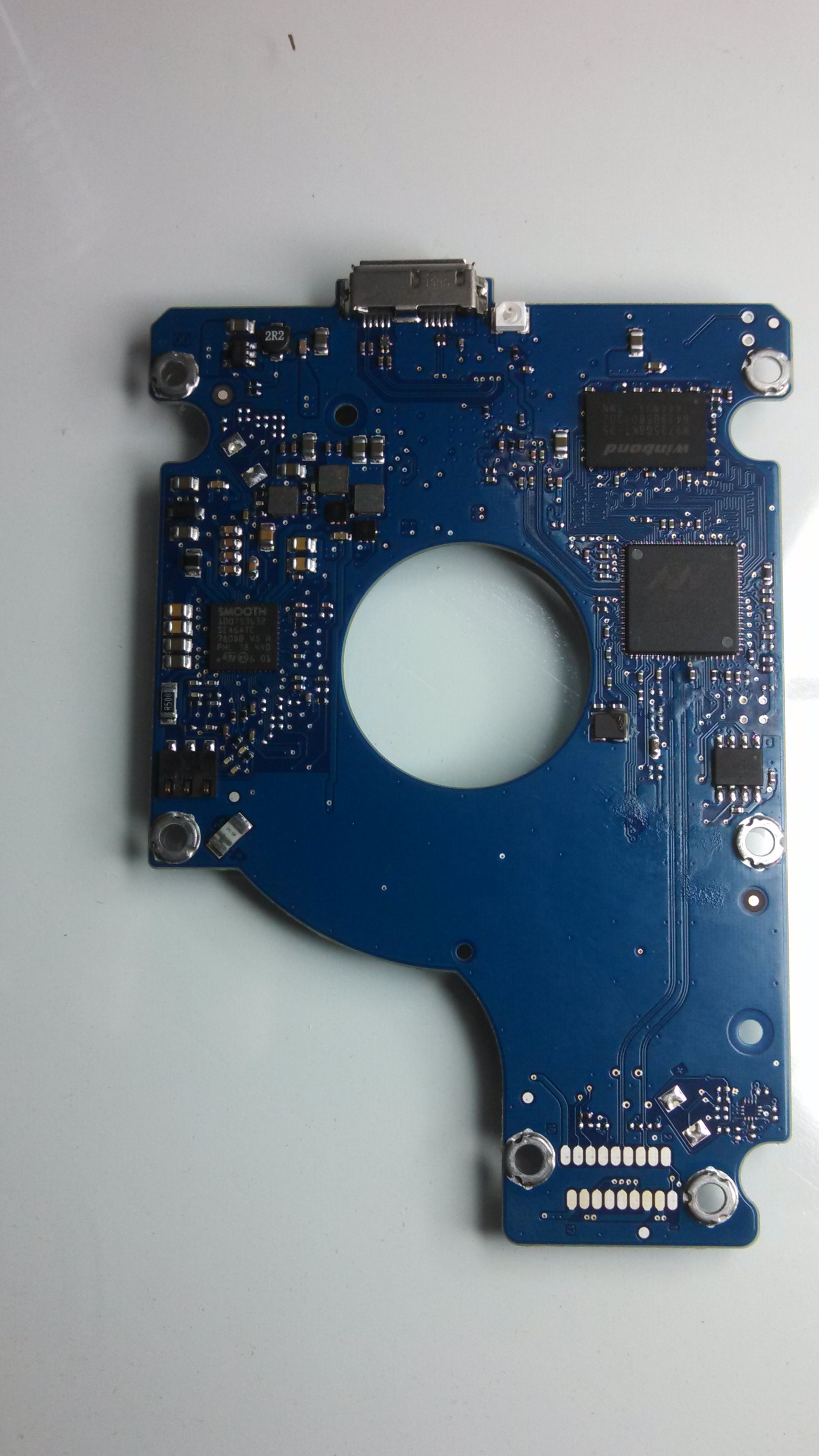

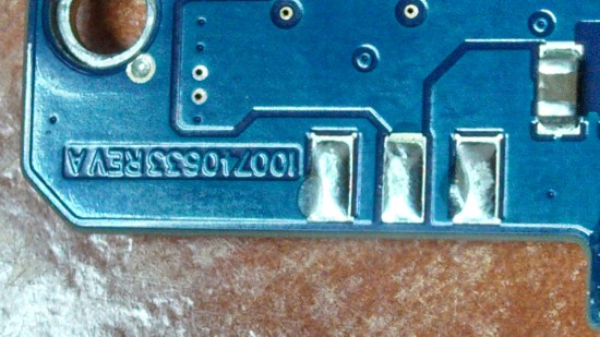

Thanks a lot Mr Fzabkar And Mr Amarbir for your attention . and sorry for last day i could not upload pics . now the latest is ... I have fixed my problem my own :) but i like to share with you guys . i am attaching Pics . i recovered data successfully

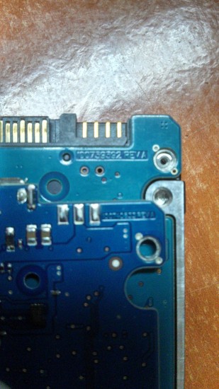

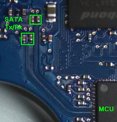

Just FYI, these are the SATA coupling capacitors:

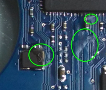

BTW, Samsung's USB drives are affected by poor soldering. I have seen several cases where reflowing the power related solder connections near the USB connector recovers the PCB. That would have been my first point of attack before searching for a new PCB.
(I'm assuming that the "fluff" near the crystal and MCU can be cleaned up and does not reflect some kind of physical damage.)
Thanks Fzabkar your point is Very important ! Actually someone worked on this drive before me. i know if there is some moisture,paste or oil etc near the crystal oscillator it can create effect on Crystal's frequency .... i always check Electronic components before swapping donor PCB or working on patient PCB . That PCB was useless when i attached SATA Bord thats why i did not clean. I appreciate your focus :).I guess you are good in electronics as you also pointed PF points for SATA . By the way, i was also discovered Tx+ve,Tx-ve,Rx-ve ,Rx+ve,VCC ,GND points on this USB card before you told me . But your attention is valuable for me and again thanks.

hi, thank you for your suggest, i'll try; another question, sorry, the upper capacitors shown in the previous picture, are for TX or RX sata connection?
