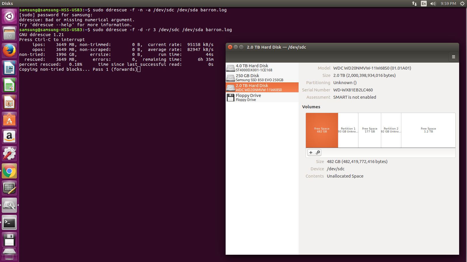

The drive stayed alive long enough to dump mod 02 and 32 in direct mode, but I think it died after I tried reading the modules. I checked them out, 02 looks like it needs cleaning but 32 looks clean. Attached is what I found.
Thoughts?

Data record #27:
61a: 00 01 02 01 80 0c 00 00 20 03 00 00 00 00 32 00 ........ .....2.
62a: 00 00 64 00 00 00 1e 00 00 00 05 d6 06 c0 12 00 ..d.............
63a: 00 19 00 00 00 01 01 09 03 00 00 00 00 10 00 04 ................
64a: 10 00 10 01 00 00 00 00 32 00 00 2c 01 ........2..,.
Offset 2 of record 27 has a value of 02, which can be an indication of the slow issue. Patch mod02 and then power cycle the drive. Don't worry about mod32, it does look clean.

 Post subject: Re: WD drive mounts but stops responding
PostPosted: November 15th, 2016, 23:01
Joined: November 27th, 2012, 21:59
Posts: 94
Location: Upstate NY, USA
WOW. So looks like this was a variation of slow fix. Patched mod 02 and it has stayed on longer than I have ever seen it before, so now ddrescue can go to town!!
PostPosted: November 16th, 2016, 19:36
Posts: 992
Glad to see that it is able to image now! The curious part is why you had to use direct mode in hddsupertool to get it to respond long enough to do anything like apply the slow fix. The reading of sectors by the OS must have been doing something to the drive, maybe aggravating the slow issue to the point of lock up.
