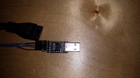

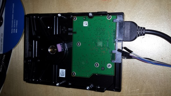

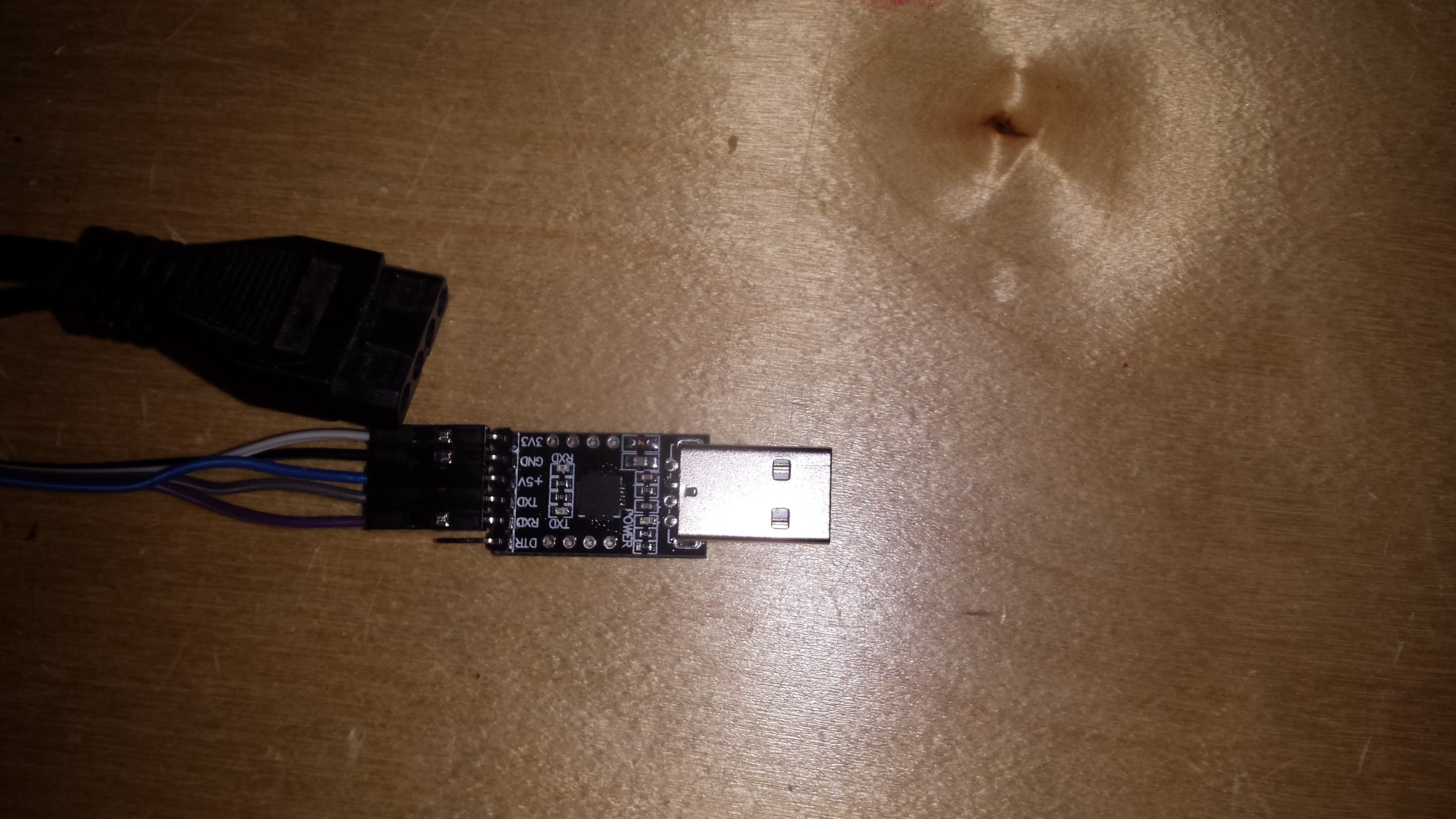

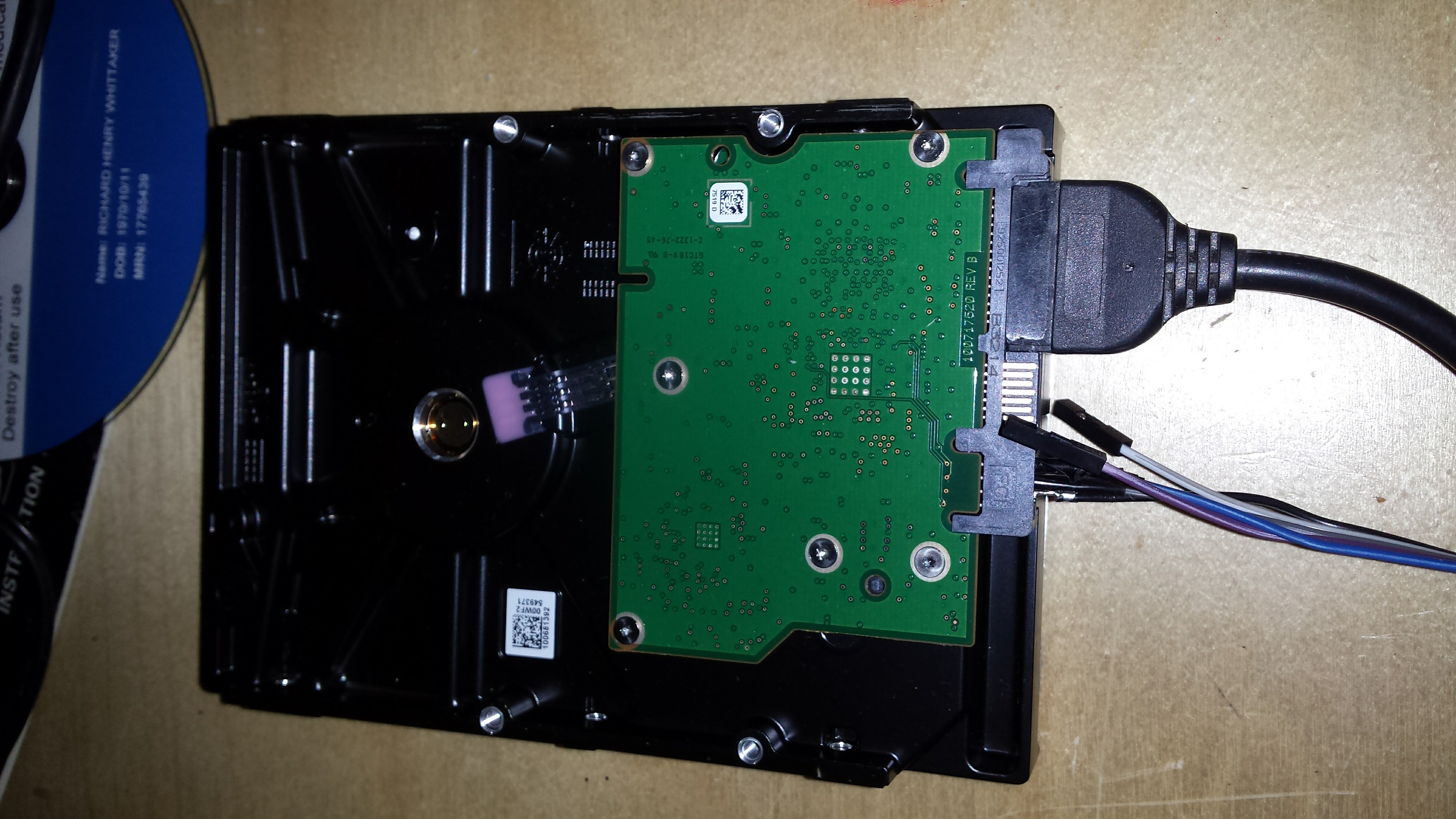

Hi there. I hve been running the above mentioned drive for about a year and a half, and it has stopped responding to my Linux File server, but the drive still appears to be "alive" to LVM. I am trying to connect a TTL adapter to the drive to see what diagnostics I can obtain.
I purchased a CP2102 TTL adapter from eBay:
http://www.ebay.ca/itm/130683943875?_tr ... EBIDX%3AIT
When I connect the TTL adapter to the drive, I get nothing back through PuTTY, double checked all settings, and tried both 19200 and 38400, 8N1 No F/C. When I measure ground to TX on the drive side of things, I get 1.78v back.
I have seen a few posts on needing to make a mod to get the adapter produce 1.8v, but those were all serial mods. Would I just do the same mod on my TTL adapter? 22k or so from 3.3v to TX pin, and then diode from TX pin to line to drive?..
I just want to make sure I am taking the right approach before I break out the soldering iron.
Thanks!
Richard.

Your adapter has a 5v output pin ( blue ) .Why are you connecting the 5v pin to the disk ?
You must connect only TX, Rx and GND. From your second picture, violet, dark gray and black. That is, supposing the 5V didn“t fry something in the pcb.
Also, with that adapter, it *could* work without a converter ( YMMV ). But you can search here for a converting circuit ( that based on a kindle adapter works ok ) just to be sure.
 Post subject: Re: ST2000DM001 FW cc27 issue
PostPosted: November 21st, 2016, 17:43
Posts: 488
Location: US
It's 3.3v adapter. You need 1.8v adapter.
