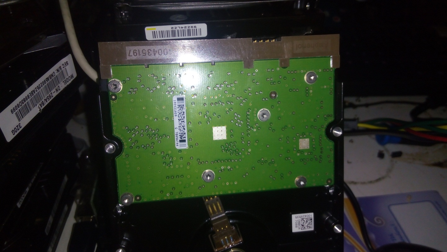

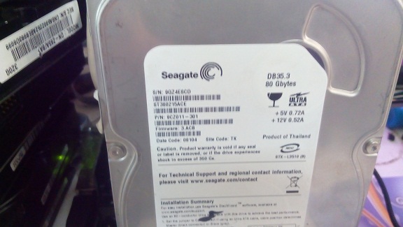

I Have Problem ST380215ACE Cases Read Ver Retry Sys After That Show Message Unable To Load Overlay
And After Selfscan If Message Ok End Test 4F Hdd Stil Damaged But If Message not Ok End Test 4F, Hdd Can Repair Like Ab End Test 50
Or Ok End Test 50
For Finish Selfscan Message Ok End Test 4F Only Need 1 Hours Hdd Stil Can't Fix It
For Finish Selfscan Message Ab End Test 50Or Ok End Test 50
Need 8 Hours Or More Hdd Can Fix It
Some Harddisk With Cases Ok End Test 4F I can Sucses Repair With F Level Repair And If This Fails,
I Try To Used Mod Firmware Harddrive Sata To Hdd Pata
Or I Try To Command I4,,22 To Detected Hdds
But Many Hdds With This Problem I Can't Repair
If Show Message Error Skipping Track After That Show Ok End Test 4F Selfscan Done But Hdds Stil Damage
Can Repair Track For This Series ?
Or Any Solution For This Problem Thanks
