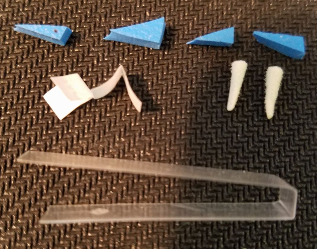

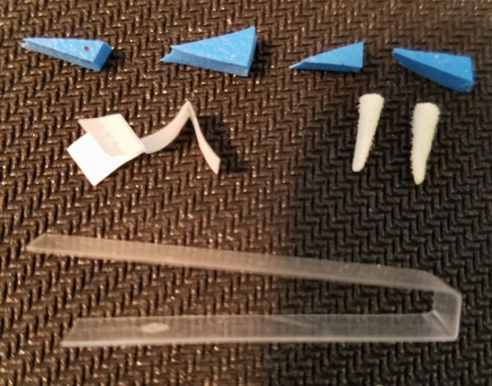

 Post subject: Re: Head Swap on a st3000dm001w/o tools
PostPosted: November 28th, 2016, 17:39
Posts: 248
Location: SXSW
Part of my head swap tools.... :)
15271945_10211683026130679_9195009664704444597_o.jpg [ 298.6 KiB | Viewed 11244 times ]
