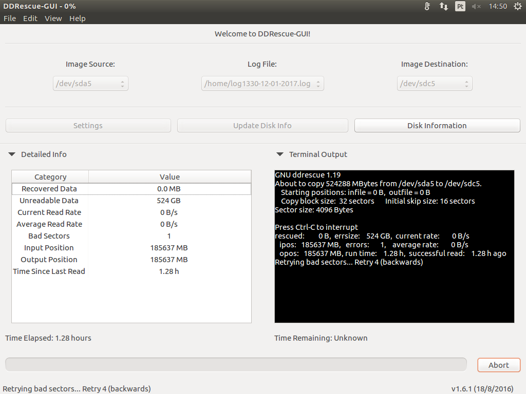

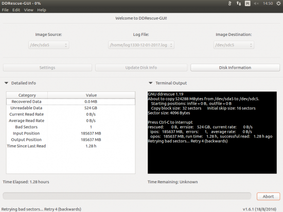

I'm trying with ddrescue but with no good results for now. Ddrescue reads the HD and initially identifies a bad cluster. From there it only indicates what the photo shows until the final reading of the partition.
Am I doing something wrong? Any configuration? Or as soon as ddrescue identifies the initial bad cluster it can not read anything else? The curious thing is that R-studio and Stellar Phoenix identify the whole root, retrieve the files, but empty.

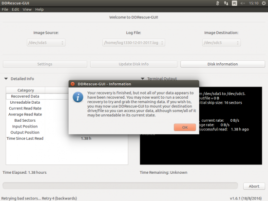

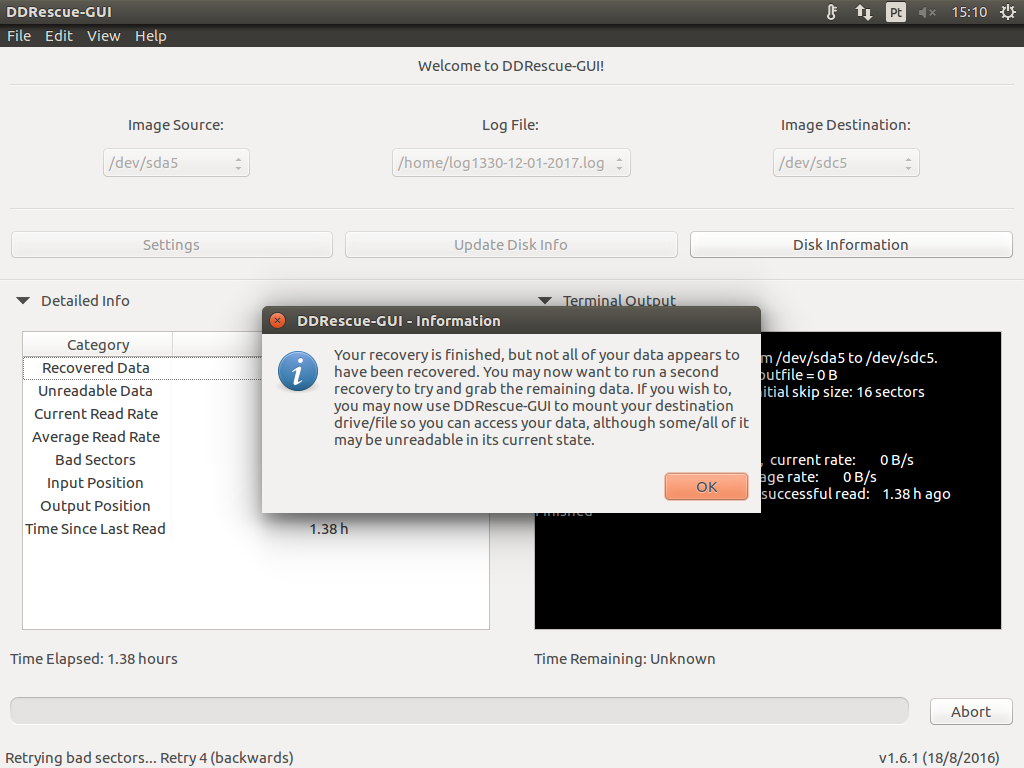

At the end, ddrescue shows me the message of the second photo.
Can somebody help me? Thank you very much.

First, you are using partitions as source and destination (source /dev/sda5, destination /dev/sdc5). This is usually not a good idea, you should always clone the entire disk (source /dev/sda, destination /dev/sdc).
Second, ddrescue did not read any data at all. Maybe if you try to clone the whole drive you will get different results. It would be interesting to see if it hits a sudden point where it just stops reading.
Due to the high speed for which ddrescue processed it, the errors were not normal sector errors.
There are a couple possible reasons no data was read.
1) When a bad spot was hit, the drive faulted out. Ddrescue has no way to tell if this happened.
2) There is a firmware issue with the translator.
Your SMART data does not show any reallocated or pending sectors (hddregenerator can't clean that up, can it?). And this is a Seagate DM series drive, which everyone on here will tell you are junk and have a high failure rate. You can keep trying, but this case may likely require professional data recovery. The more you thrash on it, the more damage can be done.
http://www.hddsuperclone.com
Home of HDDSuperClone

Glauco wrote:
Ddrescue quickly reads the entire partition. It registers 1 bad sector, and after that, no more data is read.
It seems that this 1 bad sector puts the drive in BSY state or whatever, since its your drive, then your data your choice... I hope you don't have valuable data on it
That said
Try to clone the drive in reverse to avoid that bad sector, or even better, I would suggest - since you said there is a lot bad sectors - use dd_rhelp, its designed for a case like yours - when there is bad sectors that cause the drive not to respond - the next time you launch it, it skips automatically that area and continues from another area (or in reverse).
Again a pro DR who uses hardware imaging would be your better choice for an unstable drive like yours but...
Regarding the translator you asked, "spildit", here he comes, and will provide with some valuable stuff to read about that.

maximus wrote:
Glauco wrote:
jermy wrote:
IMHO you should stop hammering the drive using a PC/software, its time to send it to a DR pro, who have the right knowledge and equipment to handle it properly, (the more so if its not your drive and doesn't belong to you, is it ?).
The drive is mine, I'm enjoying learning about it. I want to become a pro.
Thank you very much for your advice.
The big question is, do you need the data from the drive? If so, then I think you need to seek professional data recovery. But if the data is not important, and you are willing to loose it, then you can continue to experiment on the drive.
OK! Thank you very much for help!

jermy wrote:
It finds this bad cluster after reading the entire partition quickly. Apparently the disk continues to spin during the entire process, even after it has found the bad cluster. A disk in BSY state keeps spinning?
Thank you

Glauco wrote:
jermy wrote:
Thank you
Yes it does
