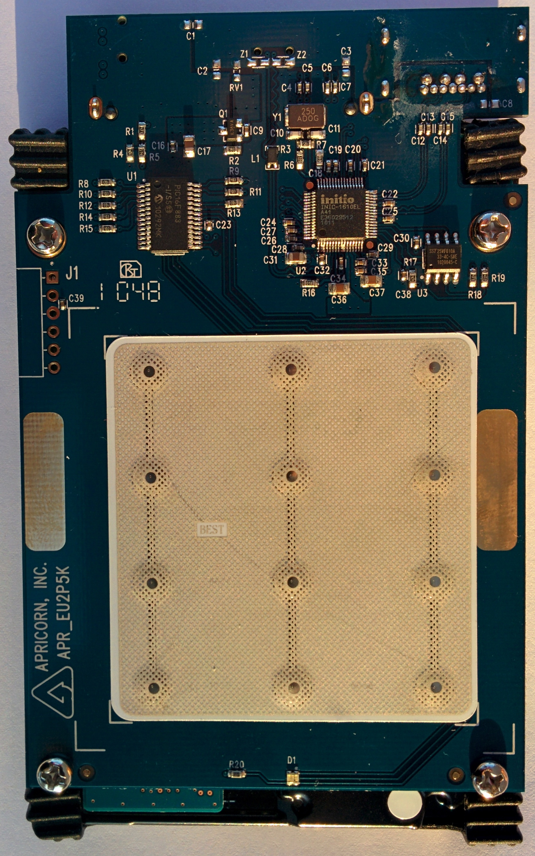

I'm new here and I don't know if this is the right place to ask. If not please move this post to the correct forum.
Anyway,
I had an "incident" with an external HD enclosure that encrypts the HDD.
I don't know what happened exactly but I have come to the conclusion that my only hope of ever seeing my 70GB of data again is to do some hardware hacking.
The enclosure has a pesky 8MHz PIC controller and at first I thought "that's impossible", an 8 MHz PIC can't possibly encrypt a 1.5 Gbit data stream in real-time.

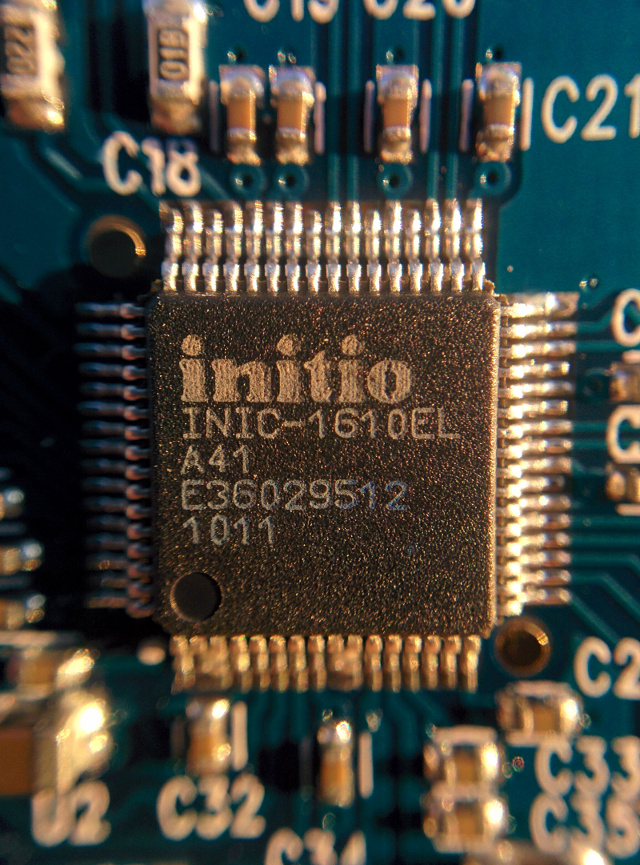

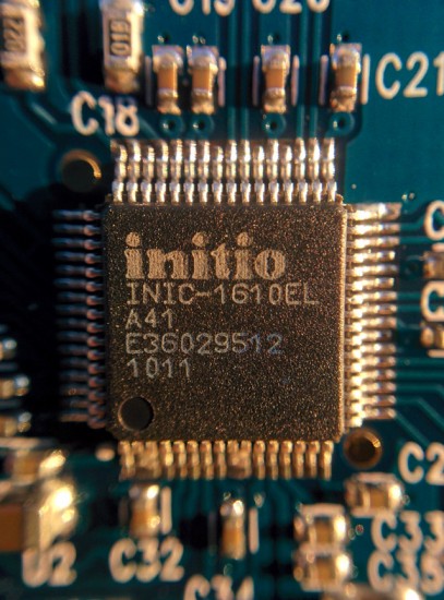

Then I found that the USB/SATA controller INITIO INIC-1610EL supports AES encryption.
There is also a 1Mbit memory chip that seems to be connected to the USB/SATA controller instead of the PIC. My Guess is that something related to the encryption key is stored on that chip.
My first problem is that I can't find the Specs for this controller. The manufacturer's website says "contact us", and that goes to a dead link. Also, I'm not sure they'll give it to me if I tell them I want to use "untraditional" methods of getting to the data on the HDD.
Has anyone gotten a copy or know where I can get the specs for this chip INITIO INIC-1610EL ?
Thanks,
 Post subject: Re: Looking for controller INITIO-INIC-1610EL specification
PostPosted: December 8th, 2016, 15:27
Posts: 17225
Does this thread relate to your device?
viewtopic.php?f=1&t=27531
The PIC may be a keyboard decoder.

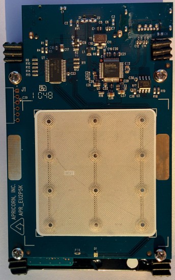

Hi Fzabkar,
yes, actually this thread you pointed out was the reason I created an account here. Reading the comments I figured out that people here might be of help.
What I have is the "Apricorn Aegis Padlock Pro" 500GB.
I think this is the oldest models of the Aegis Padlocks.
Apart for a chip that is marked "250 ADOG", There are only 3 chips on the board.
INITIO-INIC-1610EL - The USB/SATA controller
PIC16F883 - I/SS - Flash Based 8 bit cmos microcontroller
SST 25VF010A - 1 Mbit SPI Serial Flash
I already found the specs sheets for the memory and the PIC, I suspect the "250 ADOG" is not a logic circuit.
PostPosted: December 9th, 2016, 1:56
Posts: 17225
It appears to be a 25MHz crystal.
PostPosted: December 9th, 2016, 2:09
Posts: 17225
KeyInspector wrote:
I had an "incident" with an external HD enclosure ...
Could you elaborate? Does the HDD still spin up, both inside the enclosure and outside?
Have you measured the voltages on the filter capacitors near the Vcc pins of the PIC and SPI flash memory? There should also be a lower voltage supply rail in the vicinity of the Initio chip.
