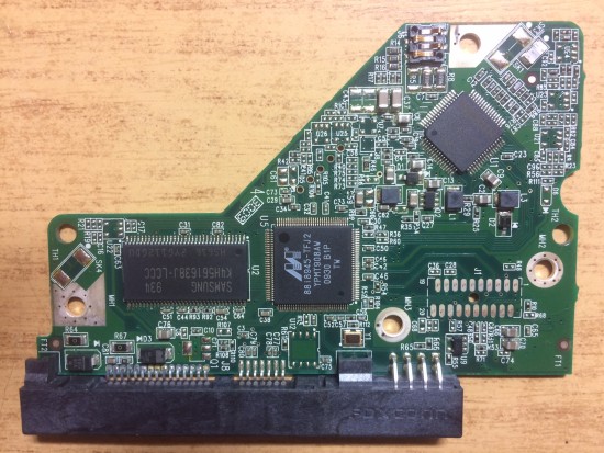

I'm looking for some assistance please with my external hard drive, I think it needs to go to a pro but I am a little apprehensive by all the articles I am reading on prices being ramped up for data recovery from hard drive issues once the drive is received by data recovery specialist, and therefore came to a place where I hope to find some guidance.
So the story, my water pipes running upstairs sprung a leak dropping some water into the room below which is my computer room. On the desk was my external hard drive (plus lots of other electronic stuff) running and powered on, some of the leaking water got into the external hard drive unit and has shorted out the pcb of the hard drive. The only item to get damaged (just my luck). Last backup was circa 2 years ago (I know, I know!) The PCB was removed and all evidence of water was removed and left to dry. I have then re-attached PCB and tried the 3.5" SATA drive in a pc and another external dock (known working) and the drive does not spin up at all. After many hours of reading I removed PCB again and have tested TVS diodes and also the zero ohm resistors, they all appear ok. This leads me to conclude that potentially there is some other issue / blown parts with the pcb stopping the drive motor from powering up. I've read up on this too and unfortunately for me the pcb is a newer (western digital, rebranded Magnetic Data Technologies) type without external ROM.

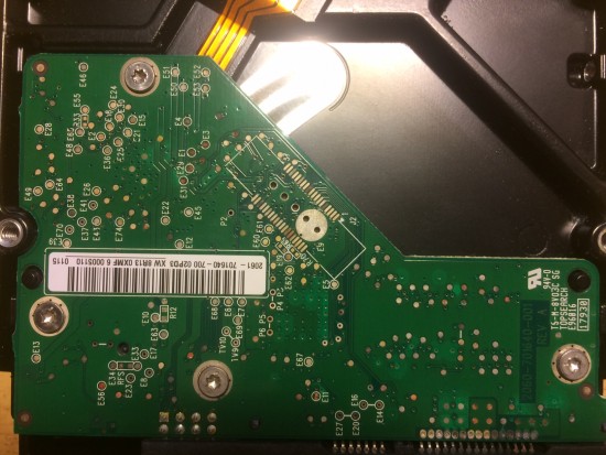

If you could upload detailed photos of the PCB, I could help you measure the voltage test points. That might tell us something about the nature of the fault.

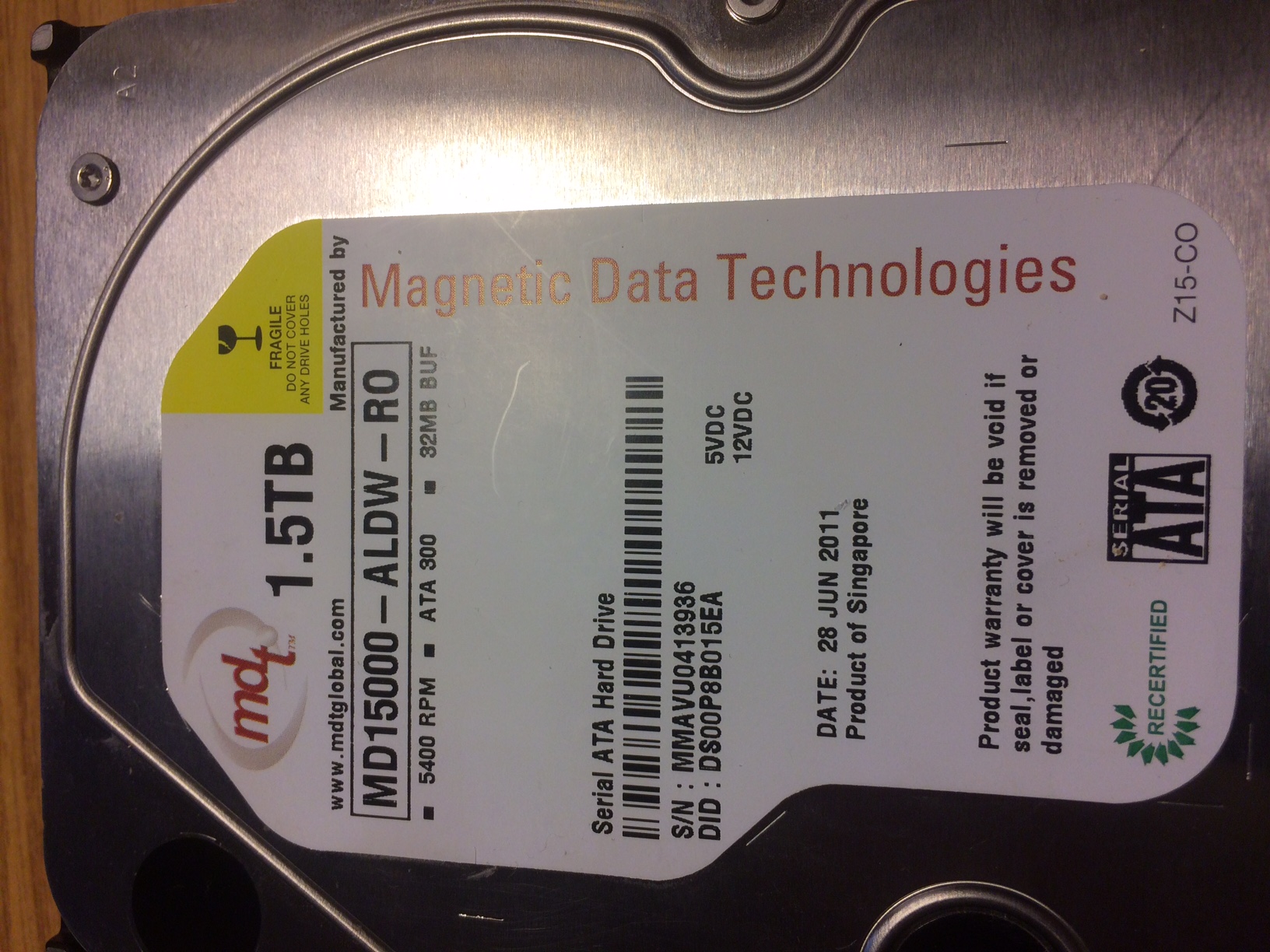

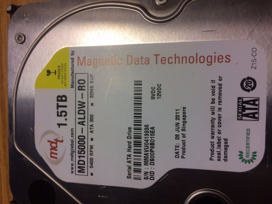

Spildit wrote:
What is the full model of the drive ?
Please see image of label

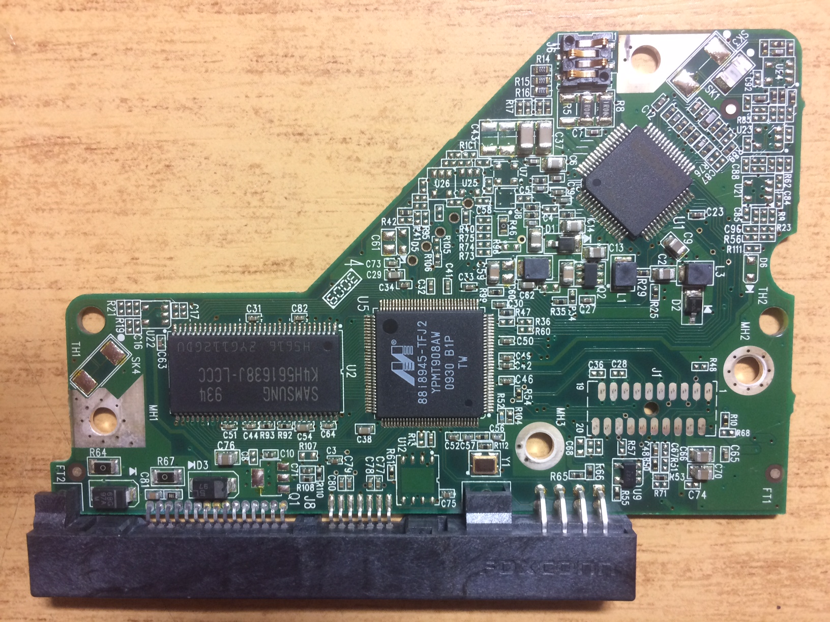

PCB image below.

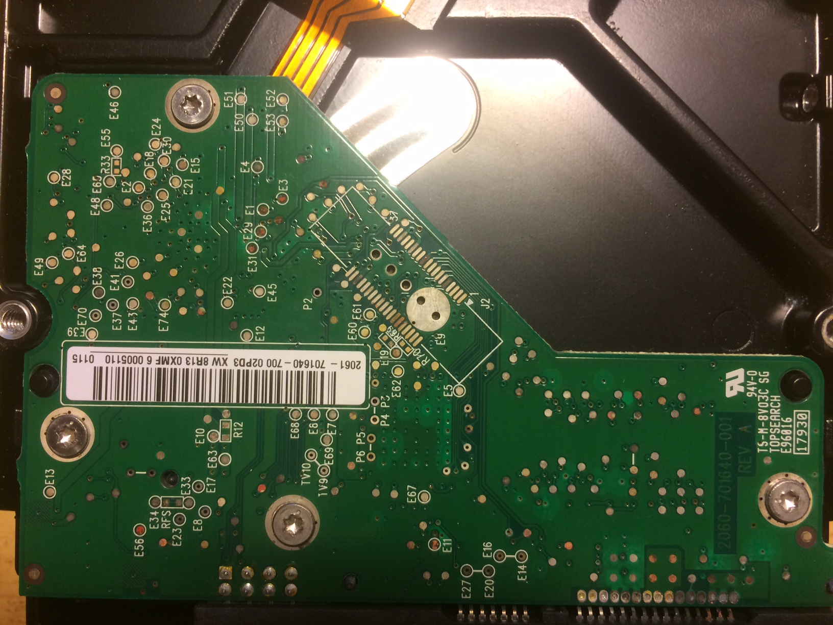

Could I see the other side of the PCB?

einstein9 wrote:
looks like a Refub. drive to me.
and Agree with lcoughey here. contact Sean in UK
good luck
Yeah, my thoughts too and I bought it as a new external hard drive (CnM), very surprised when i open the external case to reveal what I also thoughts was a refurbed drive. Bit naughty if you ask me....

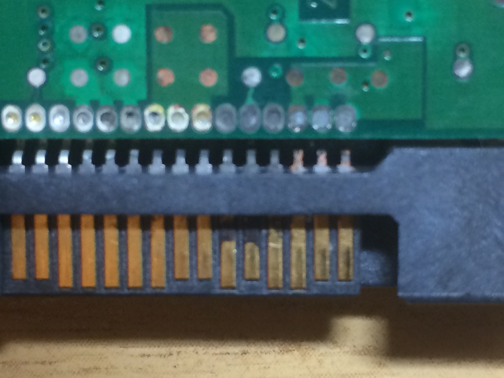

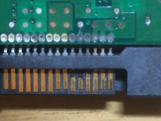

Back side of PCB, also close up of the 12v rail damage and blackening of 0v rail
Kevin

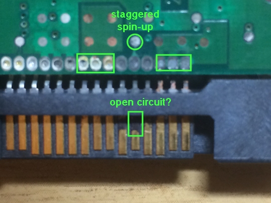

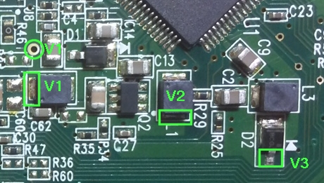

I would measure the voltages at V1, V2, V3.
V3 may come up briefly to -5V immediately after power-on and then disappear. This will be a sign that the MCU is looking for the preamp.
There is a "staggered spin-up" signal at pin #11. This should be grounded to spin up the drive. It looks like it may be open circuit.
Warning: Before spinning up the drive, please consider whether water may have entered it.
