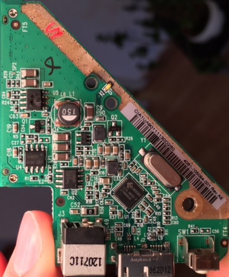

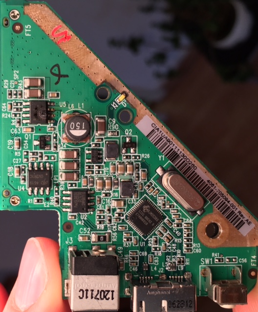

Hello folks,
the USB Controller board had an oversurge. Electronical Part U5 (left top) seems to be faulty. As far as I have understood the case the drive seems to be some kind of hardware encrypted.
    Is there a way to get the data back with repairing or even without repairing (identify the chip - desolder - solder new chip) the USB-Sata Interface?
    As I understood it the encryption key is stored in the SA (module 25)?
maybe a stupid question.. ;-)
    I made an Image with ddresuce but somehow the following information means that it is useless. Isn't it? Is there a way to make an proper image and determine the encryption key and get the data back without repairing or replacing the usb-sata adapter?

the faulty electronic component U5 seems to be the following:
2A, 23V, 340kHz Synchronous Step-Down Converter - Datasheet
http://www.farnell.com/datasheets/1782089.pdf
this picture helped - there I saw RT8284
https://cdn.discourse.org/wd/uploads/de ... 302094.jpg
Does anyone now a component which is compatible to RT8284?

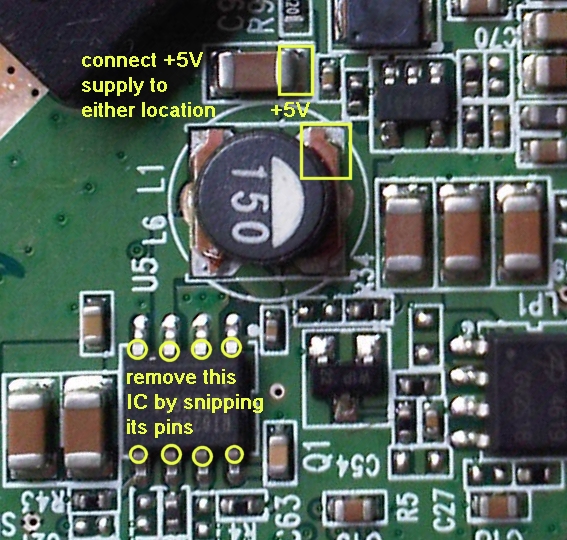

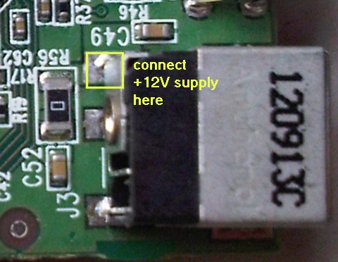

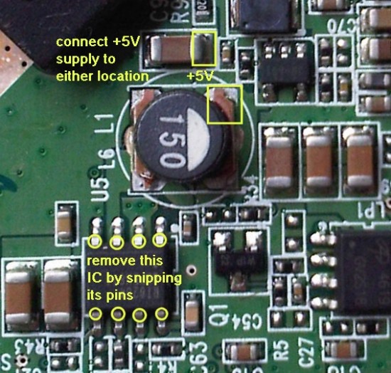

The DC-DC converter generates the +5V supply for the HDD. If all you wanted was your data, you could have solved the original problem with 3 wires. Just remove U5 by snipping its pins with flush cutters. Then run an external +5V supply from your PC's PSU to the load side of the 150 coil (L1). Also run an external +12V supply and ground from the same PSU to DC connector J3.
Of course an actual repair would be much more elegant. :-)

I have been asked to indicate the connections points for an external 5V/12V supply.
