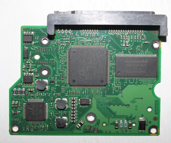

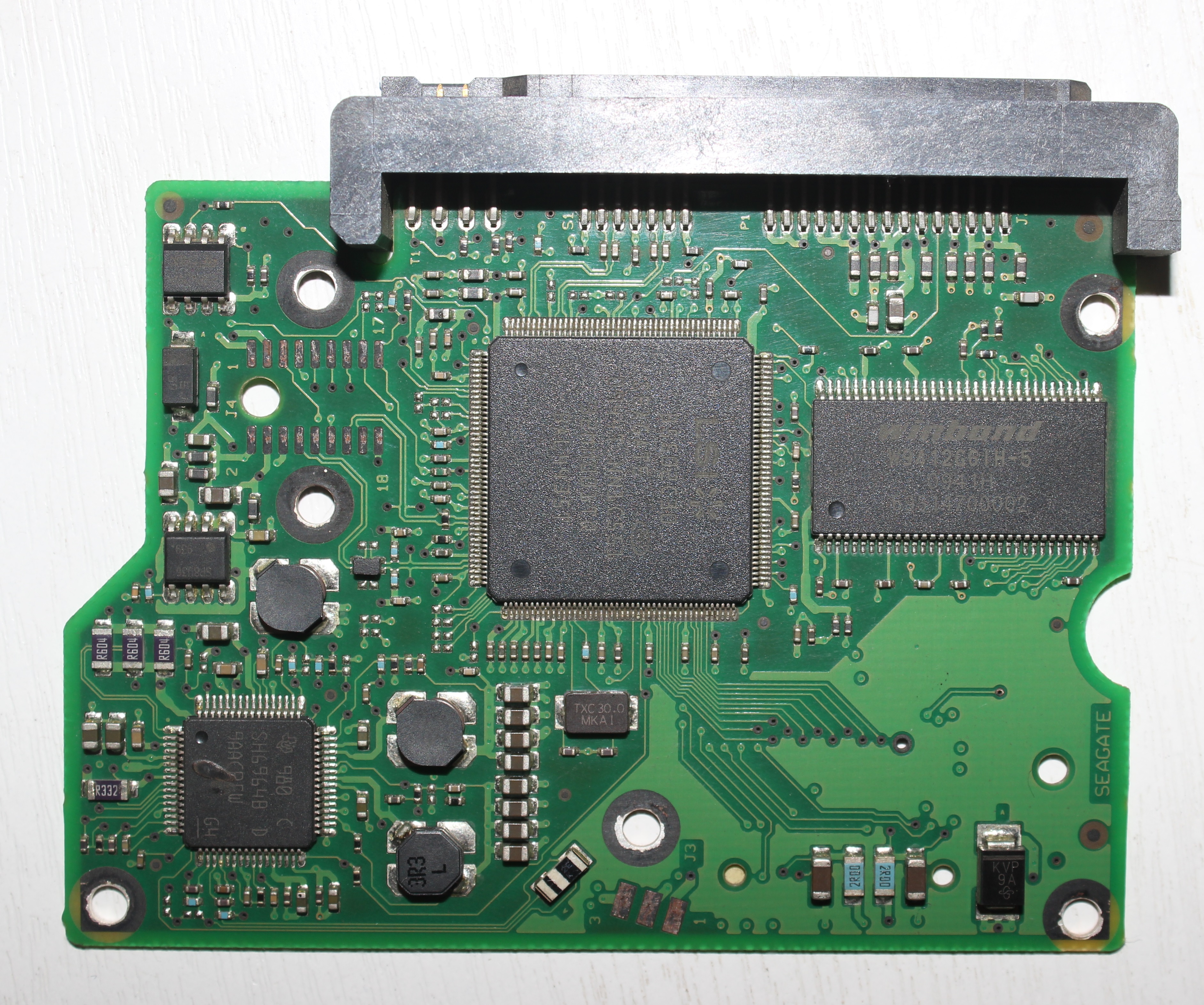

My very old Seagate hard drive died today, no signs of life, no spinning no noises, no detection, there were no issues with the hard drive, no bad sectors etc, it was working perfectly fine, even survived an airplane trip very recently in my checked luggage(was working perfectly fine after that).
I believe it may be a PCB problem but I would like an expert opinion whether there is something visually wrong with anything on the PCB. I myself am a computer science major but hardware is not my specialty. I dont have any tools to check the voltage etc but I have done the basic hardware diagnostic and there is no power going to the motor of the hard drive.
I have attached a high res photo of the PCB, Can you guys see any parts burnt or broken? there are no clear burnt parts but may be there is something I missed.

check sh6964b on left bottom side
it looks fried
find some DR near you to recover your data, if they are valuable for you

Yup, motor chip fried, maybe pre-amp damage needing headswap. Not DIY.

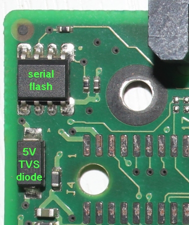

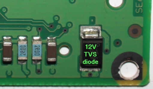

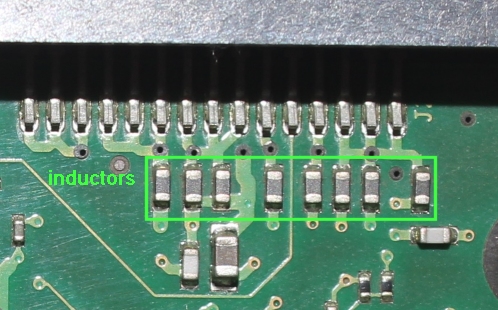

The 5V and 12V inductors look OK. This would suggest that the TVS diodes may also be OK, in which case the preamp may not have been affected.
ISTM that the failure of the motor controller may not have been a result of an overvoltage. Actual resistance measurements (of the TVS diodes) would help to confirm this. I notice that the preamp and motor contacts are oxidised, so I wonder whether this was a contributing factor.
Thank you for your reply, really appreciate it,
I have ordered a replacement board.
I just have one question, Can I just check whether the motor or (something other than the board) is faulty by just connecting the new board to the hard disk without changing the flash chip and see it if it spins?
Will that damage the data on my hard drive or will the drive even respond to the new board without changing the flash?
I just want to know whether I should go with the hassle of getting the rom chip replaced from the old board so i wana test whether it is actually fault of board or not.
