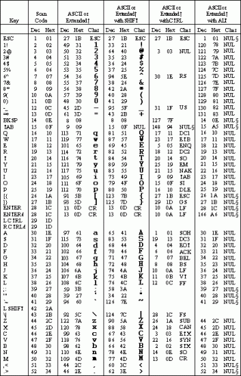

The laptop most likely uses keyboard scan codes rather than ASCII codes.
http://www.users.on.net/~fzabkar/MSKeyLog.TXT

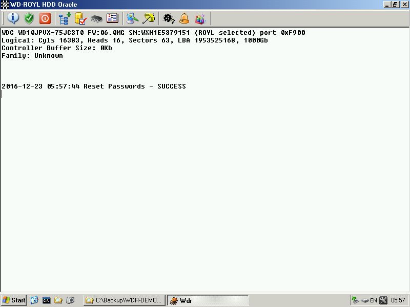

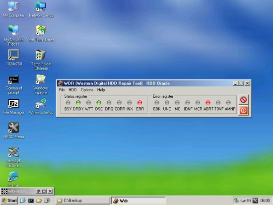

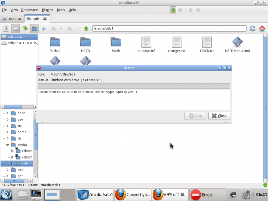

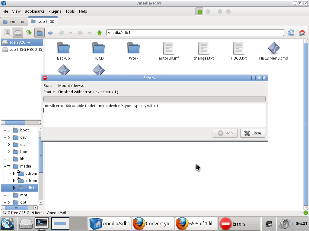

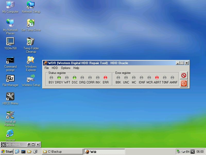

This is going to be long. Here we go.

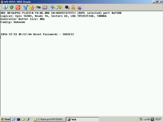

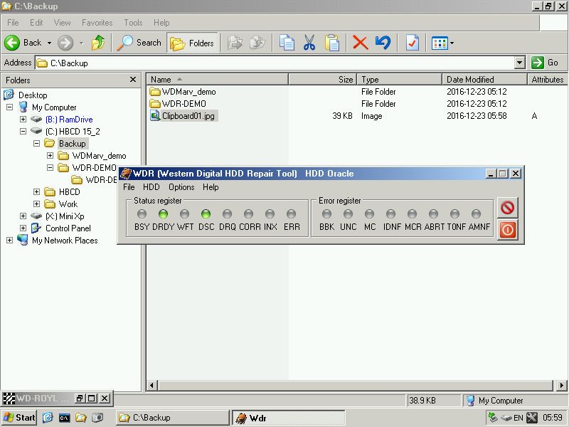

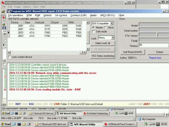

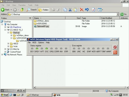

I tried to clear the password using the WDR Demo via Mini XP provided in Hirens Boot CD. (screenshots attached)

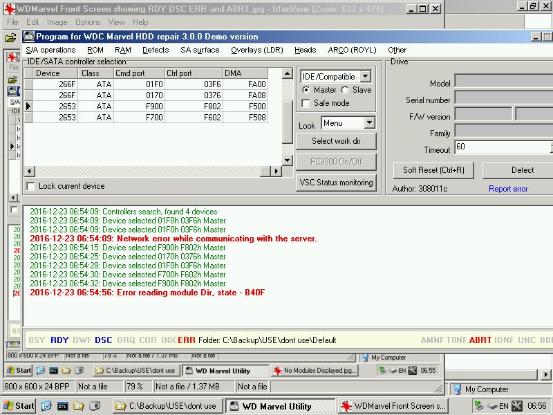

But my drive is still locked. Before I clicked on the Clear password menu, only DRDY and DSC was on green. After I clicked the clear password menu, ERR and ABRT too became alight in RED.
I booted MHDD (through Hirens Boot CD) and found out that my drive is still locked by an ATA Password.

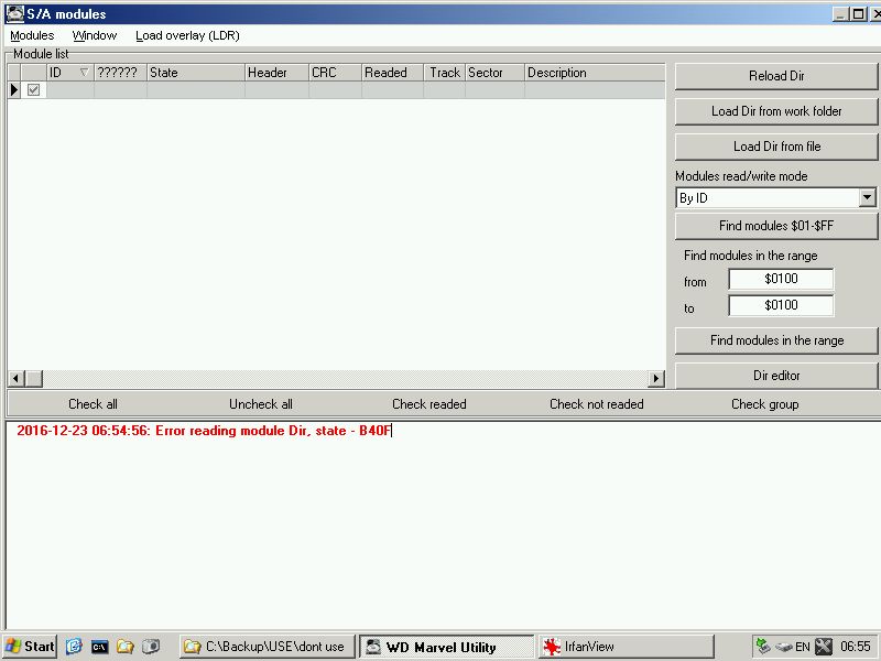

I booted Parted Magic (through Hirens Boot CD) and the drive was mounted into sda but when I tried to open it, I got an error- "Unable to determine device fstype - specify with -t".

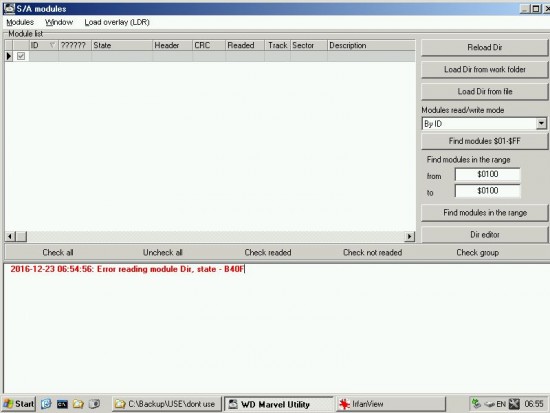

Now I boot Mini XP back and tried to read Module02 using WDMarvel. However I was unable to see any module to be able to read them. (screenshots Attached).
I didn't try the HDD Supertool as I didn't have a Linux Installation with me.
I appreciate the help so far. I learnt a lot about hard disks which I didn't have when I blatantly set passwords on them.
How do I proceed further?
File comment: Error screen while opening HDD in PartedMagic- sda 932 gb is the locked HDD.

File comment: However in WD Marvel, i am unable to see any modules to be able to read them.
File comment: WD Marvel after it detects the Hard drive
WDMarvel Front Screen showing RDY DSC ERR and ABRT - final.jpg [ 111.92 KiB | Viewed 21660 times ]
File comment: After Clearing Password - ERR and ABRT became alight in RED
File comment: Before Clearing password - only DRDY and DSC on green.
File comment: Password reset Screen.

The drive might be locked from SA access? You can run HDDSuperTool from Parted Magic on Hiren's Boot CD. It just needs to be provided on a USB stick, or from another drive connected to the computer. For USB you must run the USB mounting tool (on the CD) to mount the drive so you can access it (drives to not automount in Parted Magic).
Run the wd_royl_dump_mod02 script, and if it works you will have the password and be able to unlock it. If it fails, post the output from the script. If it is SA locked it will fail, but I can tell what command it is failing on from output to be sure. And if it is SA locked, I will have another script for you to try.

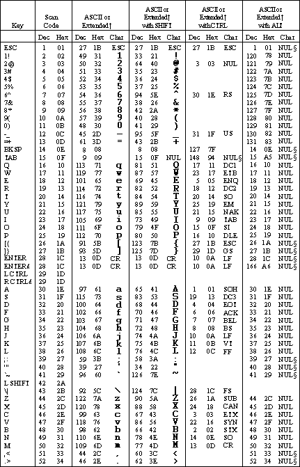

Simple key scan codes found here:
https://msdn.microsoft.com/en-us/library/aa299374(v=vs.60).aspx
The scan code column contains the number value for each key. If your password was ABC, it would be
1e 30 2e
in hex.

BAD NEWS - Your drive locks SA access when password is SET.
Good news - I DO KNOW A VERY EASY WAY TO REMOVE THE PASSWORD !!!
Or the OP can see the scan code table I posted and use that to find what the password is set to, since the original password is known. My 1470 uses this method and it was produced about the same time, so it would seem likely that the 1464 would be the same way.
