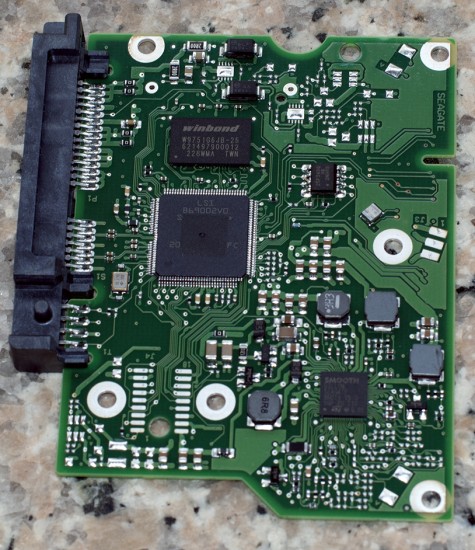

Hi, fzabkar,
Thank you so much. I know they are compatible. Now I had suspicion that the bios chip was replaced on purpose so that the data recovery guy can sure lock up this business.They took the harddisk to a room that I can only wait outside.
Anyway, I don't want them touch my harddisk again.

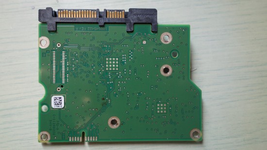

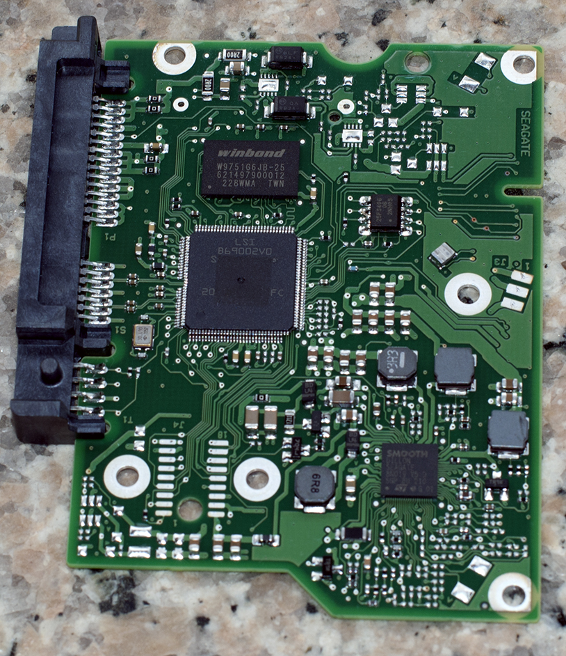

Here are the photos of the pcb.I would follow your advice strictly, quite new to this HDD world.
 Post subject: Re: Help with Seagate ST3000DM001
PostPosted: December 10th, 2013, 4:26
Posts: 17336
It looks like the chip has been swapped. It also looks like they cooked the board when doing it.
What are the numbers on the bottom line of the chip?
What is the date code on the drive's label?

Hi, Not sure the whether the chip is the original one, but they said they had to use the original one in another board with same model to judge.
And they insisted they have soldered back the original bios chip.
From my experience with PCB that it's not cooked, it's only rosin flux left.
the numbers on the bottom line of the chip is "102718BA".
Date code on the drive's label "12203" FW: CC98
Will it respond if I connect RX, TX with putty in this case? :?:
PostPosted: December 10th, 2013, 5:06
Posts: 17336
http://www.westernnetworks.com/tools/se ... ecode2.php
Date Code Year: 2012
Date Code Week: 20
Date Code Day: 3
Build Date: Sunday, November 13, 2011
The YWW (Year / Week) date code on the Samsung SDRAM chip is "134". That's week 34 of 2011.
The date code on your flash memory appears to be "1027". That's week 27 of 2010, more than one year earlier.
ISTM that they've returned the wrong chip.
And their workmanship is shoddy.

is there a photo of the board before you took it to them?
PostPosted: December 10th, 2013, 5:58
In my experience, these drives usually have a "FEON" chip as in the photo.
I don't believe they have given the wrong ROM chip back.
Unless I'm missing something, a new PCB (of same P/N) has not been fitted with this ROM chip transferred.
I would try this first before maligning the company for bad practice.
Also I wouldn't call their soldering "shoddy" because they've left some flux on the PCB. "Inelegant" maybe, but not "shoddy" :-)
PostPosted: December 10th, 2013, 10:32
Posts: 738
Location: Ottawa, Canada
It looks shoddy to me, ignoring the failure to clean up the flux residue. Looks like cold solder joints on at least one of the pins.

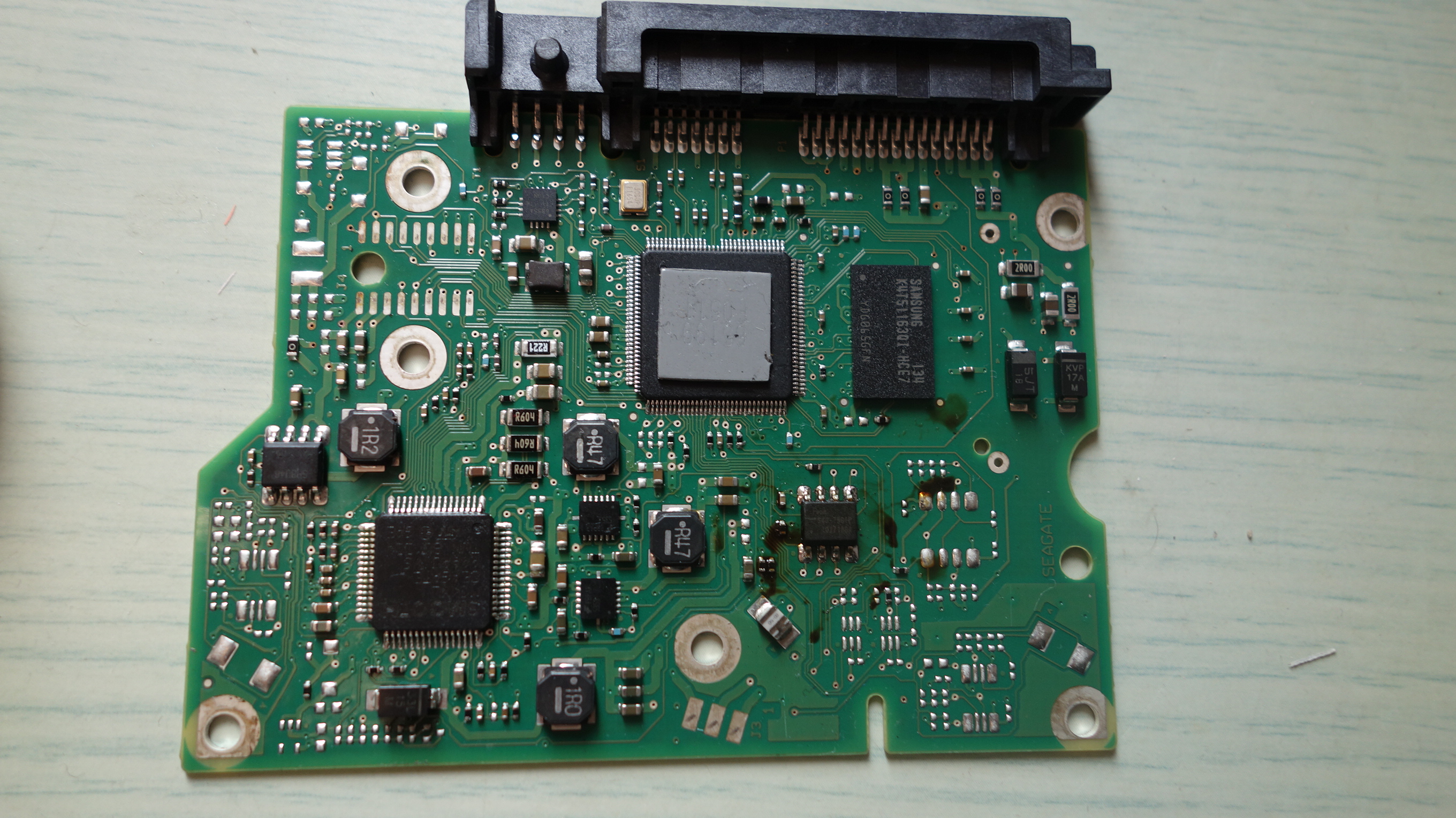

Ok, I didn't notice those cold joints! So I'll upgrade my judgement to "substandard" :-)
They obviously didn't pay great attention to replacing the ROM chip to the patient board before returning it after a quote refusal.
I still reserve judgement on whether or not they've deliberately switched the ROM chip until it's been checked properly. Of course there are some shiesters out there who would do this sort of thing after quote refusal, but I don't think (well, hope not) it's as prevalent as some would have us believe.
