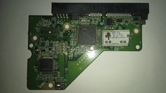

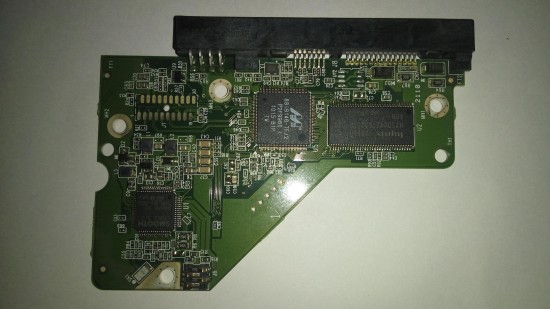

Hello.
I have a WD20EARS-00MVWB0 drive, 2 years ago it was damaged after a shorcut in power source. The PCB has no signs of damage, but drive does not detect or spin.
Now I tried to repair it. There was no important data on this drive. I found a replacement PCB in online store and bought it. Mine was 2060-771698-002 Rev P1, and I received 2060-771698-002 Rev A. Lot description and other online sources told that revP1 and revA are compatible.
So I transferred ROM chip and replaced PCB (and cleaned contacts by the way).
Now drive spins up, but then begins to repeatingly click for 3-4 seconds. Then it appears in device manager as WD20EARS, but in drive management I see it as "uninitialized". "Initialize" command results in "i/o error" popup.
Other disk management programs either do not see it, or report "invalid geometry" or zero size.
Question is:
- Is it a sign that something is wrong with HDD itself or ROM, and there's no point of fixing it?
- or could it be incompatibility of PCB (rev P2 and rev A)?

Could you show pcb's photos?

Here they are.
File comment: old PCB
File comment: new PCB
