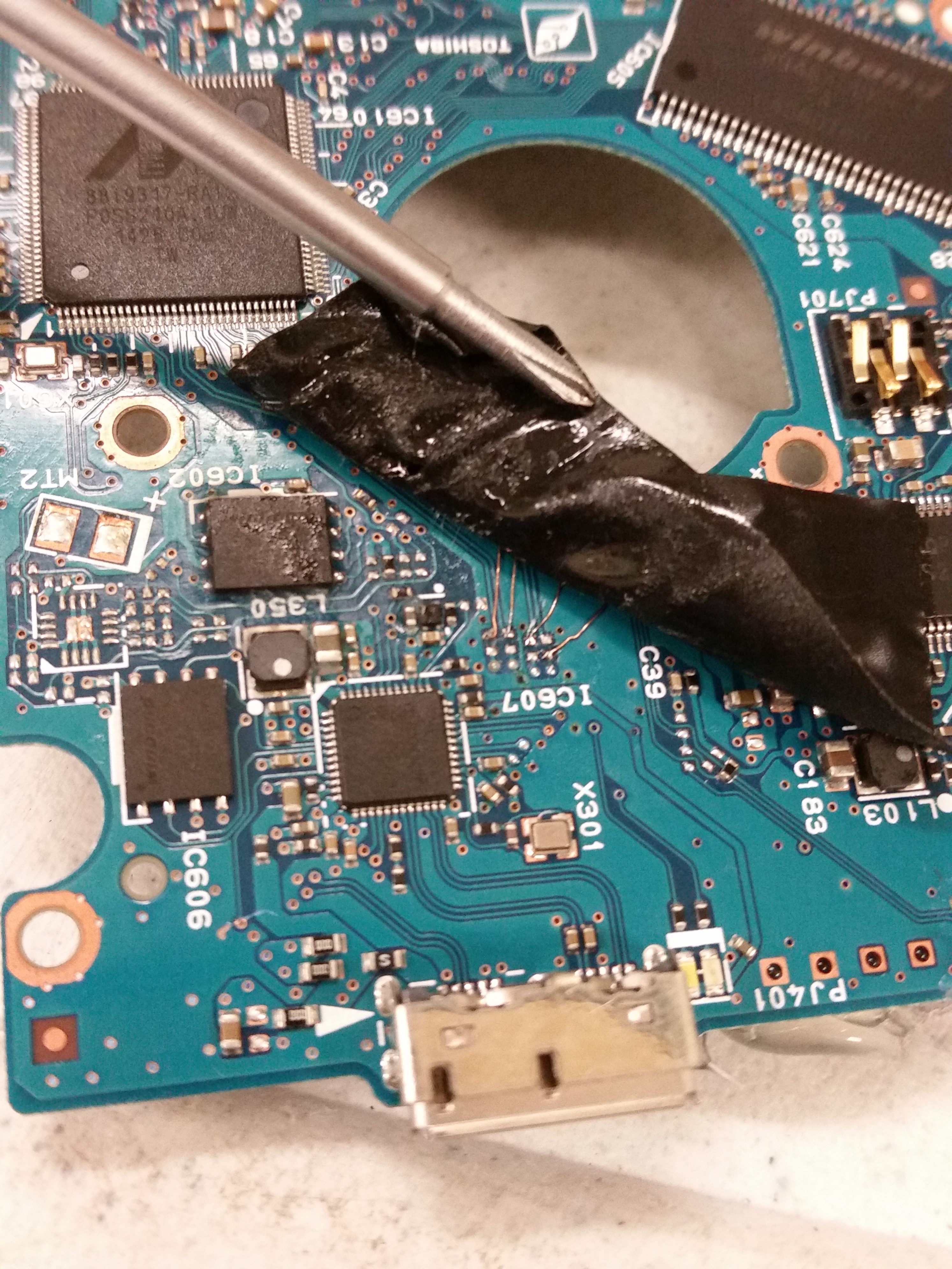

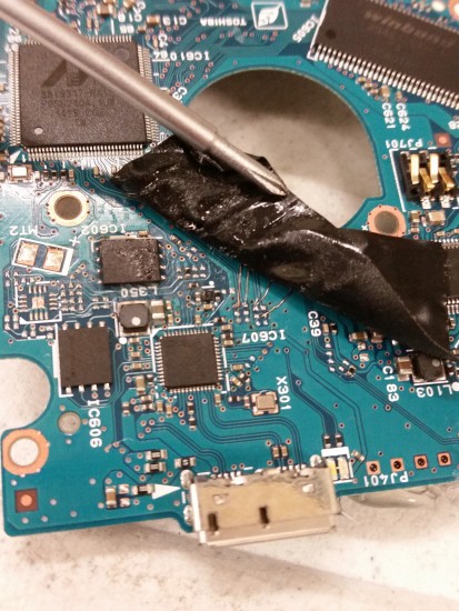

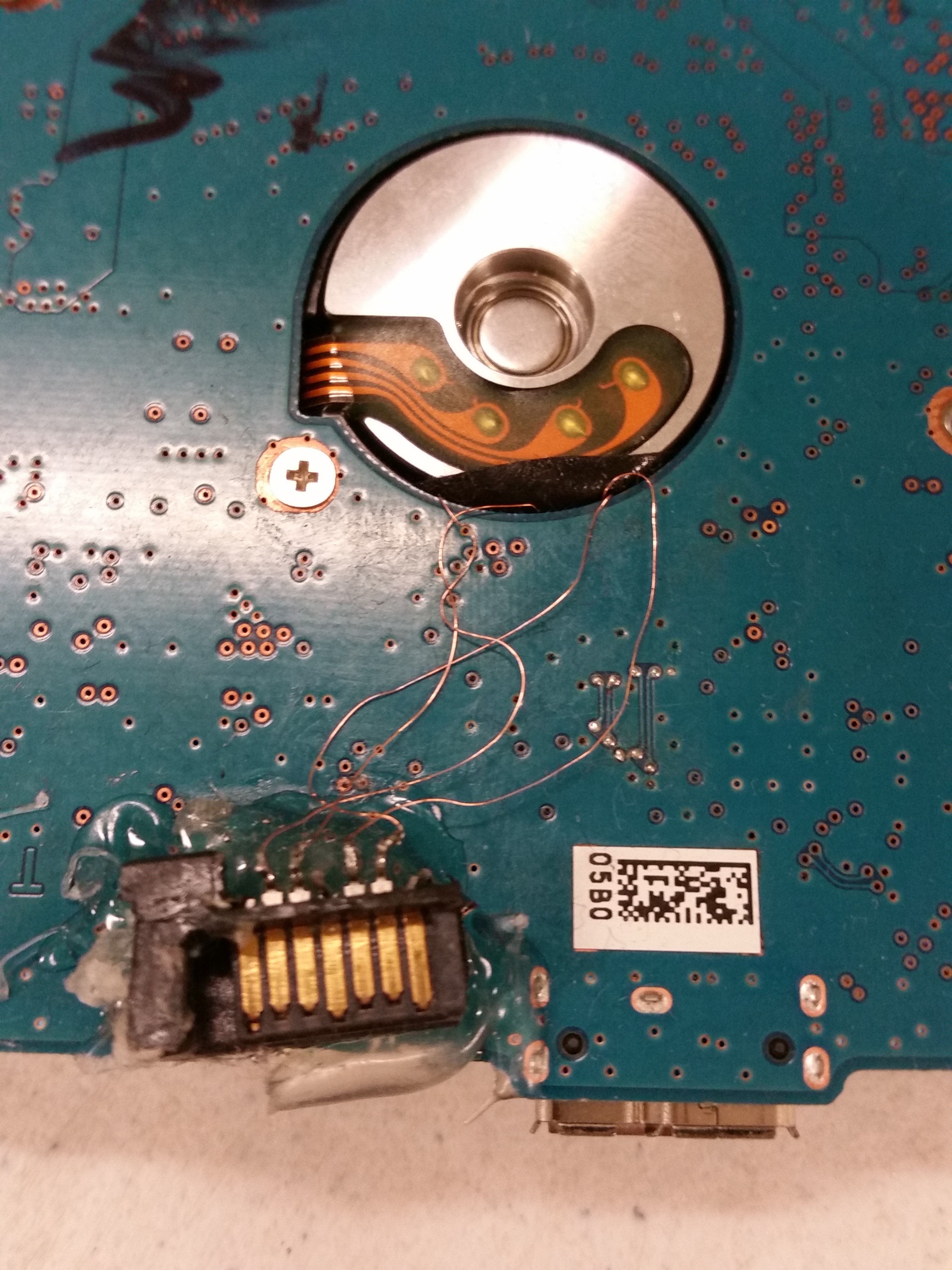

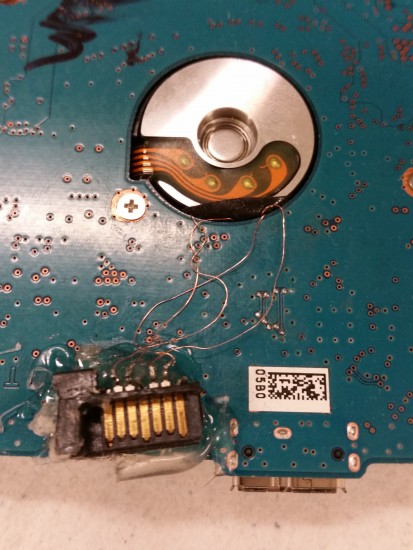

This is how i converted a Toshiba MQ01UBB200 USB board to sata. I located the sata points on the backside of the board but they appear after the pull-ups unlike WD which are before. Therefor i could not use the back side. I had to use monolithic wire to solder to the points on the bottom side and then wrap them around. I used usb for power/ground.
Good work!
But How you identify the TX , RX?
Expect, the Unexpected
 Post subject: Re: Toshiba 2tb usb portable drive sata conversion
PostPosted: February 8th, 2017, 8:39
Posts: 206
Location: Vienna, Austria
I would say you identify RX, TX by their characteristic 2-paired length-matched differential routing on the mainboard. When you see 2 pairs of LVDS lines on a HDD/SSD PCB, then it's most likely SATA RX/TX. I would suggest you take a look at some of the YouTube videos on differential routing, then you will learn to identify them.

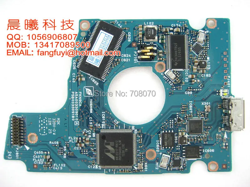

PostPosted: February 8th, 2017, 16:20
Posts: 17325
Assuming this is the USB PCB ...
https://ae01.alicdn.com/kf/HTB11WQkHVXXXXbGXXXXq6xXFXXXX/USB-3-0-HDD-PCB-Logic-Board-for-TOSHIBA-PCB-Board-Number-G003309A.jpg
... then here is a SATA PCB which uses the same MCU (88i9317-RA12):
http://ep.yimg.com/ay/yhst-14437584971410/91405271-7.gif
Just follow the SATA Tx/Rx signal pairs from the MCU to the SATA connector ...
