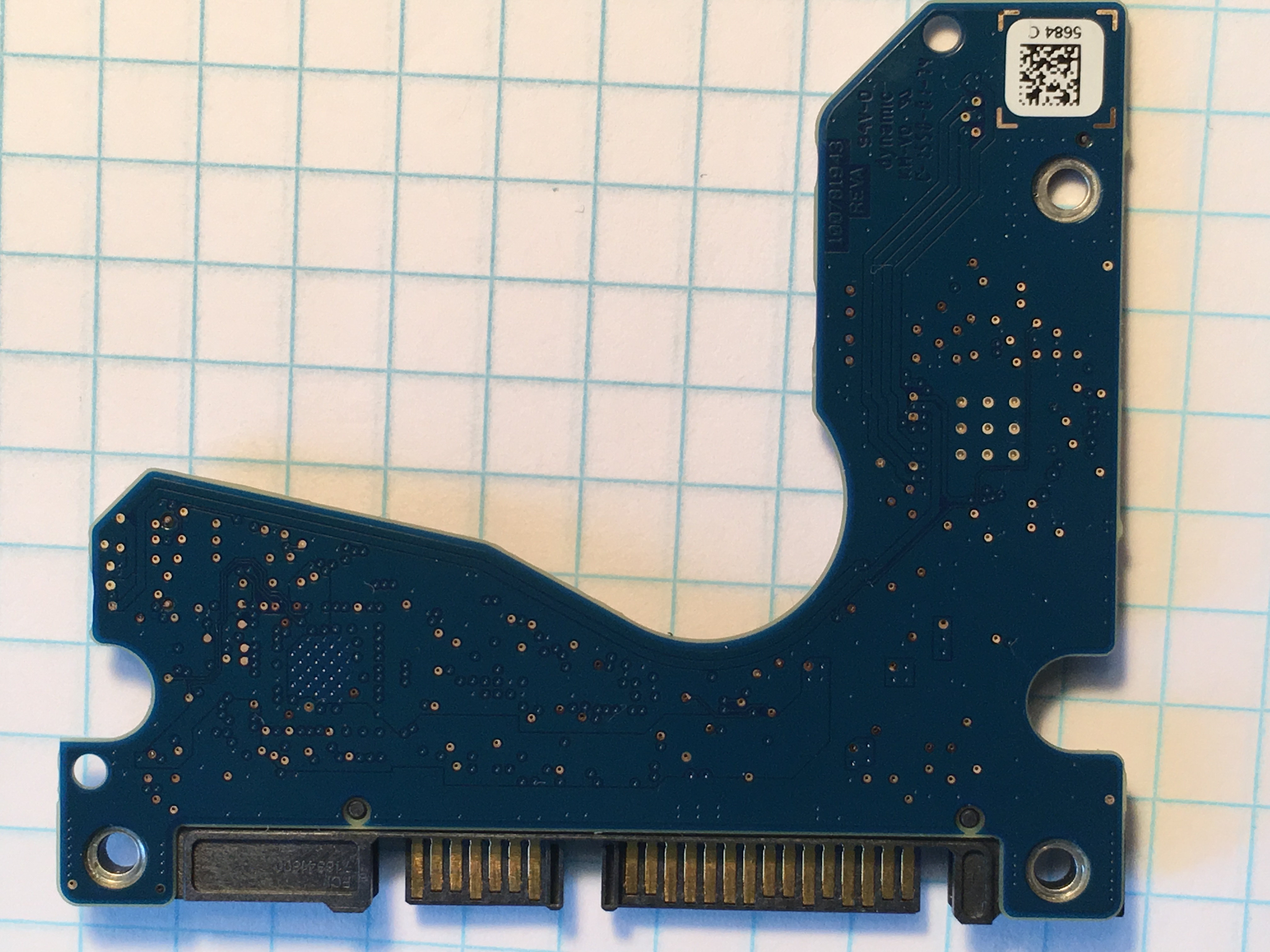

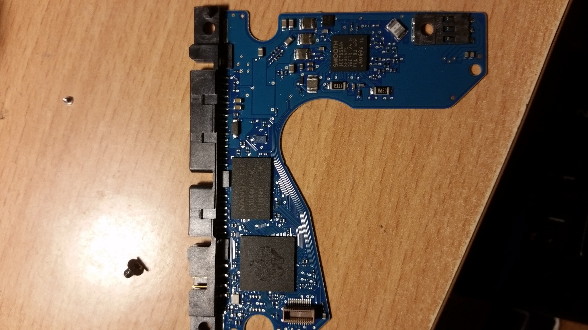

Can anyone be so kind as to tell me which is the firmware chip on this board (ST2000LM007)?

between the TVS diode and the DDR memory chip

This little guy here?

that's the one

It is the ROM chip, I have changed them before... It s not easy!

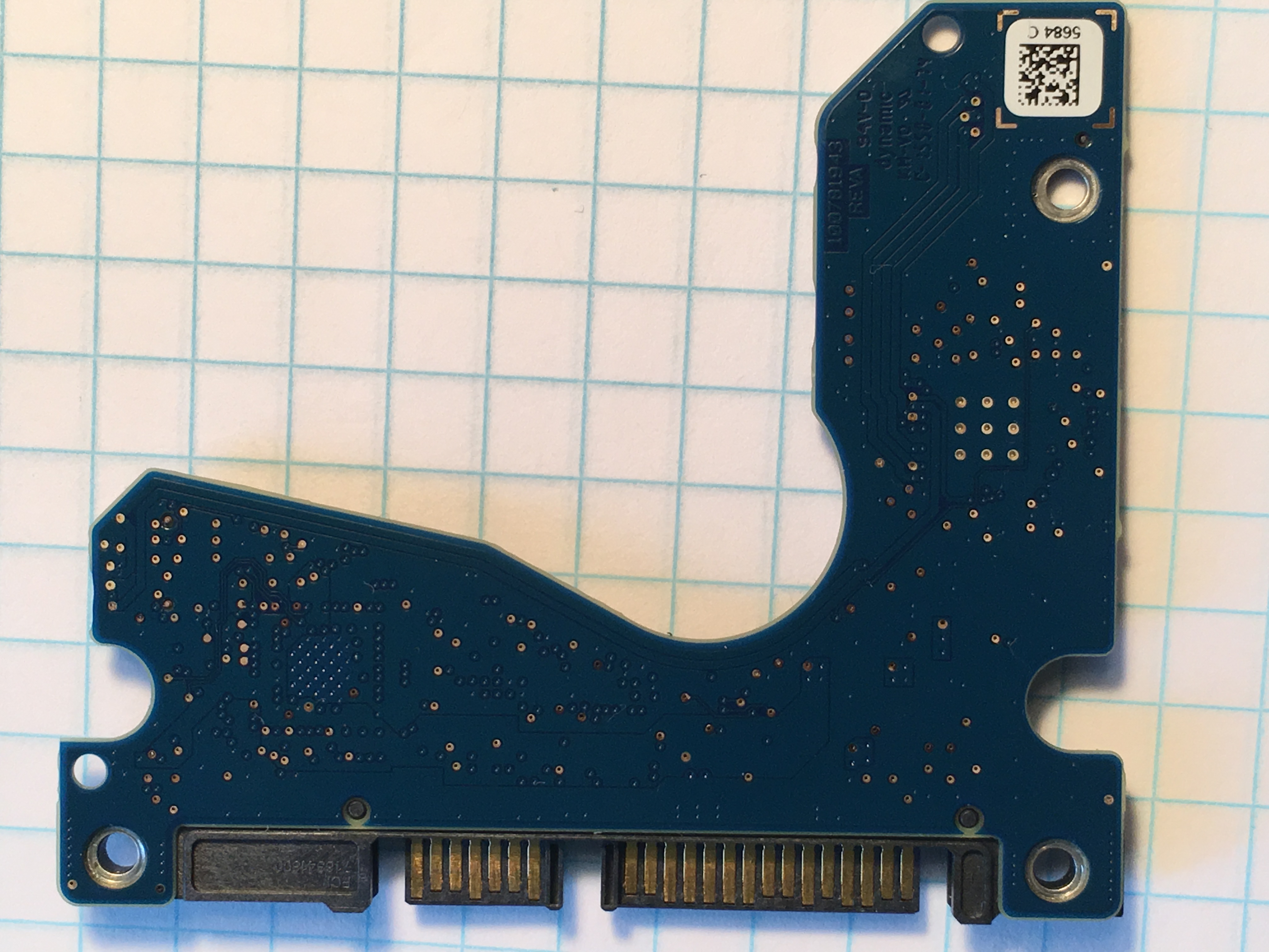

Has anyone succeeded in exchanging this pcb for hdd data recovery? It seems swapping this little crystal ROM isn't enough to unlock the board. Does main controller IC need be swapped as well? Coding in my Rom is 25S81 Thanks.

With the original pcb, the hdd spins but can't be found by computer. After swapping the bios, the hdd even can't spin. It seems there is an bios in main controller too.

That chance is low as I’m a chip designer and know how to handle this. Also the donor board can spin the hard drive with its own ROM but not the ROM from the original board. That make me think the MCU might have a portion of ROM as well. Both need be matched.

I found the Marvell hdd controller becomes very hot in original board. That makes me think the board has a damaged chip although the motor can still spin.

Yes, same board, REV, FW, everything, even ROM footprint.
