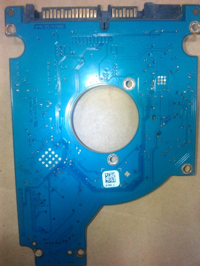

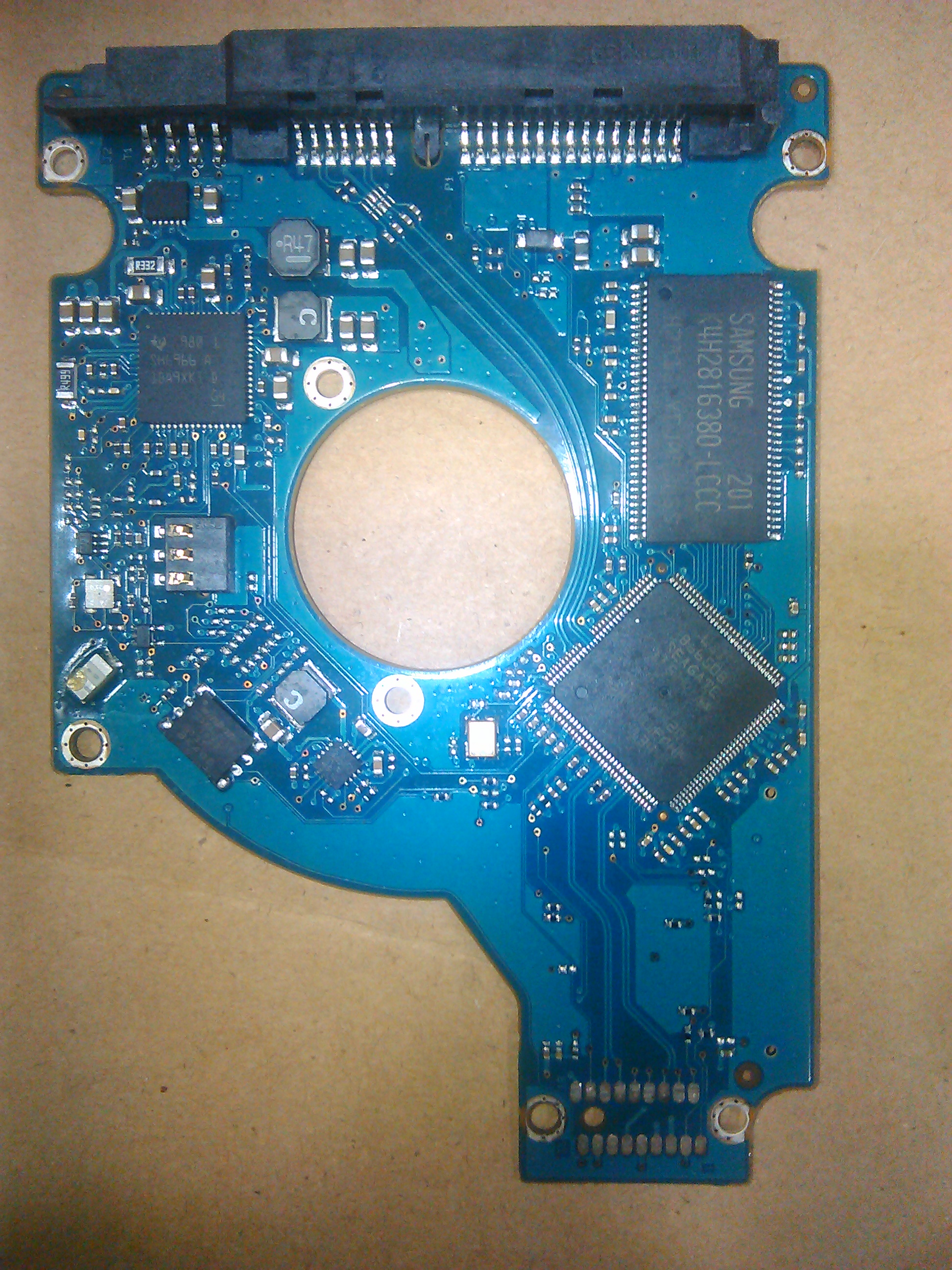

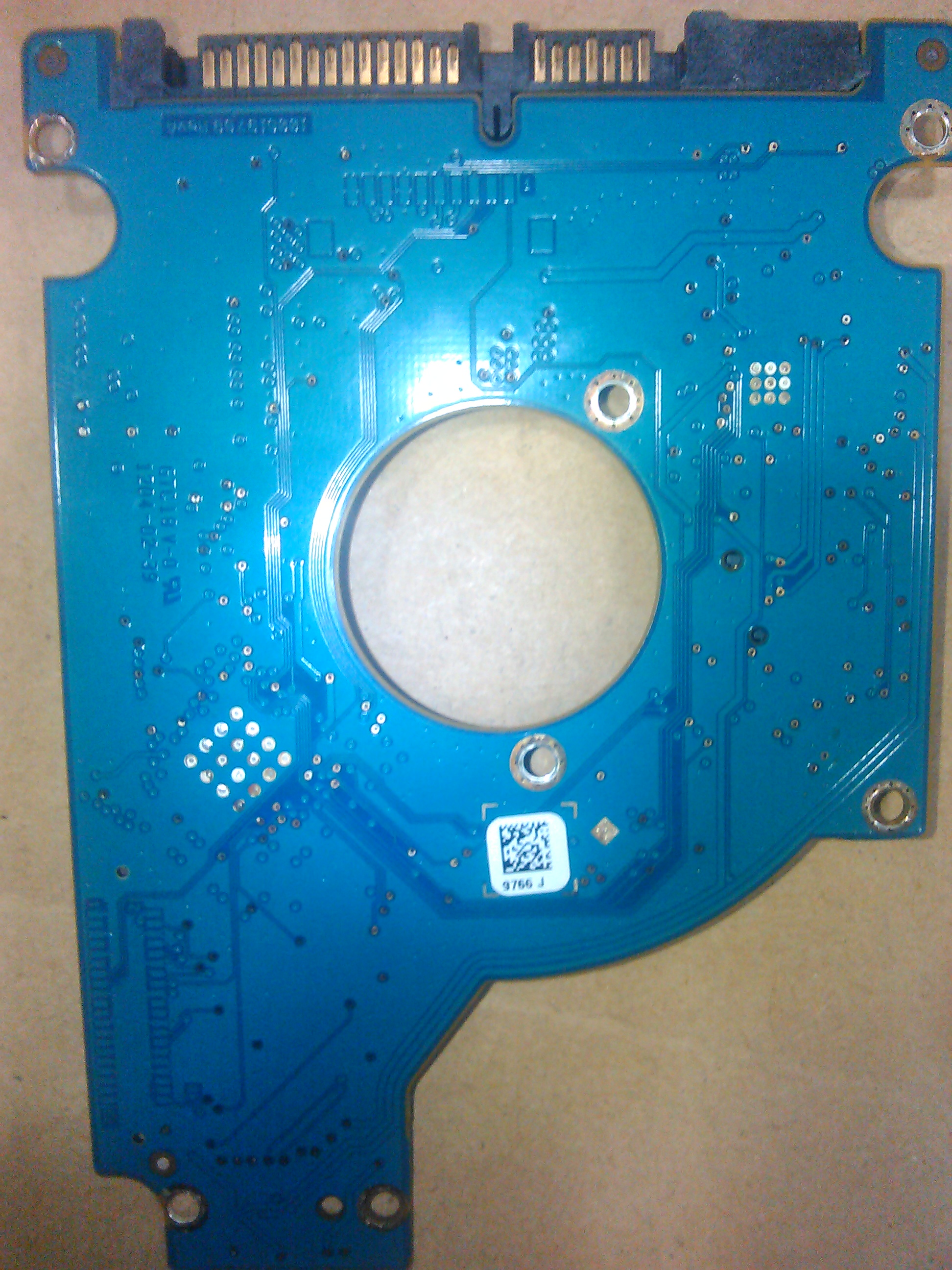

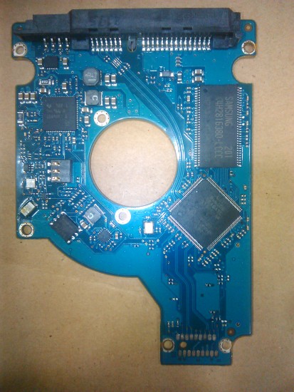

Terminal output:
EarlySpinup Enabled
Rst 0x10M
ExecuteSpinRequest
LED:00000067 FAddr:00380338
I need to know which points for read channel.
Thanks in advance friends.
Attached pictures and ROM :
ROM.rar [434.58 KiB]
Downloaded 423 times

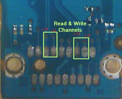

Measure the voltages at the indicated test points.That should help us to differentiate between the read and write channels.

Thank you Mr. Frank :
I have similar case
So, The read channel the two point in the left side or in the right
and can you give me a procedure for how to apply this to get terminal access?
