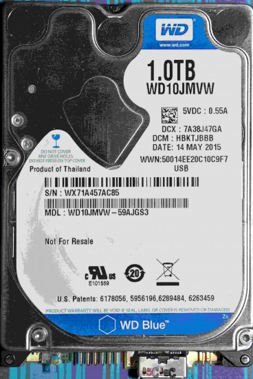

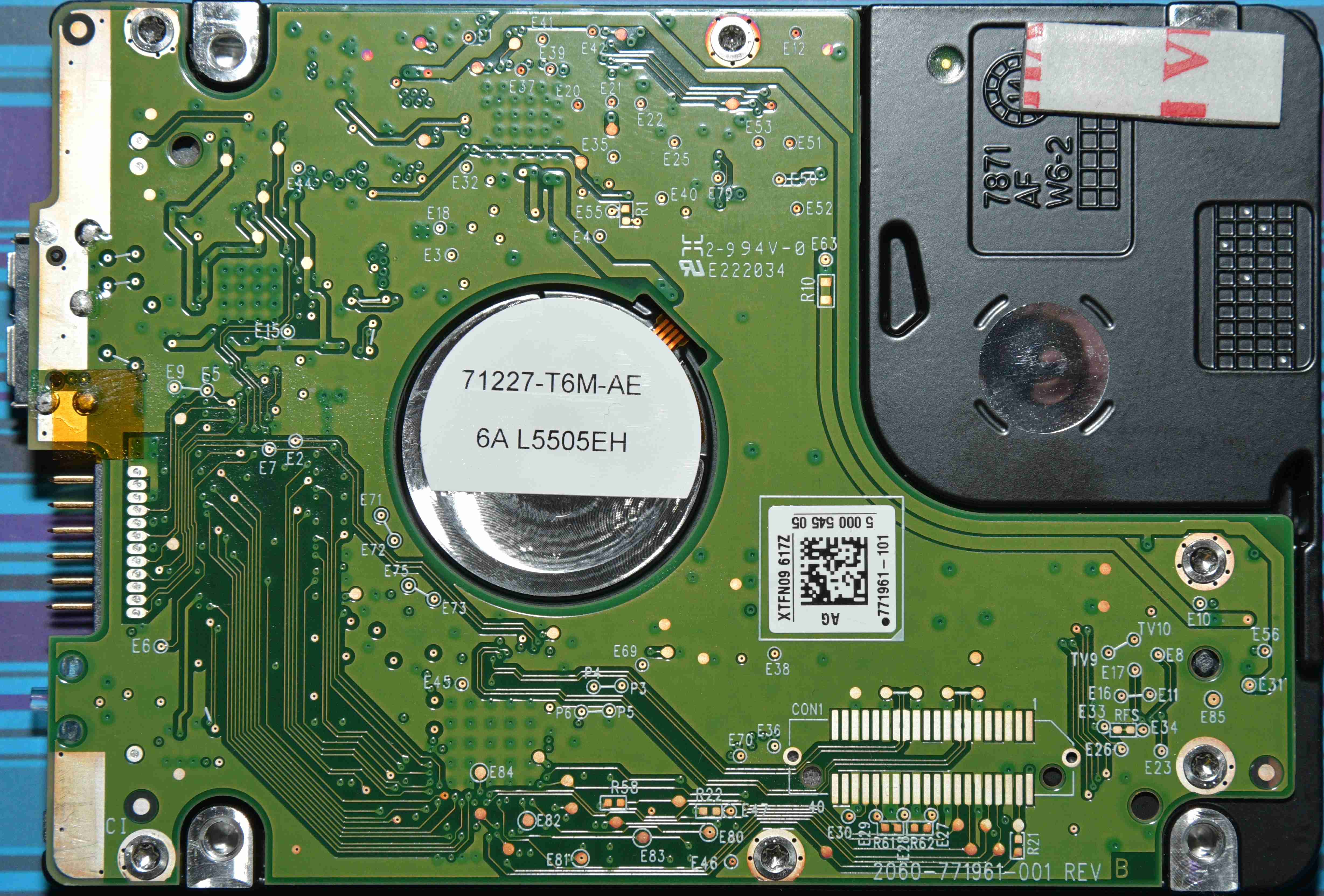

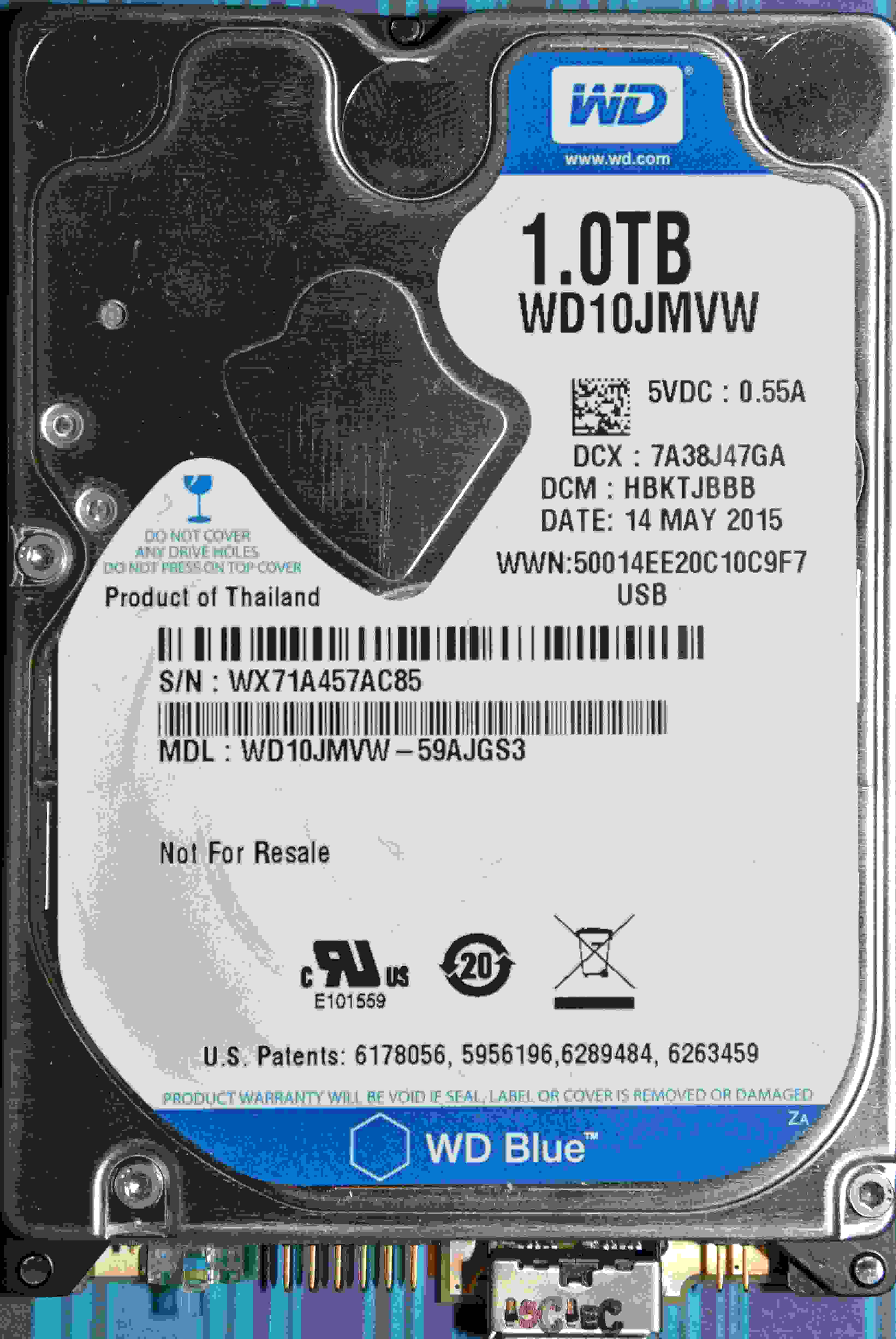

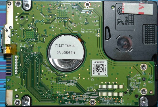

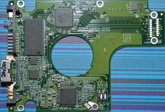

Hi everyone.
I have a problem with a brand new WD My Passport Ultra Metal edition 1TB model WD10JMVW-59AJGS3.
I got it, connected it, copied some data from multiple computers, everything worked perfectly.
Then the next day when I connected it to my PC it's not being detected at all. I tried different PC, different cable, tried under linux, tried dmesg for any connection signs - nothing.
I always do safe remove, never dropped it, it's brand new...
Is there anything I can do before going to data recovery company?
P.S. looking closely at the PCB the L2 element is looking like the centre is melted?

Still interesting for me is the egg-shaped mark on top of L2, L5 and L7 on the PCB.

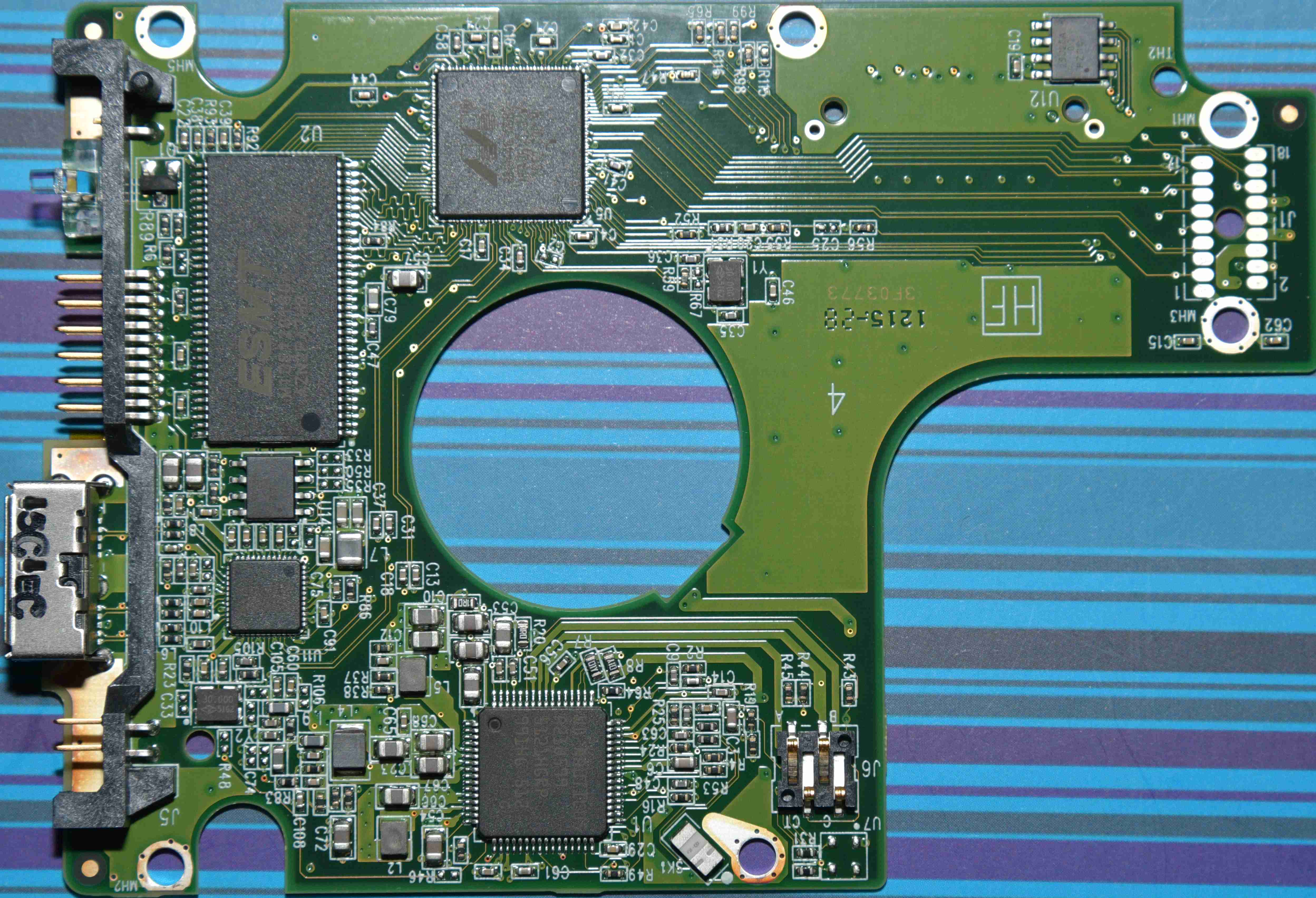

Ok,
I got a replacement PCB, transferred two BIOS chips to proper places checking the orientation.
Now: the HDD is spinning, PC is able to see WD USB HDD (yey!) but it is uninitialized and windows wants to convert it to MBR or GPT (I cancelled)... I can see it in devices manager and in Disk Management it is black space, but correct amount of disk space.
Just to add one detail: when it was working before the issue occurred, I used WD tools to protect it with password.
What can I do now?
 Post subject: Re: WD My Passport Ultra WD10JMVW-59AJGS3 not detected
PostPosted: January 29th, 2017, 5:35
Posts: 3551
huntilus wrote:
Ok,
Why two? U12 is the "ROM" chip you had to transfer. U14 is related to the USB bridge.
PostPosted: January 29th, 2017, 6:31
Joined: January 13th, 2017, 20:25
Posts: 8
Location: Glasgow
Oh, when I got the board from HDDZone there were 2 BIOS labels, so I assumed I have to transfer both.
So I but the original one back and now I can see My Passport being connected (previously it was ATA Bridge), I cannot see the partition in Disk management and WD SmartWare is saying that there is no writeable partition found. The drive is spinning.

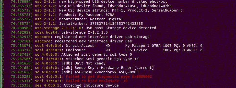

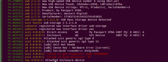

That is what I can see under linux using dmesg
[There should be previous post that is waiting for approval? explaining that I put the original U14 chip back, the drive is being recognised as WD Passport, but the partition is not detected] Drive is spinning

Please note that many of these drives use Western Digital's whole disk encryption. It needs the USB board in order to decrypt. This is probably why you can not see any partitions.
Give Andy at Databusters a call and explain what you have done already. I'm not sure how the software you used works, but if there are any 'undo files' send them to Andy too. There are other copies of these modules in the drive SA but as I mentioned, I don't know how the software works - e.g. if it 'repairs' both copies.
They look like normal mould marks. Nothing to worry about.

Here is a list of WD VIDs and PIDs:
http://www.hddoracle.com/viewtopic.php? ... 404&p=9069
The Linux/dmesg screenshot is reporting a My Passport 07BA device, VID/PID = 1058/07BA. According to the data at the abovementioned URL, this corresponds to a My Passport Essential which uses a JMicron JMS569 bridge IC. AIUI, this information would be stored in U14.
The reported serial number is "575837314134353741433835" which decodes to WX71A457AC85. This matches the number on the label, so it would appear that the PCB is accessing the System Area (SA) on the platters (or the ROM, U12?).
What are the markings on the bridge IC (U11)?
The JMS569 IC does not handle encryption, so this would suggest that the drive is a SED. That is, encryption would be handled in the drive's firmware rather than by the bridge.

huntilus wrote:
I could see the drive when I swapped both chips, but when I tried testdisk or hddsupertool it was reporting that it couldn't read the drive.
The drive is a SED, so hddsupertool will not be able to access the firmware.
Testdisk will not see your data since the drive is password protected.
