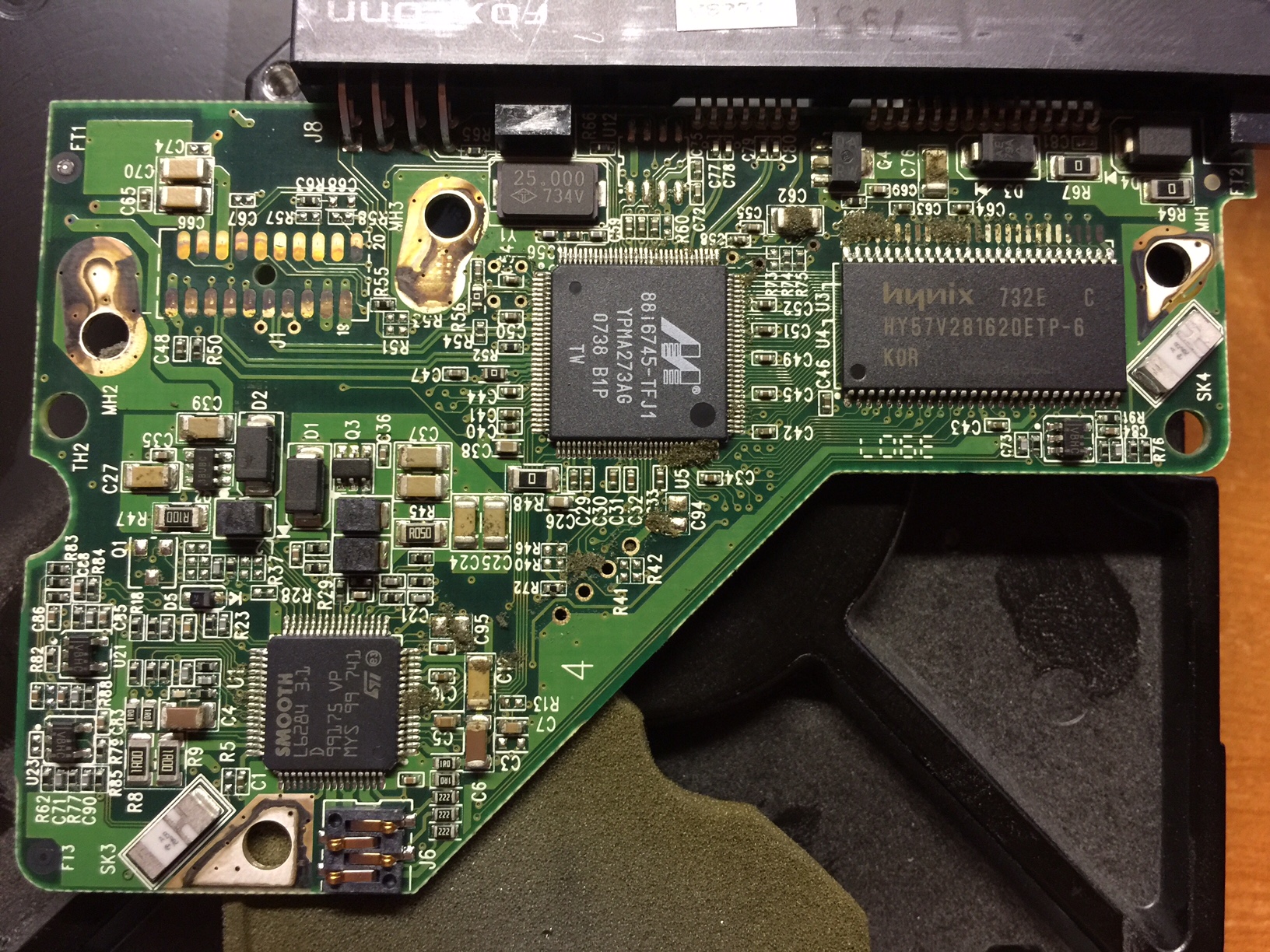

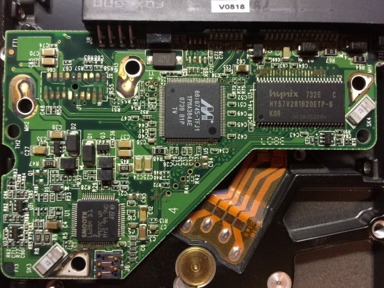

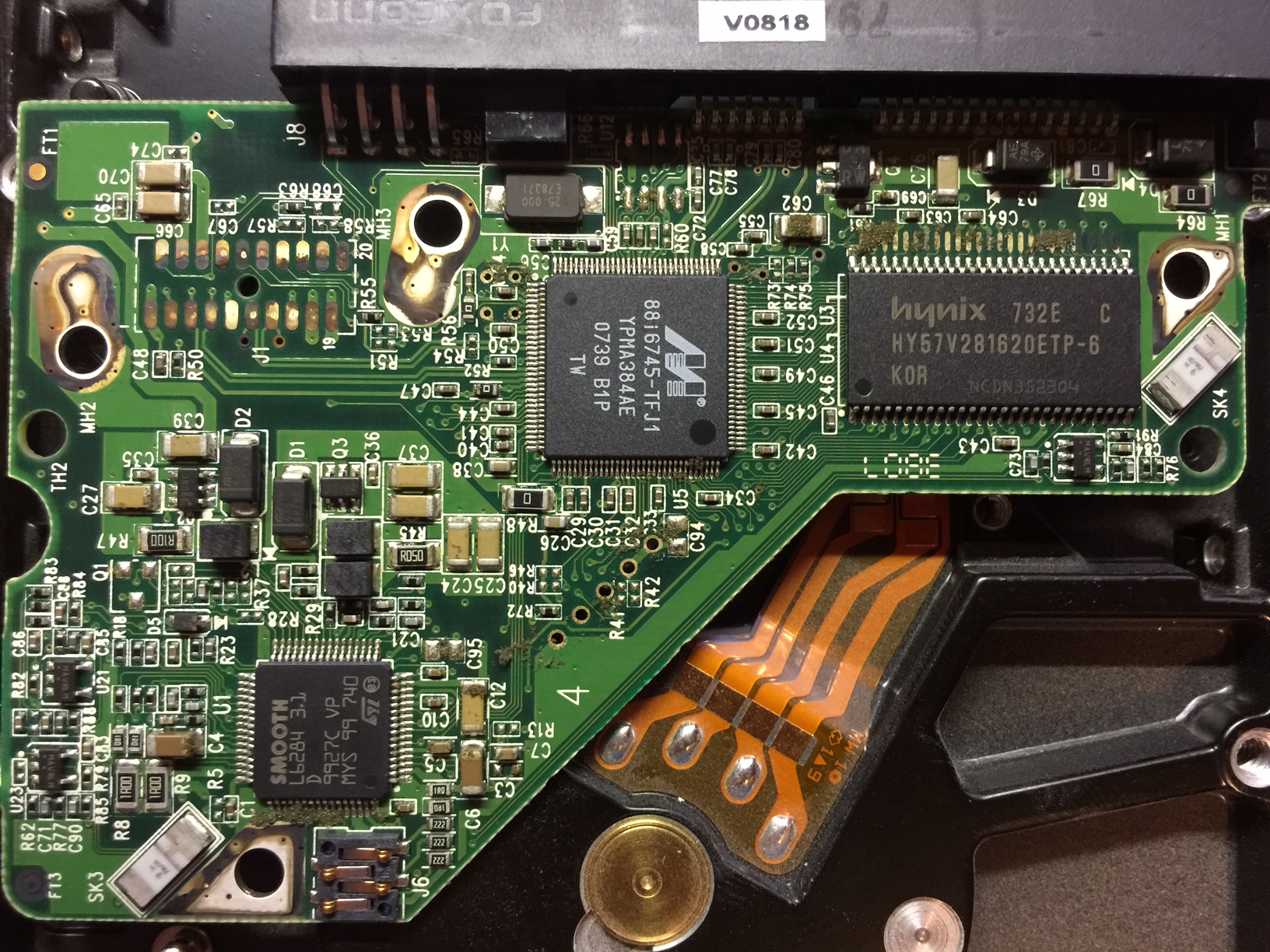

Here is a picture of each board. Both boards seem to have discoloration in the upper left corner on the contacts.

Gently clean the contacts with a soft pencil eraser.
Oxidisation on Western Digital PCBs:
http://www.hddoracle.com/viewtopic.php? ... 649&p=1789
Contacts fairly shiny now but no luck accessing either drive.
Spins up, initial engagement, can hear driving searching but no loud or unusual clicks/scrapes, slows momentarily and process repeats over and over again.
Both will eventually show up in Mac Disk Utility as Ext Hard Disk Media (connected via USB dock). It shows the correct capacity. It shows an unmounted volume labeled Untitled with the correct capacity but with zero KB available.

The 88i6745-TFJ1 MCU is known to develop "head mimic" faults. You could try a PCB swap, but you will need to transfer the patient's embedded ROM code to your donor PCB.
See viewtopic.php?f=1&t=34432&start=20
I would first try to read the drive's ROM and SA modules using HDDSuperTool.
