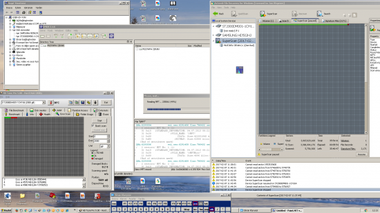

 Post subject: st2000dm001 read and sim error 1009
PostPosted: February 7th, 2017, 6:34
Posts: 210
Location: istanbul
st2000dm001 was not visible device manager.
hdd came with
Boot 0x40M
Spin Up
Trans.
Spin Up
SpinOK
(P) SATA Reset
SIM Error 1009 LBA 0000000000097E38 FD FCFFF3FF
RW Error 00000080
Drive AMPS Configuration has been modified from compiled defaults.
Drive must be re-initialized to controller firmware defaults by re-downloading c
ontroller firmware
DO NOT SHIP WITHOUT FIRST RE-DOWNLOADING CONTROLLER FIRMWARE OR RESETTING TO DEF
AULTS!
RW Error 00000080
MCMainPOR: Start:
User Data Base 00440628
Check MCMT Version: Current
MC026: Reconstruction: MCMT Reconstruction Start
[RSRS] 09CD
LED:000000EE FAddr:0027C988
Rst 0x40M[
m0,6,3,,,,,22 updates hpa.
visible yet but it is too late..after 7 minutes when i plug..
first some sector good. but the others can"t read.
dmde stucks at %49. after that it"s very slow. when i abort that point files visible now. but recovering stucks this time . hdd unvisible at device manager
hddsuperclone clones stops at % 4 and it gives exit code:68 after that it"s unvisible again. i think that heads tired. must do same command m0,6,3,,,,,22
have i any chance to read all other sectors?

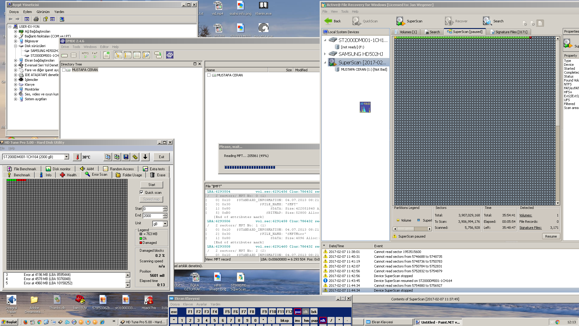

 Post subject: Re: st2000dm001 read and sim error 1009
PostPosted: February 7th, 2017, 11:16
Posts: 210
Location: istanbul
jermy wrote:
I really don't understand
For SIM error 1009 you issued m command ?
i don't understand too.
first time i rewrite sys17a and 133 with success. drive cames.
drive stucks at beginning of cloning. sim error 1009 appears again.
m0 or waiting solves this issue. i dont really know. but error disappear now.
i send recovery flag commands. drive is copying one picture in 5 hours.
no more stuck yet.but it is very slow.
is there any difference at speed dmde or hddsuperclone.. :roll: :?:
