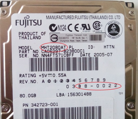

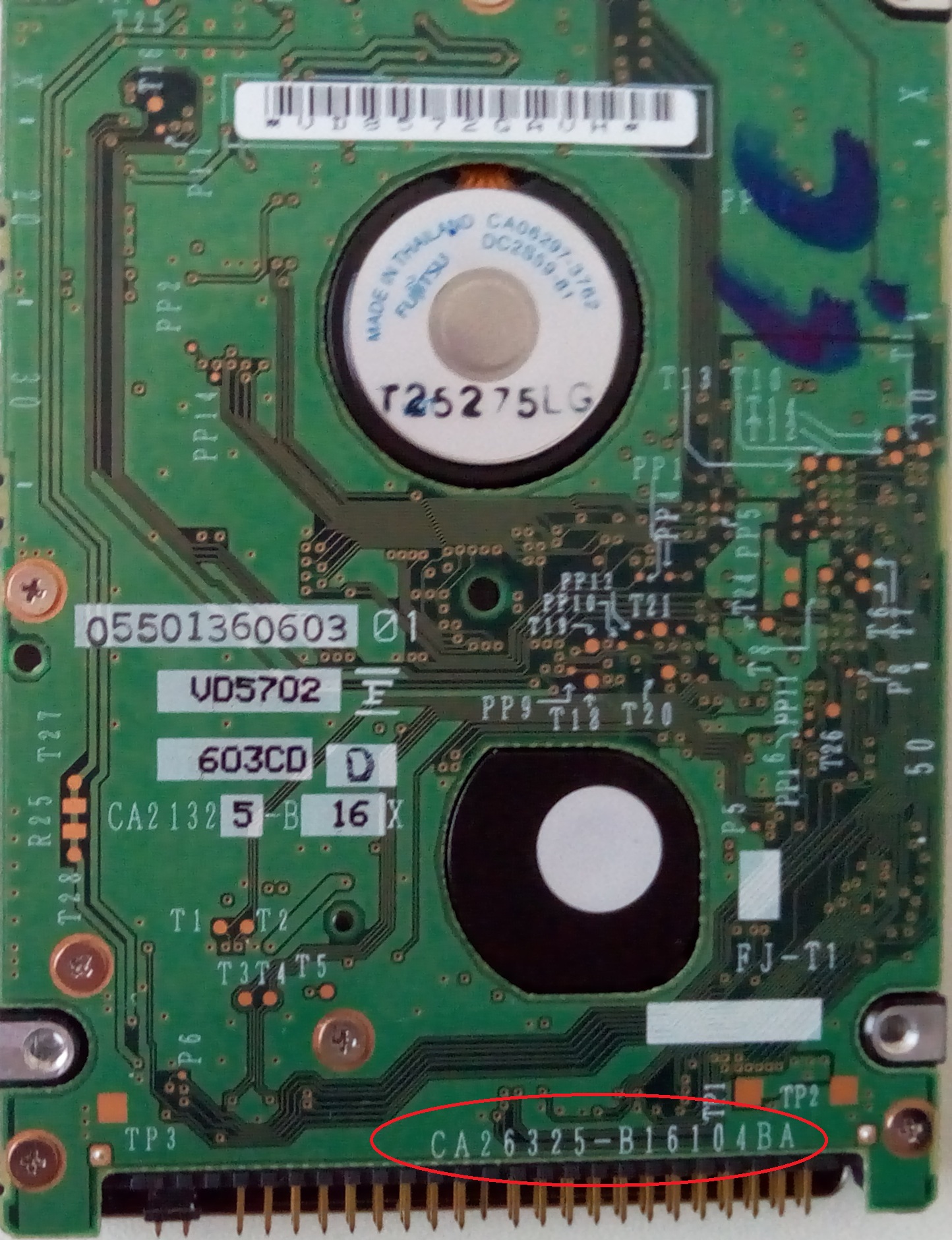

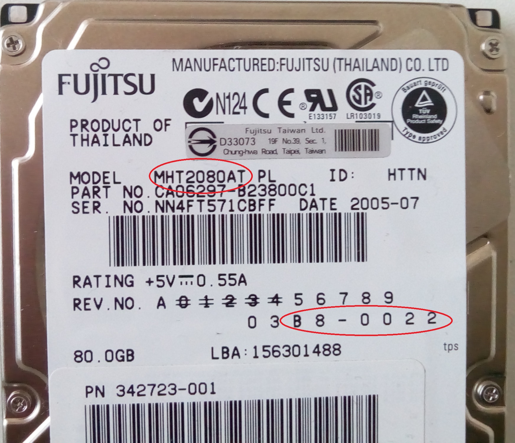

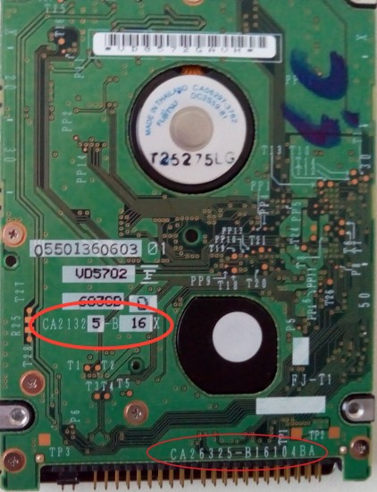

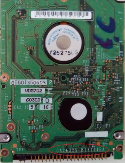

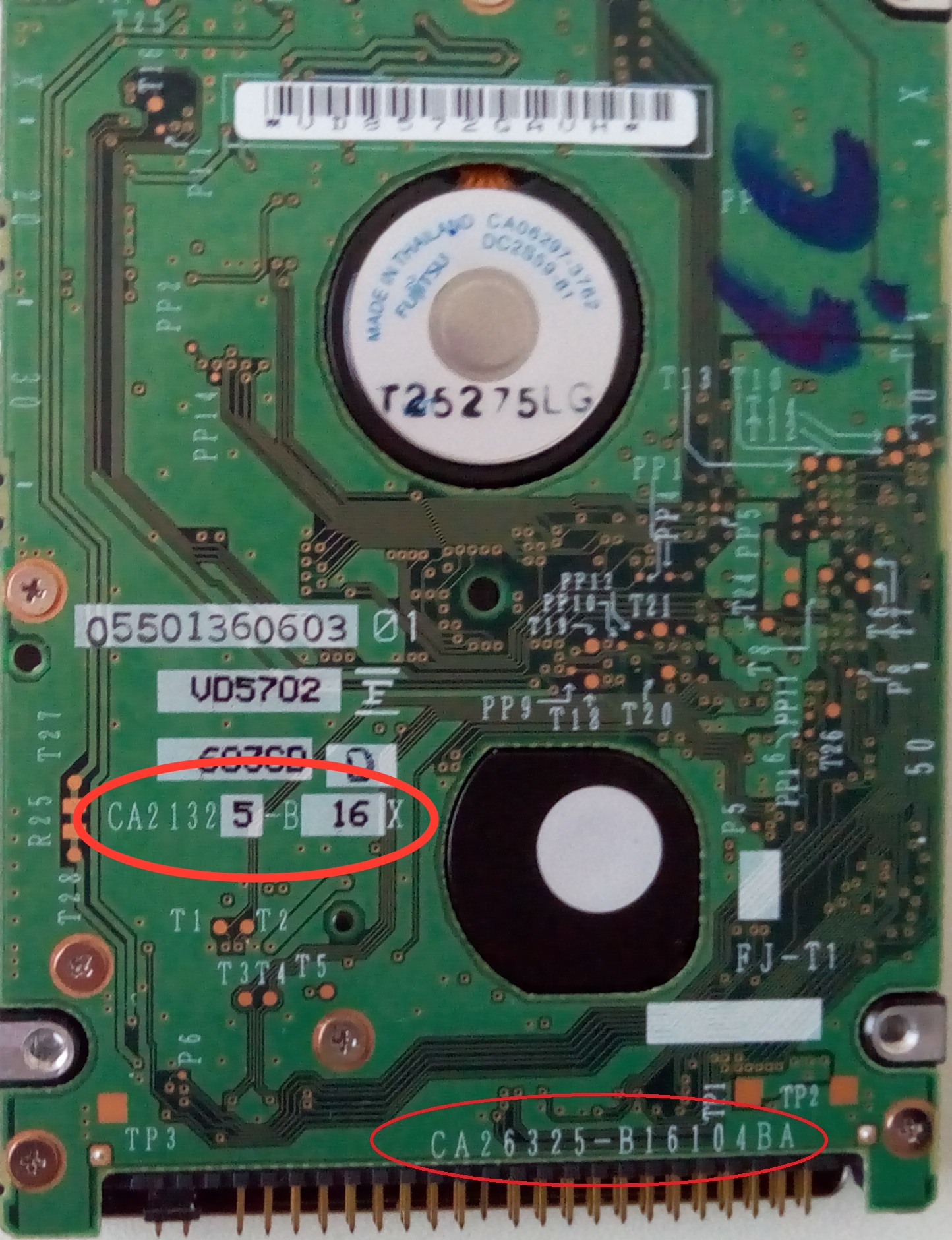

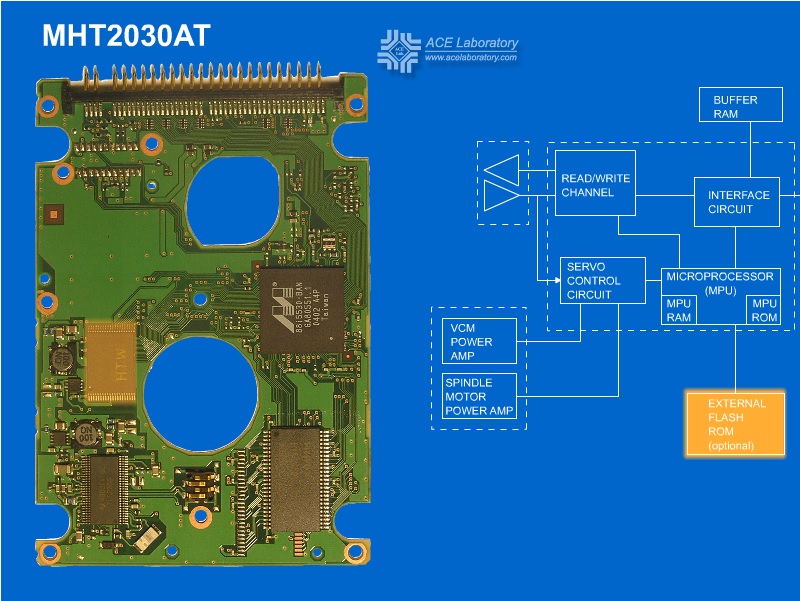

I have an Fujitsu IDE drive MHT2080AT that need to replace a PCB.
Can anyone tell me what should to match between the Patient and Donor PCB in order for the replacement to WORK.
PC3000 support says that the HDD Model and Firmware have to match but not PCB Reference and you need to transfer ROM
Donordrives says that this PCB doesn't contain ROM and you have to match PCB reference and Parnt number but not HDD Model
Kind regards,

CA2132....And modell if I'm not wrong.
