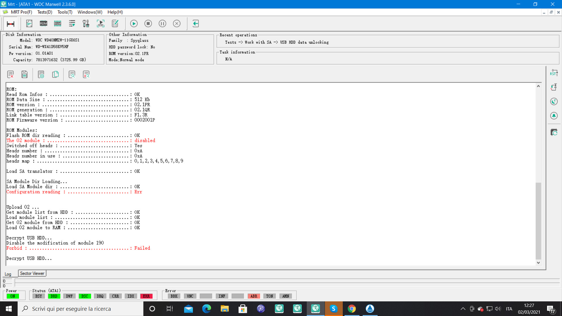

hi friends, I'm struggling with a spyglass, I converted the device to sata and deactivated module 02 after making a short circuit on the points to be able to do it. I need to disable SED but I can't load after module 02 from disk but when I try to disable encryption the result doesn't appear and the disk doesn't change anything. I am attaching photos. Advice?

Hi, any news from your case? were you able to access user data?

Convert Original PCB to Sata and read decrypted data.
