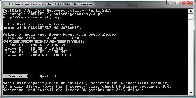

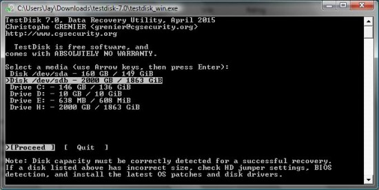

- After a bit of a break and a reboot, I went back to TestDisk and there were more drives detected including 2 entries that match the size for the H drive (Screenshot 1).
File comment: screenshot 1

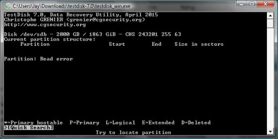

- Tried the top drive first (DISK /dev/sdb) and the analyze command gave a partition read error. Screenshot 2
File comment: Screenshot 2
The quick scan showed read errors and I did not let it finish.

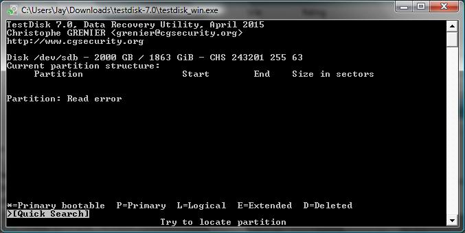

- Then I tried the second option (Drive H:), at the partition table type, Testdisk defaulted the file type to none. I choose intel instead, heeding the bottom prompt in testdisk stating that rarely is the partition type none. Analyzing this instance of the drive also gave a partition read error (same as above).

Acaelus wrote:
To be continued...
No need
In short, if the data on it is valuable to you, then send it to a Data Recovery pro (not a computer repair shop/tech)
 Post subject: Re: HD magically switched to RAW file system
PostPosted: February 20th, 2017, 11:07
It is likely a bigger issue than just a partition problem.
https://www.recoveryforce.com/inaccessi ... ng-as-raw/
