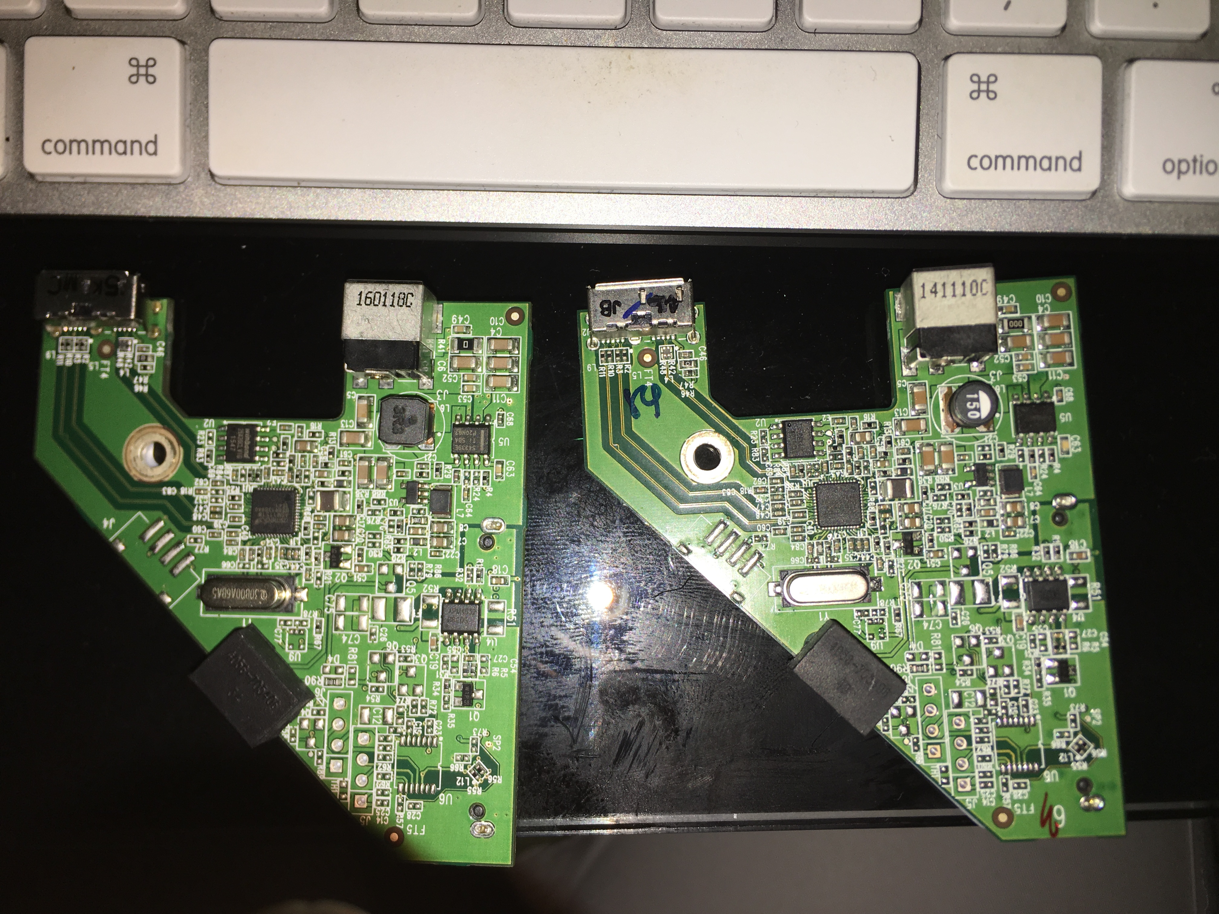

From what I've been able to do on my own, the drive itself is fine and it's probably encryption on the SATA to USB bridge that I need to get past. I haven't been able to find any 4061-705149-a00 rev ab boards online and the only one on eBay is listed at $500. I just don't have that kind of cash.
I did manage to get a 4061-705210-a00 rev ab donor board and when I use that I get the "Initialize" prompt, so some progress there.
The original pcb looks like it has a power issue. Nothing happens when I plug in the power supply, but I've been over the board but I can't find any obvious shorts or over current.

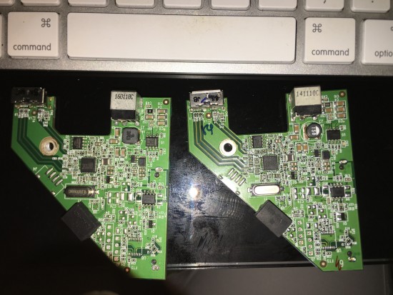

Here's a picture of the boards. I'm willing to test pins or traces on them, but I don't know the layout.
File comment: 4061-705210-a00 rev AB on the left and 4061-705149-a00 rev AB on the right.

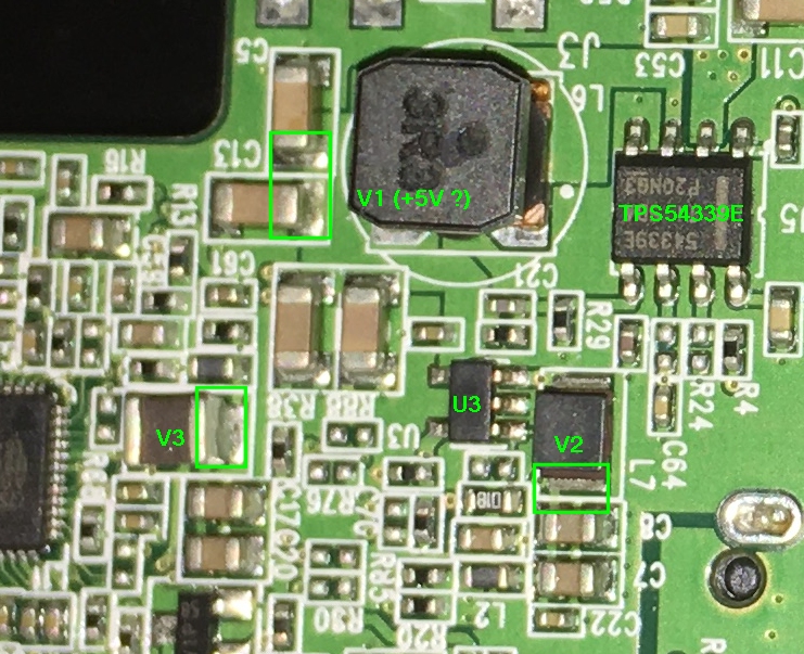

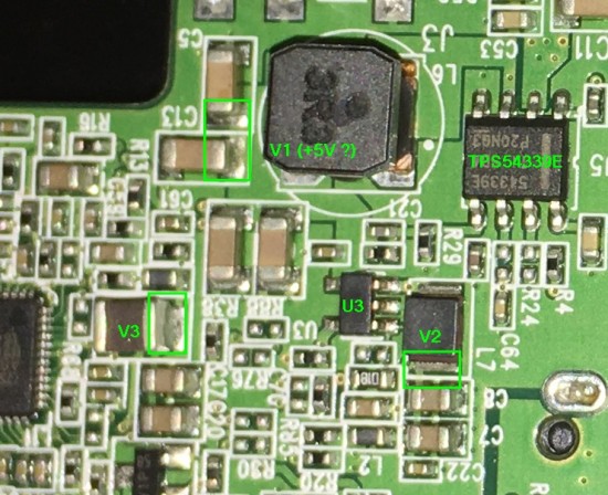

@sailense, can you measure the voltages at V1, V2, and V3?
Also, can you identify the markings on U1, U2, and U3?
APM4532, Anpec, Dual Enhancement Mode MOSFET (N-and P-Channel), 30V/5A, -30V/-3.5A:
http://www.anpec.com.tw/ashx_prod_file.ashx?prod_id=242&file_path=20081002153109520.pdf&original_name=APM4532K.pdf
http://www.audiolabga.com/pdf/APM4532K.pdf
TPS54339EDDA, Texas Instruments, marking 54339E, 4.5V - 23V Input, 3A, Synchronous Step-Down Converter:
http://www.kynix.com/uploadfiles/pdf659 ... 39DDAR.pdf

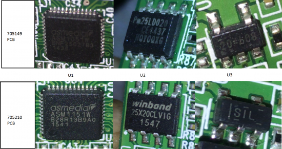

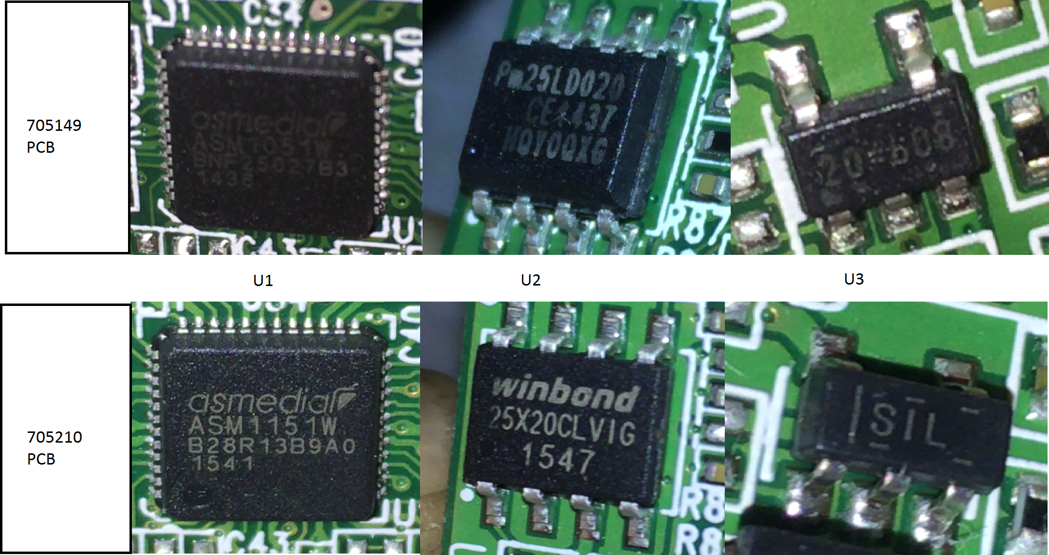

I've included an image with the best pictures I could get for the markings on U1, U2, and U3.
I also did the following voltage measurements:
705149
Direct from Power Supply: 12.5V
From power supply port on PCB: 12.5V
V1
    C5: 5V
    C13: 5V
V2
    L7: 0.10V
    C7: 2.5V
    C8: 2.5V
V3: 0.05V
705210
V1
    C5: 5V
    C13: 5V
V2
    L7: 0V
    C7: 0V
    C8: 0V
V3: 0V
Let me know if there's anything else I need to do.
File comment: PCB Identification
 Post subject: Re: WD My Book PCB for 4061-705149-a00 rev ab Help
PostPosted: February 1st, 2017, 2:13
Posts: 17100
The voltage at L7 for the 705149 board should be the same as at C7/C8, namely +2.5V. Perhaps your probe isn't making contact through the lacquer?
Try measuring C17 and C20. It could be that your V3 measurements are also being affected by lacquer.
The results for 705210 are unexpected. This was supposed to be your working PCB, yet V2 and V3 are missing???
If you connect your USB-SATA bridge PCB on its own, can you see it with UVCView or USBDeview?
http://www.nirsoft.net/utils/usb_devices_view.html
http://download.microsoft.com/download/ ... ew.x64.exe
http://www.users.on.net/~fzabkar/USB_ID ... ew.x86.exe
W25X20CLVIG, Winbond, 2Mbit, 2.3V - 3.6V, SPI flash memory:
https://www.winbond.com/resource-files/w25x20cl_a02.pdf
Pm25LD020, Programmable Microelectronics Corp, SPI (dual output), 2.3V - 3.6V, 2Mbit, Serial Flash Memory:
http://www.chingistek.com/img/Product_F ... %20v04.pdf
TLV62566, Texas Instruments, 1.5A Buck Converter with Power Good, SOT23, marking SIL:
http://www.tij.co.jp/jp/lit/gpn/TLV62565
http://www.farnell.com/datasheets/1950597.pdf
RT8060A, Richtek, 1.5MHz, 1A High Efficiency Step-Down Converter, 2.7V - 5.5V in, SOT-23-5, marking 20=:
http://www.richtek.com/assets/product_f ... 60A-00.pdf
PostPosted: February 1st, 2017, 16:21
Joined: January 27th, 2017, 10:52
Posts: 6
Location: Samoa
Sorry, that was my mistake. The measurements are swapped. The working 210 PCB is the one that shows voltages for V2 and V3. You're probably right about the lacquer. I had to apply a bit of pressure to get the millivolt readings. I'll see if I can get a proper reading.
I'll also get the software and see what it reports as well. I've noted that the power light flashes on the working PCB when I plug in the power supply.
PostPosted: February 1st, 2017, 16:45
Posts: 17100
I expect that V3 should be ~1V. I'm not certain, but it could be that the bridge IC derives V3 from V2 via an internal switchmode regulator. If so, then repairing V2 might be enough to recover V3.
PostPosted: February 1st, 2017, 17:37
Posts: 17100
You might like to measure the resistance between ground and each of V2 and V3. This will tell us if any of the ICs could be damaged/shorted.

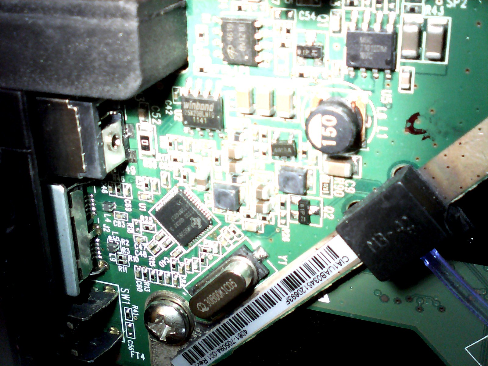

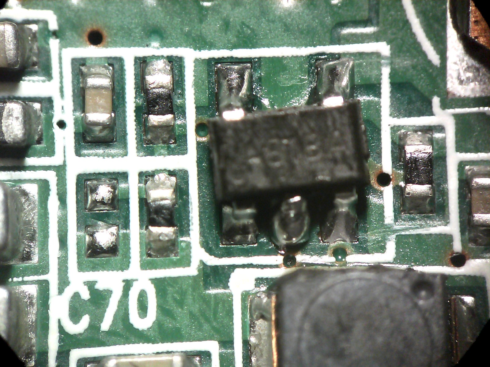

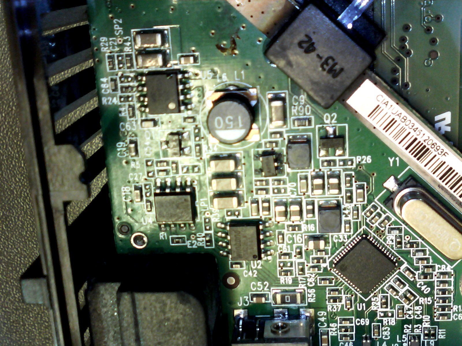

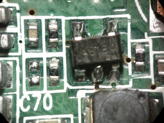

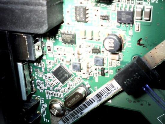

Finding this post saves me some time in repair my WD 2TB Mybook. From what I have measured on my pcb equivalents to your pcb : U3 (either RT8060(smd marking code 3R=xx)/RT8060A(smd marking code 20=xx) or TLV62566(smd marking code .|SIL aka SIL) should have on pin1(power good signal) logical 1, and 2.5v output on L7. Only when both are true, HDD is attached to pcb and usb is connected V3 will be generated with value of 1v. In my case equivalent to yours U3 was dead. With help from (http://monitor.espec.ws/section27/topic200427.html), some measurement on pin1 and resistor divider on pin5 i choose to replace dead IC with SY8008B (smd marking code ABxxx). Please note that on my pcb pin1 is externally pulled up to +5v with resistor 4.7k (which guarantee logical 1 when RT8060 is used - see datasheet), and like this i have external EN signal for SY8008B. Also please note that this replace is only for data recovery and is not intended as full pcb repair.
File comment: pcb U1=JMS538S U2=25X20B U4=AP4619 U5=NX7101IDT
File comment: pcb
File comment: 2.5v dc/dc
PostPosted: February 21st, 2017, 14:57
Posts: 17100
Thanks for the feedback.
BTW, I believe that U4 and U5 should be AO4619 and NX7101IDM, respectively.
PostPosted: February 22nd, 2017, 2:56
Joined: November 10th, 2009, 6:01
Location: Bulgaria
I noticed my mistake, but there is no edit button. Thanks for correction. To be read on first picture: U4=AO4619 and U5=NX7101IDM.
