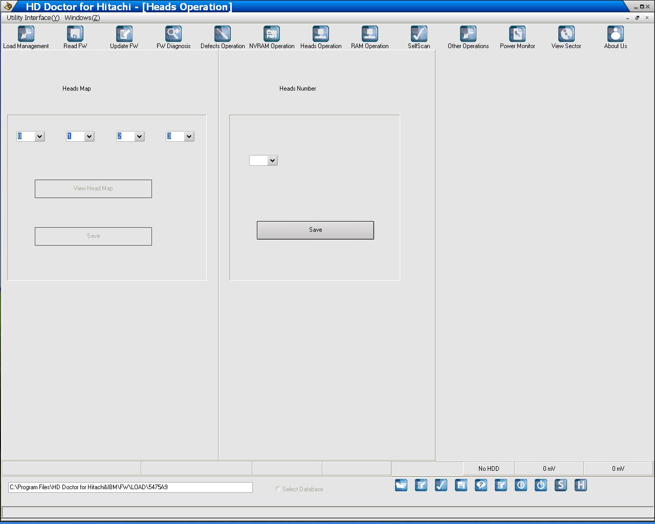

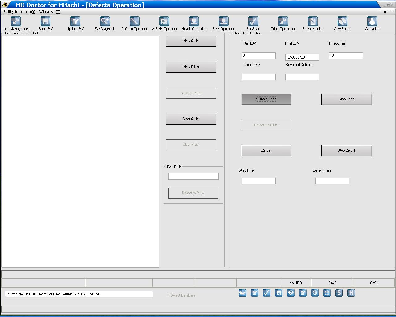

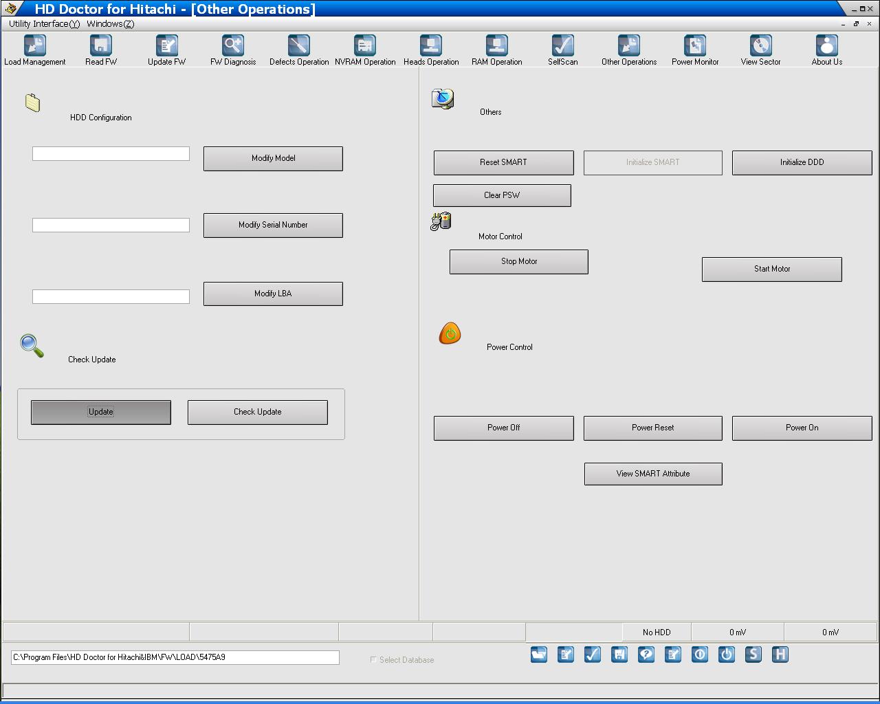

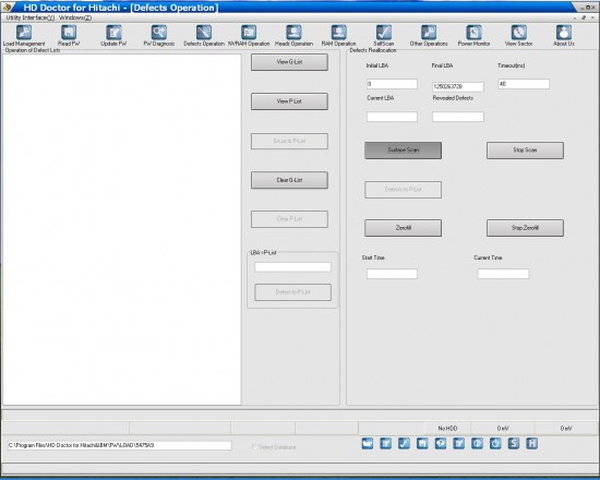

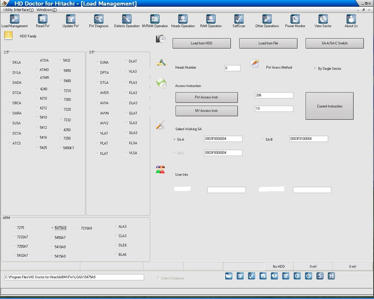

 Post subject: Re: Hitachi arm HTS547550A9E384 4 heads donor to patient 3 h
PostPosted: February 21st, 2017, 16:58
Joined: February 1st, 2016, 19:51
Posts: 147
Location: Cyprus

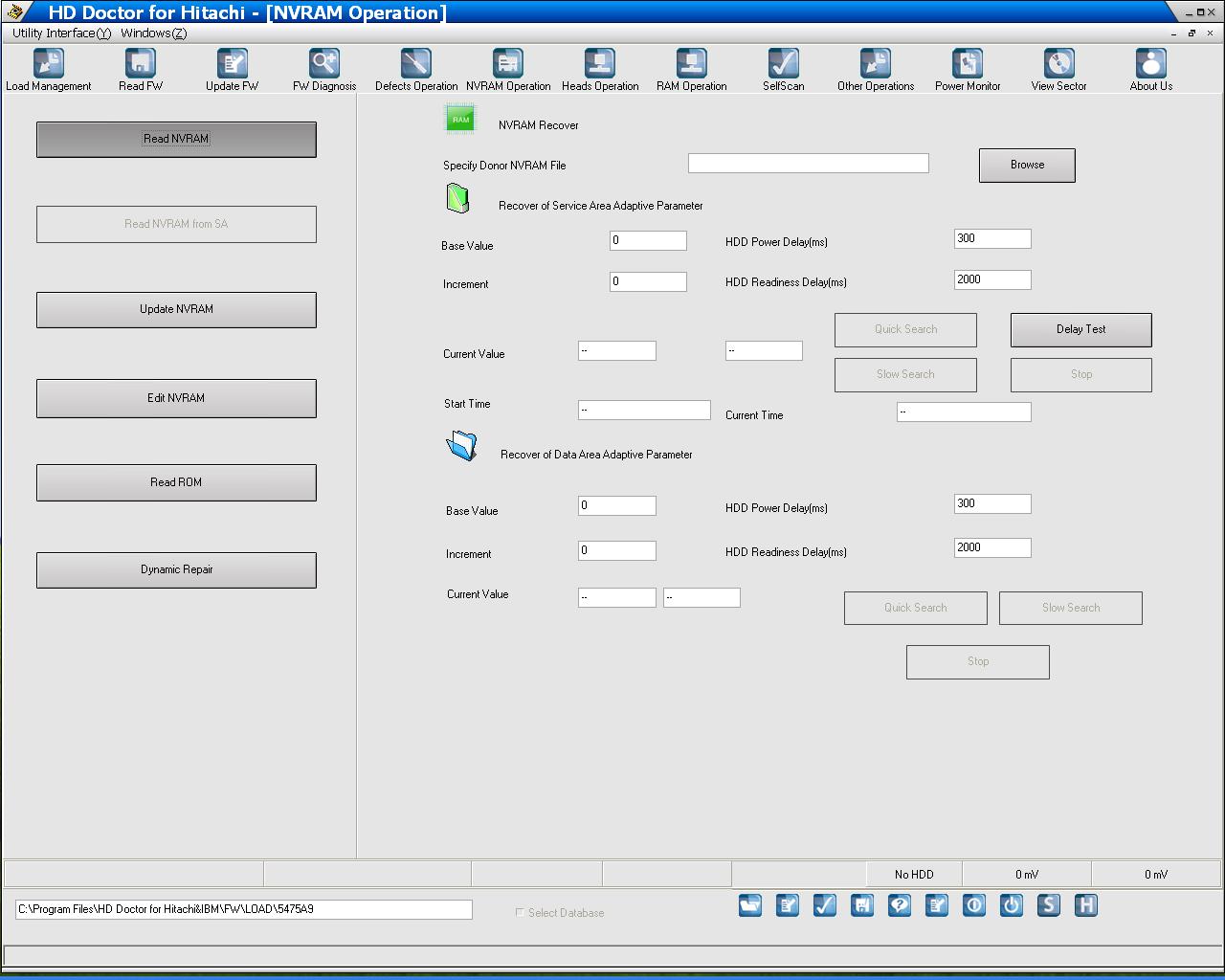

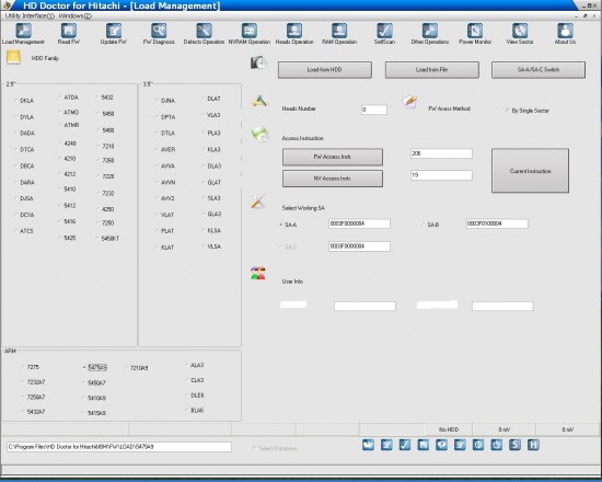

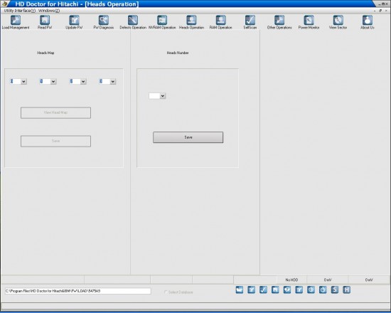

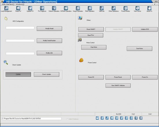

Unfortunately I have salvationdata tools DC and HDD (yes,there is still something like this today) therefore I don't have support at all.
I upload pictures with some options I have, can you please explain with full description(otherwise I will not understand) if I can do it with HD doctor and how ?
PostPosted: February 21st, 2017, 19:37
Posts: 1388
Location: isreal
I only used it once (as a matter of fact I "TRIED" to use it) (TV for someone) and if I remember correctly, the option mentioned above (uploading into RAM) doesn't exist
Again I'm not sure and I don't have it either(gladly), to check it out
Edit: just saw the screenshots you have uploaded
Can you upload a screenshot of RAM operations ?

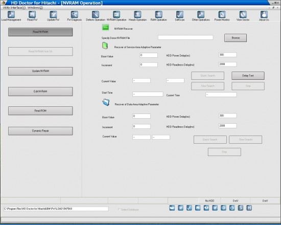

PostPosted: February 22nd, 2017, 7:35
Posts: 147
Location: Cyprus
In RAM operations there is only one option "read ram" .
Can someone explain in general on this procedure,in what cases it should be applied ? is't just for the arm series ? is't because different MLC and P/N ?
