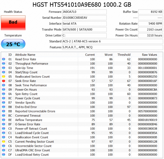

I actually just did a SMART scan and got this result. The Seek Error Rate (57) is the most striking issue but does this indicate a mechanical malfunction or otherwise?

The Reallocated Sectors Count and Current Pending Sectors Count are indicating that the drive has serious problems. Try cloning your drive with ddrescue or HDDSuperClone.
