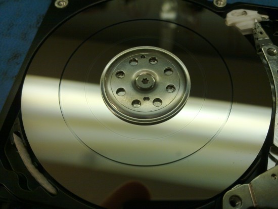

PostPosted: August 1st, 2016, 18:43
Posts: 488
Location: US
Half of year I am coping data from this hdd. It was in Ontrack before and they told it's unrecoverable. I don't think they can't - they just don't want to (same as seagate in similar cases). They can't spend half of year and more for a case (if price for recovery not tens of thousand dollars).

 Post subject: Re: Seagate Barracuda ST2000DM001 1CH164-510 fw cc27 problem
PostPosted: August 1st, 2016, 20:43
Posts: 1388
Location: isreal
How much do you charge for a half a year of work (and counting ?! )
PostPosted: August 2nd, 2016, 11:18
Posts: 488
Location: US
Price for this case is $2000.
