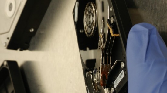

I'm looking for a head unstick tools for a Seagate Momentus ST2000LM003. It is a 2.5" with 4 heads and 3 platters, and I couldn't find anything from ER tools or from HDD surgery. Would the ER tools Freeplay one work on this drive?

I would like a picture of the 4 head, 3 platter drive. That's quite rare...

See attached.

This drive it is Samsung HN-M201RAD (M9 family)
It is 6 heads drive !!!
The only tools available for this drive I've seen it is:

Spildit wrote:
Do you *really* need a tool to get those heads unstuck ?
Most likely you could had unstuck those heads without even opening the lid of the drive .... Works well on Samsung ....
Maybe without tools, but definitely need to open the lid.
"Percussive maintenance" very risky on this model.
Need to examine the unstuck heads under a microscope before considering using.
IMHO of course.

In my experience 'head unsticking tools' cause more damage to patient heads than just rotating platters and moving heads back onto ramp with the right technique. But that's just me.

This is a samsung drive .Mostly no tools are required for this ,But you do need to open lid

JGAN wrote:
What is usually the issue you end up having?
They lift the end of the head assembly up whilst the sliders are stuck to the platters, often damaging them as they lift. A simple anti-clockwise platter turn whilst moving heads back to the ramp works just fine.
