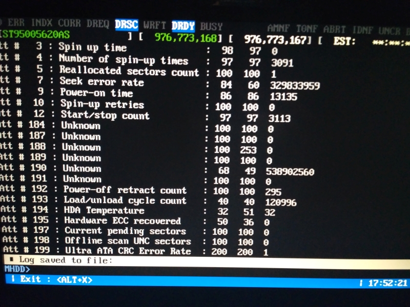

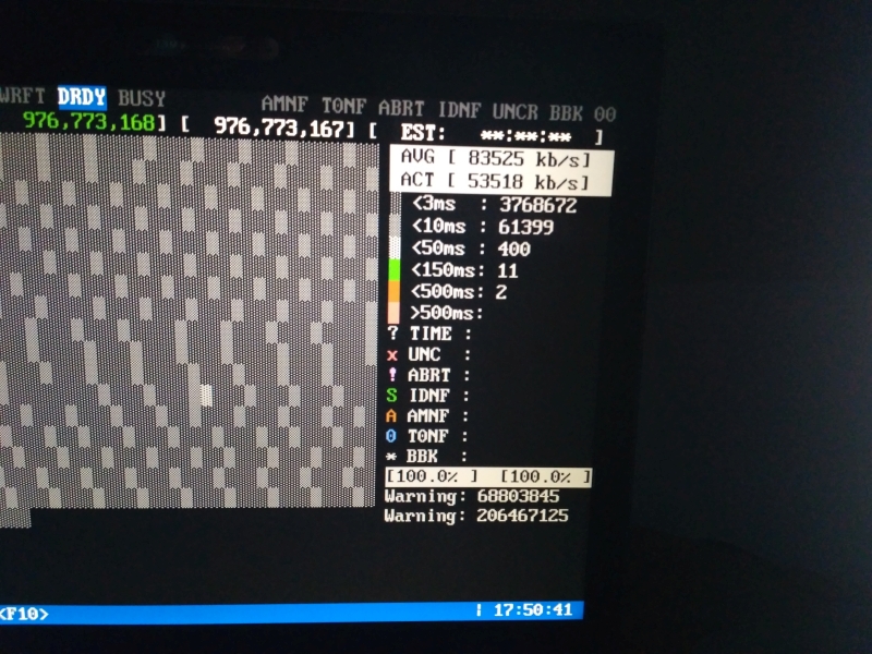

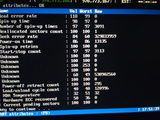

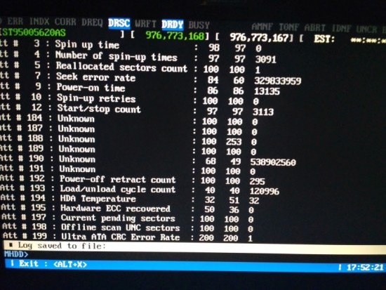

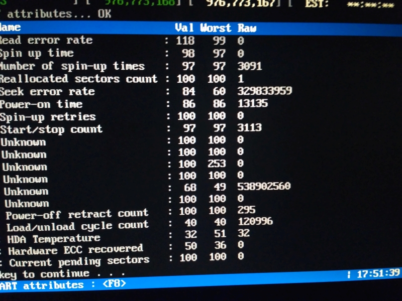

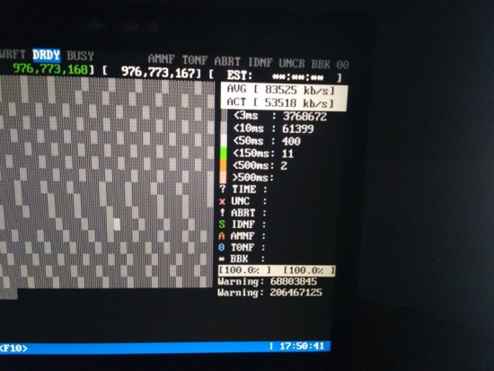

I have recently started to have strange system hang-ups. Please take a look at the results of a MHDD scan in the attached files.
Do I have to start thinking about buying a new disk?
I will be grateful for your insight. :-)

File comment: smart_result_2
File comment: smart_result_1
File comment: MHDD_scan_result

Any progress on this? I just now noticed 100 reallocated sector count; if memory serves me, that is bad news approaching. Have you any recent, current, backups?
 Post subject: Re: Problems_with_hdd
PostPosted: March 20th, 2017, 14:50
Posts: 17330
The reallocated sector count is 1.
The number of "slow" sectors is 2, according to the surface scan.
