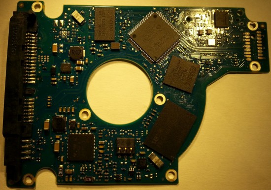

Hi everyone,
My Seagate SSHD - model Laptop Thin ST500LM000, f/w: DEM7 is death (not spin up).
I made the basic work and checked the simple elements of PCB (transil, resistors 0, cleaned contact strips, even resoldered the motor controller) - unfortunately - the drive still the same "dead".
Anyway - the same PCB somehow works - i can download the BIOS by the terminal in PC3K.
After reprogramming (or resoldered) the BIOS (by PC3K) drive remains a dead (if donor PCB has a different firmware). With the identical donor PCB (the same firmvare version) and reprogramming the BIOS disk spin up but with parameters (sn, etc.) from donor. Like identical after hot swap. Of course, can't read SA and user area......
It seems to me - that because it is hard SSHD - start the drive is very fast (before it gets started motor). To make this possible, some are some startup information must be included in ROM and NAND of the disk.
I my opinion, theoretically are there way to recovery data.
First: repaired PCB.
It may be difficult because the same PCM can be effective. If they are physical or logical errors in NAND this possibility will not be successful. Only, when any others element is damaged (fe. transistor). Further risk when resoldered critical element (bios, NAND, ASIC) to other PCB - these components can be damaged....
Second: Disable feature of SSHD.
Perhaps we can block all that SSHD (any bypass) and switch to work as a normal HDD.
In my opinion this way is the best. Question: If we can disable the NAND - how to do it ?
Third:
Replace critical startup information from own patient NAND of PCB to donor NAND of PCB.
Similar question: If we can - how to do it ?
Can someone please help ?
I thank You in advance for your help.

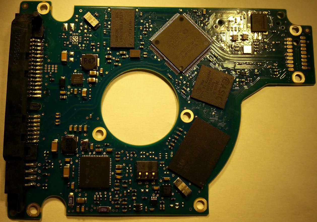

File comment: PCB photo of patient disk...

I would start by measuring the supply voltages:
viewtopic.php?f=1&t=27790
I can help you disable the supply to the NAND, if you wish to try this.
Your photo is too dark to be useful.

I enclose a brighter picture.
rgds.

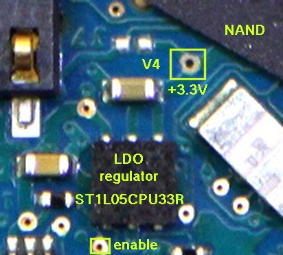

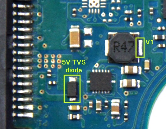

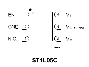

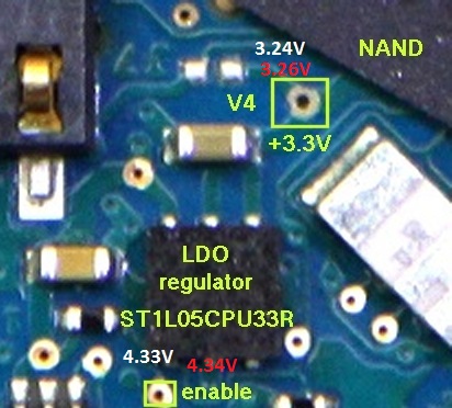

I have identified what I believe to be 4 supply voltages (V1 - V4).
V4 appears to be the +3.3V supply for the NAND IC. Pin #1 is an active high enable. The regulator can be disabled by pulling this pin low. Perhaps a 100 ohm resistor between this pin and ground would be the safest way to disable this supply, or you could remove the chip completely.

To: Fzabkar

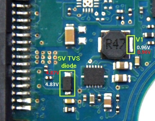

As you requested, I measured with a multimeter points that you described.
For comparison, here also the value for the smooth disk. They are very similar.
(white digits - data from a smooth drive, red digits - from the patient)
In accordance with your suggestion, i removed the chip LDO regulator (six pins).
Still nothing (do not spin up, BSY), but ........ the "small" difference ....
I received a message on the terminal - the following content:
ERROR: Flash Led 9C07 - Couldnt ID Flash Device
