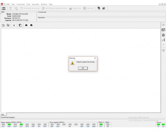

I have toshiba 500 GB sata hdd which detecting to fail the family....and showing correct information of the hdd in toshiba utility.

That's because it's Hitachi "ARM" technology. Try that utility.

HGST ARM family DLE630

Already answered in another post (+ responded to your PM) 7210DLE6 in ARM Utility
