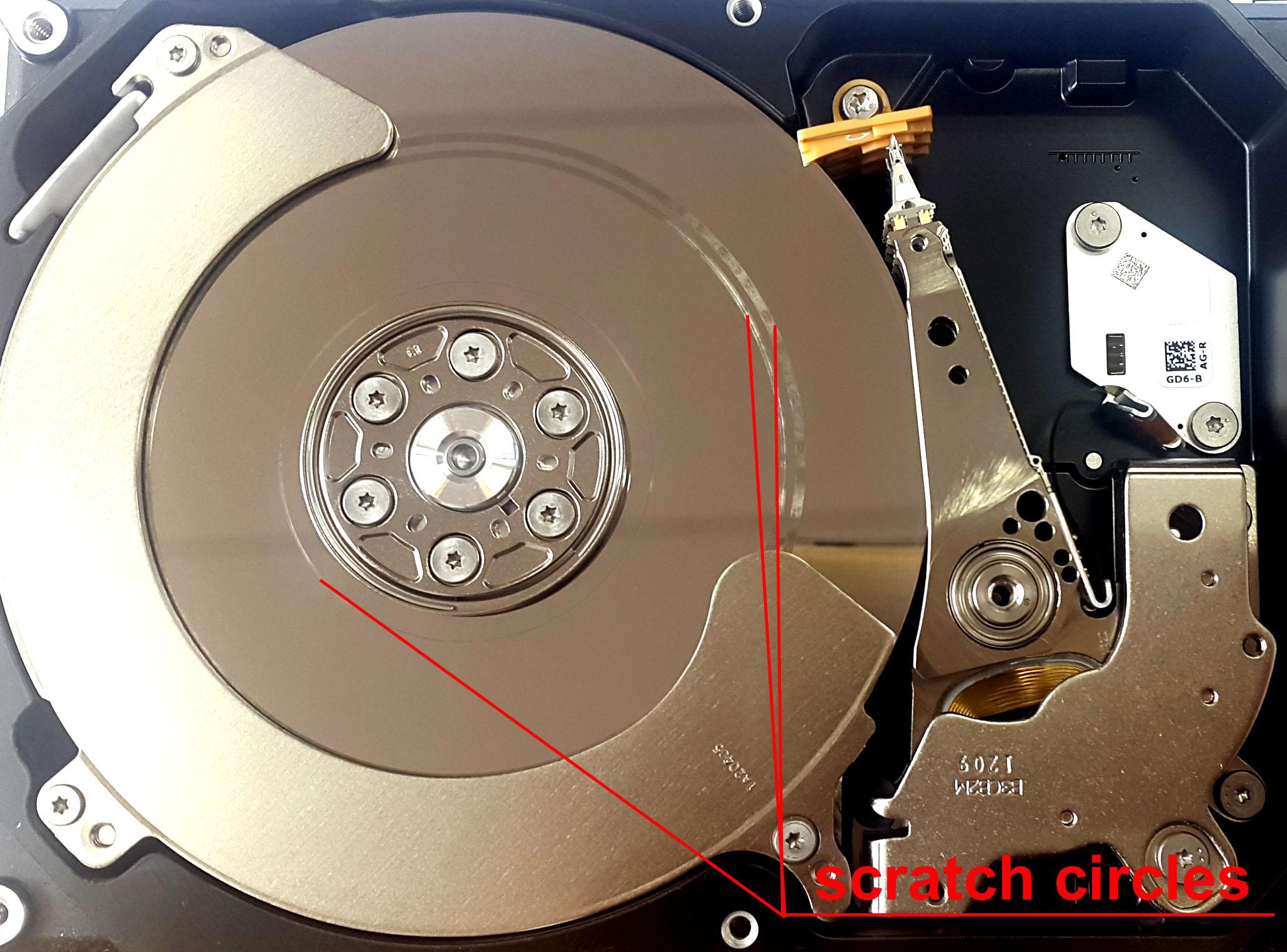

I would like some opinion if any data can be retrieved from this Hard Disk, a raw image will be fine.
Unfortunately I have the terrible Seagate 3TB hard disk that died on me.
Here is an image of the scratched platter (this was taken by a local DR in a clean room).

The famous "D"a"M"n series :evil: :twisted:
 Post subject: Re: Scratched Platter Seagate 3TB
PostPosted: March 27th, 2017, 10:34
Posts: 219
If other surfaces are the same, it is not possible to recover. In otherwise, there is a good chance to get partial result.

You should be fully aware of type of recovery result you're going to get before you agree to pay such a fee. Anything larger than a few Mb in size is already hopelessly lost. So you can forget about getting back things like videos. In all likelihood you're going to get back just a mix match of smaller files which may or may not even contain anything you want recovered.
When I see drives like this come into my lab, I don't even offer a recovery quote because the customer is never happy with the final result. You need to be aware that you're gambling a lot of money on what's most likely a lost cause.
That's a very helpful comment. I do have some videos inside but I don't care about any of them.
What I am probably looking for will only just be pictures. (Standard JPG or GIF files). The pictures might be larger than a few Mb though considering the large size camera take pictures nowadays but I will settle for smaller export versions which I probably have saved or thumbnails.
