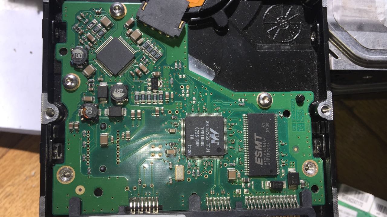

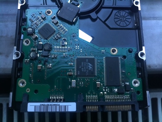

Selam Everbody..!
i have Samsung HD250HJ that' not spin.
5v TVS diode was burnt.
removing or changing doesn't help me.
i bought a same disk that has same pcb number.
but it's useless too. disk spins but can't visible .
unfortunately there is no rom chip on the Pcb.
is it Pcb or disk problem?
why the pcb swap is useless at old model Samsung disk?
is the rom data in main chip ?

try to adopt pcb instead of straight swapping.
hotswap+adopt

start donor drive:
> check and read all modules
> send standby command
> switch pcb to patient drive
> recalibrate
> verify heads are fine !
> write two overlay modules from donor drive backup
good luck
Data Recovery Pakistan
 Post subject: Re: Samsung HD250HJ PCB Compatibility
PostPosted: March 28th, 2017, 7:01
Posts: 3551
This method works, but it can be quite dangerous if the OVLYs are not compatible, you can end up with a bricked drive.
I would start by placing a donor pcb and checking the terminal output...
PostPosted: March 31st, 2017, 15:54
Posts: 17323

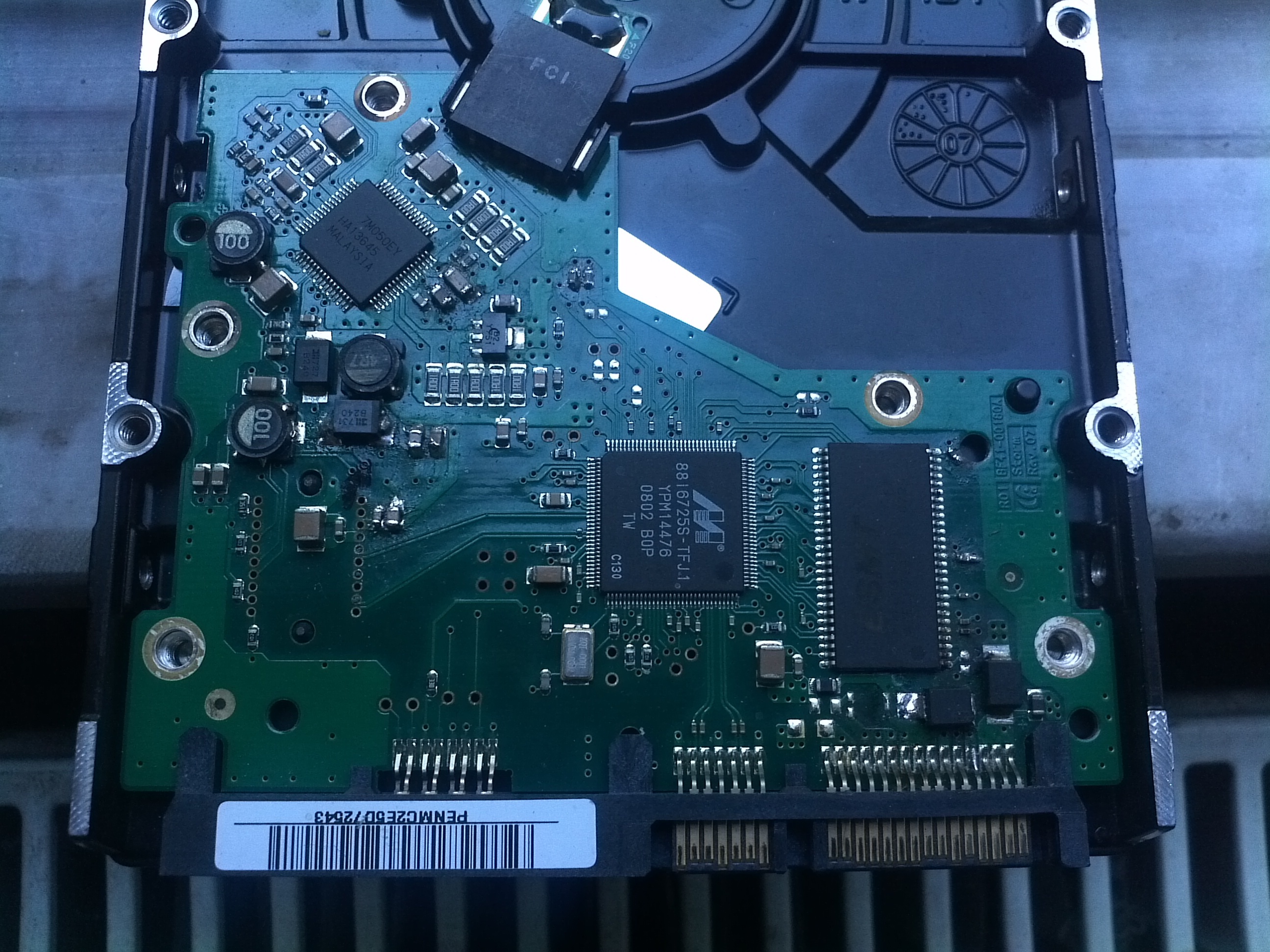

There are two B240 diodes in this photo:
http://thumbs.picclick.com/00/s/MTIwMFgxNjAw/z/6XgAAOSwxg5X0mbh/$/250-GB-Samsung-HD250HJ-PN-340421IPA64082-TRIDENT3-_57.jpg
The vertical one appears top be associated with the negative supply for the preamp. The horizontal one looks like it might be part of a boost converter.
If you can supply a photo of your own, I might be able to identify the voltage test points.

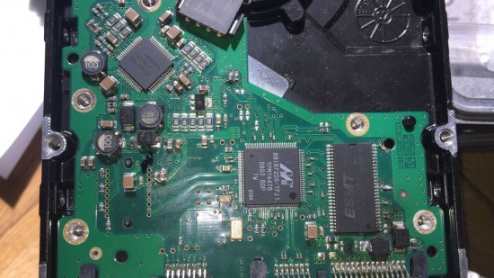

Location: istanbul

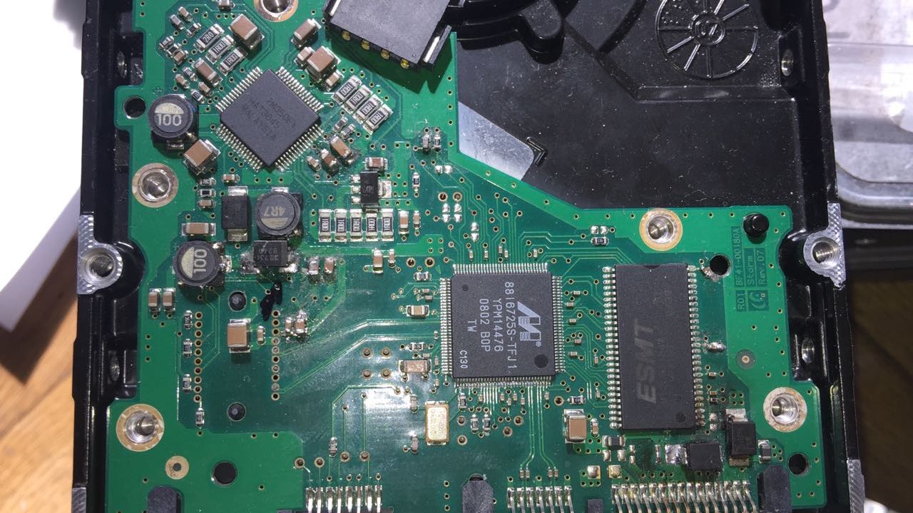

in that case this is boost converter.
horizontal one.
Native pcb looks like battlefield. but functional. i tested components that i solder.
Only Main (marvell) chip heating up a little. Other's always cold
and thank you for help.
i'm sorry that i had to upload the original pic at first message.
I've never worked so hard for a pcb before. this is strange fault for me.
It only took 2 days to find the donor pcb.
PostPosted: April 2nd, 2017, 13:20
That PCB looks pretty crusty, I'd say you should forget about repairing it. It's also not one that requires any adaptation as far as I remember. You just need to match the model and firmware version of the drive to find a compatible replacement.

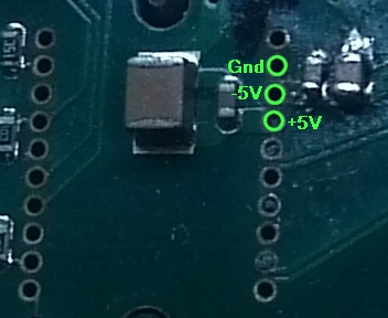

Measure the resistance between the Gnd pin and each of the +5V and -5V pins at the HDA connector. This will tell us if either of the supply rails is shorted to ground. Do this in the absence of power, and with the PCB on and off the drive.
BTW, I'm not sure whether the diode is part of a boost converter or some other topology. Your photo is too poor for me to work with.

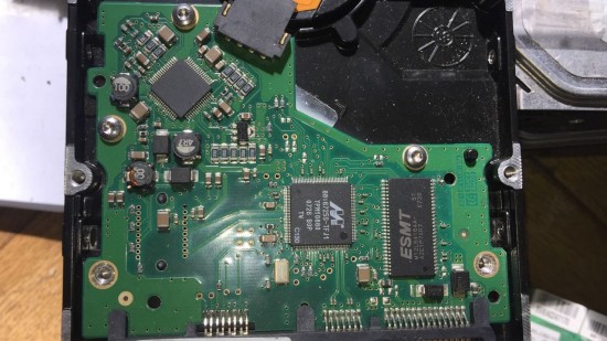

Posts: 210
Location: istanbul
Looks like pcb have a +5V and -5v problem it's related about head connector or Preamp.
5V TVS diode had already burned.
broken pcb never work with health disk.
after the measurement i plug the power to health pcb+patient disk.
last week it spun.
but this time weird sounds came out. chattty ! chatty !
i think that head was squeezed.
and now no spin.
thankfully donor board is O.K. at least.
PostPosted: April 4th, 2017, 16:14
Posts: 17323
It appears that your patient's preamp has a short between ground and the -5V supply, ie it is dead. :-(
I don't understand why the last set of readings shows a short to ground at +5V ... unless the problem has spread. :?
PostPosted: April 5th, 2017, 15:58
Posts: 210
Location: istanbul
i'm sorry that the last +5v is 1,5 k Ohm
and thank you very much for your help..
