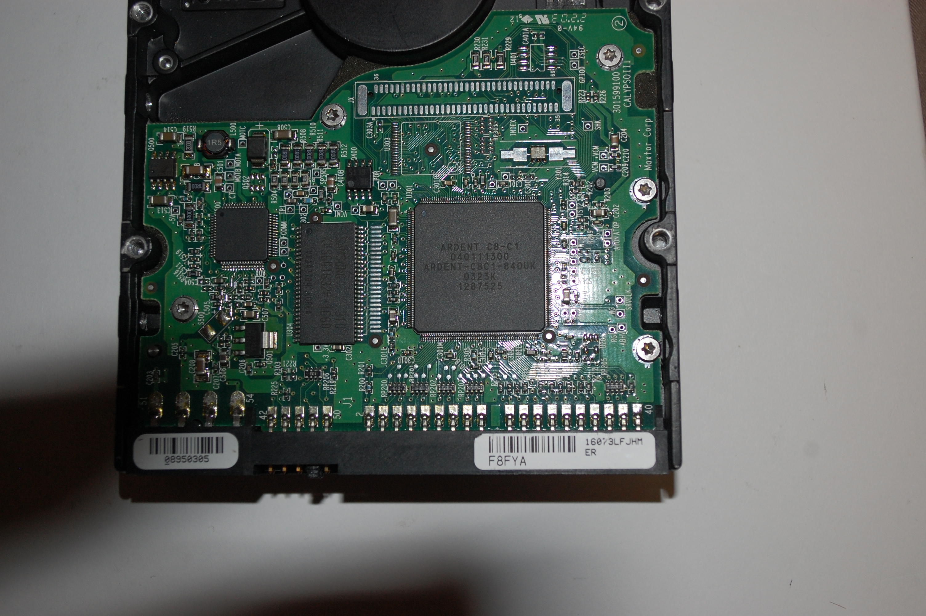

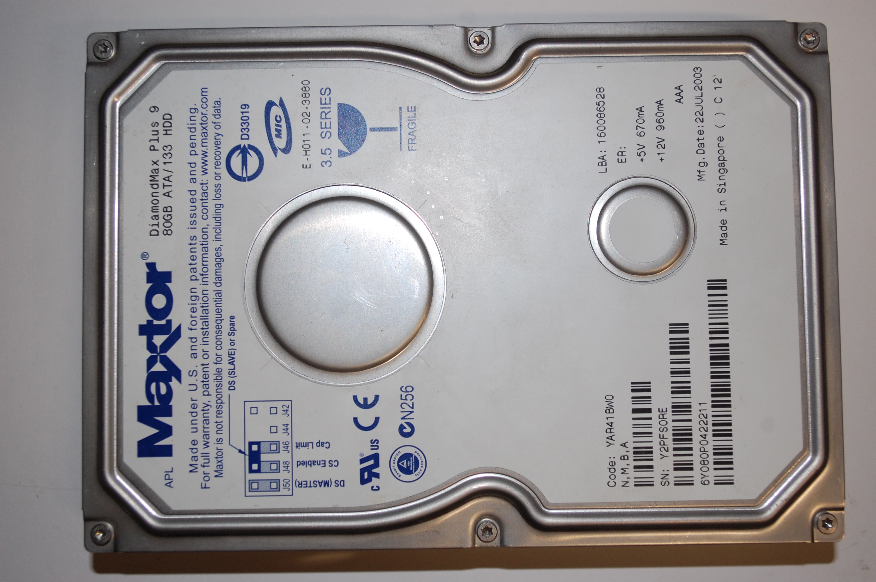

 Post subject: Maxtor DiamondMax Plus 9 80GB PCB Replacement
PostPosted: April 1st, 2017, 16:47
Joined: April 1st, 2017, 16:30
Location: Eastern WA
New here so sorry if I do something wrong, but I'm looking on information to get a PCB for my DiamondMax Plus 9. I searched this on eBay, but I was unsure if any of these would work for a replacement. I've posted a couple pictures of the drive. Any help would be greatly appreciated. Thank you!
In case anyone is wondering, the drive don't spin and the IC for driving the spindle gets incredibly hot, so I figure I probably fried the chip somehow.

 Post subject: Re: Maxtor DiamondMax Plus 9 80GB PCB Replacement
PostPosted: April 1st, 2017, 21:07
Posts: 16955
Does the chip still get hot when the PCB is off the drive?
PostPosted: April 1st, 2017, 21:32
It does.
PostPosted: April 1st, 2017, 21:39
Posts: 16955
I believe this means that the chip is dead. You might like to measure the resistances between each pair of motor terminals (at the motor). The resistance between the common terminal and each of the 3 phases should be half the phase-to-phase resistance. Expect to see values in the low ohms range.
PostPosted: April 2nd, 2017, 9:33
Joined: June 8th, 2006, 19:44
Posts: 3144
Location: Atlanta, GA
It's a common failure.
Easiest to replace the PCB. Match the sticker near the power connector.

PCB layout - Maxtor DiamondMax Plus 9 ATA/133:
http://www.hddoracle.com/viewtopic.php?f=112&t=117
Here are various oscillograms by "NazYura":
http://nazyura.hardw.net/000004.htm
Servo Frame:
http://nazyura.hardw.net/ServMark.jpg
Motor Good:
http://nazyura.hardw.net/MotGood.jpg
Motor Bad:
http://nazyura.hardw.net/MotoBad.jpg
VCM:
http://nazyura.hardw.net/VCMSound.jpg
VCM Sound:
http://nazyura.hardw.net/VCMSound.wav
NazYura's work would suggest that the motor is a possible cause of failure.
