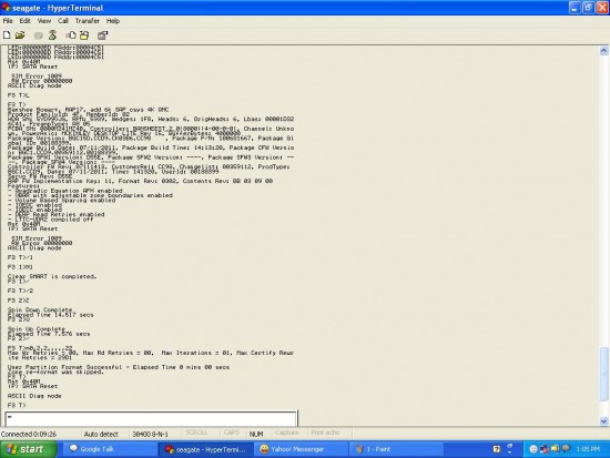

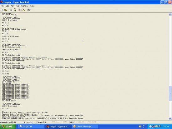

DRIVE nOT DETECTED IN BIOS
I did like this
Rst 0x40M
(P) SATA Reset
SIM Error 1009
RW Error 00000080
ASCII Diag mode
F3 T>/2
F3 2>U
Spin Up Complete
Elapsed Time 0.000 msecs
F3 2>/
F3 T>Z
Invalid Diag Cmd
F3 T>/2
F3 2>Z
Spin Down Complete
Elapsed Time 14.518 secs
F3 2>m0,2,2,,,,,22
Invalid Diag Cmd
F3 2>/
F3 T>m0,2,2,,,,,22
DiagError 0000500E Process Defect List Error
R/W Sense 00000002, R/W Error 841C0087, List Offset 00000000, List Index 0000007
8, File Error 000000D0
F3 T>m0,2,2,,,,,22
F3 T>/1
F3 1>N1
SIM Error 1002
RW Error 84150182
SIM Error 1002
RW Error 84150182
Init SMART Fail
Rst 0x40M
LED:000000BD FAddr:00004C51
Here I power off drive
and reconnected power
Rst 0x40M
(P) SATA Reset
SIM Error 1009
RW Error 00000080
ASCII Diag mode
F3 T>L
F3 T>
Banshee Bogart, RAP17, add 6k SAP csys 4K QNC
Product FamilyId: 4F, MemberId: 02
HDA SN: 5YD99VJG, RPM: 5939, Wedges: 1F8, Heads: 6, OrigHeads: 6, Lbas: 00001D32
6C41, PreampType: A8 05
PCBA SN: 0000M241MZ4B, Controller: BANSHEEST_2_0(8000)(4-00-0-0), Channel: Unkno
wn, PowerAsic: MCKINLEY DESKTOP LITE Rev 15, BufferBytes: 4000000
Package Version: BGC15D.CCD9.CK03B6.CC98 , Package P/N: 100681667, Package Gl
obal ID: 00188399,
Package Build Date: 07/11/2011, Package Build Time: 14:13:20, Package CFW Versio
n: BGC1.CCD9.00359112.00188399,
Package SFW1 Version: D55E, Package SFW2 Version: ----, Package SFW3 Version: --
--, Package SFW4 Version: ----
Controller FW Rev: 07111413, CustomerRel: CC98, Changelist: 00359112, ProdType:
BGC1.CCD9, Date: 07/11/2011, Time: 141320, UserId: 00188399
Servo FW Rev: D55E
RAP FW Implementation Key: 11, Format Rev: 0302, Contents Rev: BB 03 09 00
Features:
- Quadradic Equation AFH enabled
- VBAR with adjustable zone boundaries enabled
- Volume Based Sparing enabled
- IOEDC enabled
- IOECC enabled
- DERP Read Retries enabled
- LTTC-UDR2 compiled off
Rst 0x40M
(P) SATA Reset
SIM Error 1009
RW Error 00000080
ASCII Diag mode
F3 T>/1
F3 1>N1
Clear SMART is completed.
F3 1>/
F3 T>/2
F3 2>Z
Spin Down Complete
Elapsed Time 14.517 secs
F3 2>U
Spin Up Complete
Elapsed Time 7.576 secs
F3 2>/
F3 T>m0,2,2,,,,,22
Max Wr Retries = 00, Max Rd Retries = 00, Max Iterations = 01, Max Certify Rewr
ite Retries = 29D1
User Partition Format Successful - Elapsed Time 0 mins 00 secs
Zone re-format was skipped.
F3 T>
Rst 0x40M
(P) SATA Reset
ASCII Diag mode
F3 T>
I connected drive to system
Not detected
I kept idle for 10 mts
then again connected to system
Now the drive working ok
"DiagError 0000500E Process Defect List Error
8, File Error 000000D0"
This error caused by SMART?
 Post subject: Re: seagate2tb
PostPosted: April 18th, 2017, 4:30
Posts: 17323
0x841C0087 - Unable to recover the Primary Defect files
0x84150182 - Spindle failed error

Prasad ,
Primary Defect List Has Bad Sector Or Has Bad Enteries

yes u said right sir
Thank you i read about it in some articals
The client drive is ok and got full data 2tb
