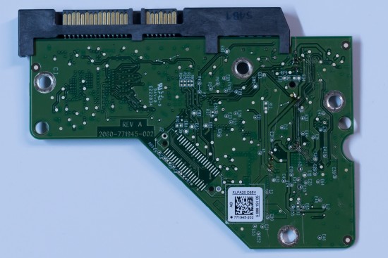

Hello
I have disk WD20PURX with damaged PCB. So PCB was cut with something sharp and many tracks are damaged. Number PCB is 2060 771945-002 rev A.Because at the moment I don't have the same PCB is it possible using another PCB? Could help me what PCB I can use? I attached some photos disk and PCB.
thanks

Easy! Just get PCB with same P/N and switch U12 chip.

Yes, but I don't have another PCB 2060 771945-002 rev A!

771945 is really a very common PCB, its been used on a wide variety of drives

yep, in WD Red for example..
some good ones at Ebay: http://www.ebay.com/sch/i.html?_from=R4 ... 02&_sop=15
